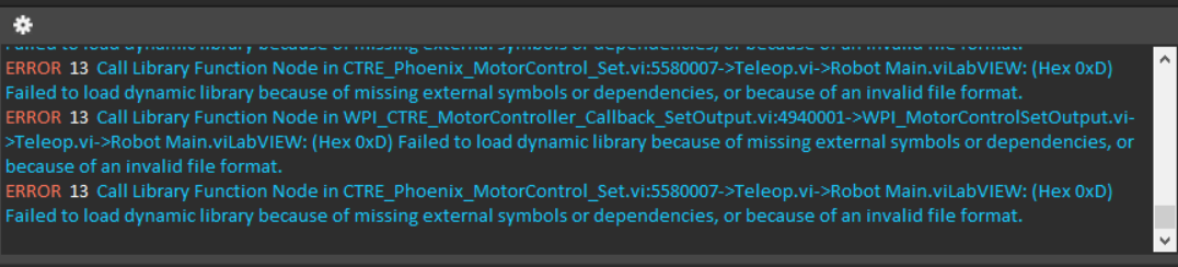

Hi, my team and I have been trying to move a couple motors using talon srx motor controllers without success. We have installed everything (including the phoenix tuner and ctre labVIEW libraries) and get the following error on the driver station:
(I would post our code but chief delphi wont let me post more than one picture (I’m a new user))
Has anyone else run into this problem? We’ve been at it the whole day and nothing seems to work

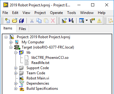

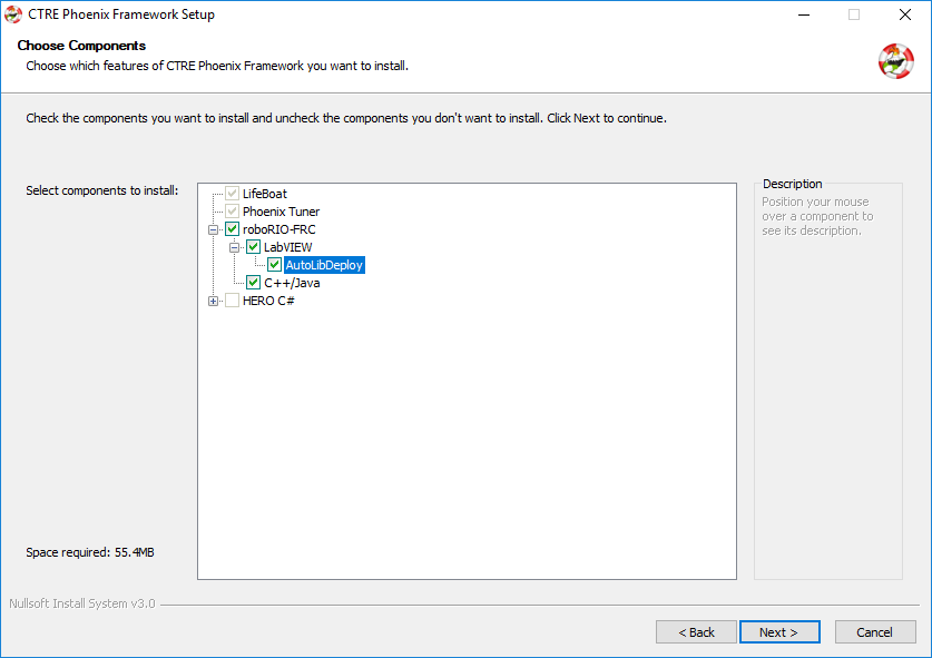

#8
Make sure you have checked the AutoLibDeploy when installing LabVIEW.
When using this option, the library should appear in the Project’s lib auto-populating folder.
2019-01-10%2020_28_25-EnWin10Pro64v1607%20-%20VMware%20Workstation%2014%20Player%20(Non-commercial%20use%20only)
#9
That’s not the root-cause. Otherwise they would get a different error (“Did you forgot to Tuner”).
Read the actual DS message.
But any other circumstance, you would be right.
#10
Yep this was it, after that we just reinstalled the libraries on the roboRIO using the tuner and everything worked!
