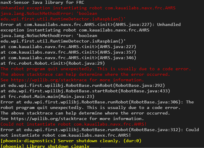

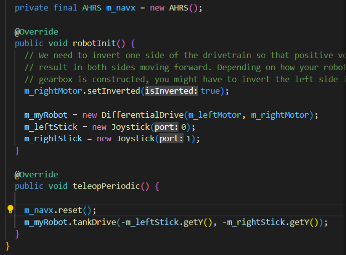

I just updated my software installations today. I was surprised to find a bug while instantiating a simple Navx Objet (see attached screenshots)
I will appreciate any help, please.

Has the navx library been updated for 2023 yet? Last I heard (a couple hours ago) it hadn’t. If not, that’s almost 100% certain to be your problem. Not a bug, just an unsupported version.
Ninjedit: Doesn’t look like it. Latest comment here was 1/2022. RoboRIO Libraries | navX-MXP
We are having the same issue currently while trying to implement field orientation on our new drive base. The gen2 repo is private due to some bad actors attempting to steal designs or something like that if you want access to the gen2 repo you have to sign an NDA. Just a waiting game at this point, unfortunately.

This should be the official Navx2 library compatible with 2023. Add it as an online vendor library: https://dev.studica.com/releases/2023/NavX.json
