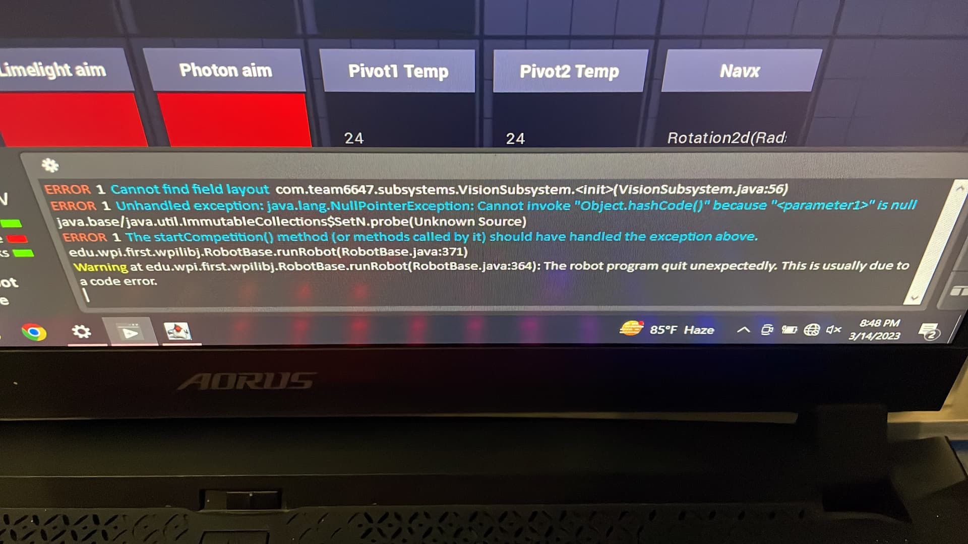

Unhandled expcetion: Cannot invoke "Object.hashcode()" because <parameter1> is null
Hello, today while testing autonomous I found a breaking issue. The error is the following:
Ignore the “Cannot find layout” error.
Regarding the error, I was testing some sendablechoosers to help with our autonomous. We are using two: one for the actual path, and another one for the position the pieces will be placed in. These can be found in the autonomousPaths.java, and the choosers can be found in the AutoModeSelector.java & GridPlacementSelector.java
Here is the repo for the repository: https://github.com/VOLTEC6647/Voltec-2023/commits/Error-Testing
I would greatly appreciate any help, as the robot goes tomorrow for a regional, and it doesn’t move because of this .
Thanks
The ERROR message doesn’t really give enough information. The full console log will show the stack trace of how it got there. If you’ve closed the DS so you can’t pop up the console window anymore, it should also be in the DS log file.
I have a guess at what’s happening: your getAutoMode() function calls autoChooser.getSelected() and then switches on the result. That function can return null if the selected key exists, but none of the values in the map match. The switch statement can’t handle this case, as it’s expecting an enum value. If this is the issue, you can fix it by adding a null check before entering the switch.
Okay, Im going to try that. My question is, if there are a defined number of options in the enum, then why doesnt the map match?
The map lookup in getSelected() is from the string (in NT) to the option value. The string could be anything (since it’s coming from NT, it’s not restricted to the set of options); it returns null if the string isn’t in the map.
