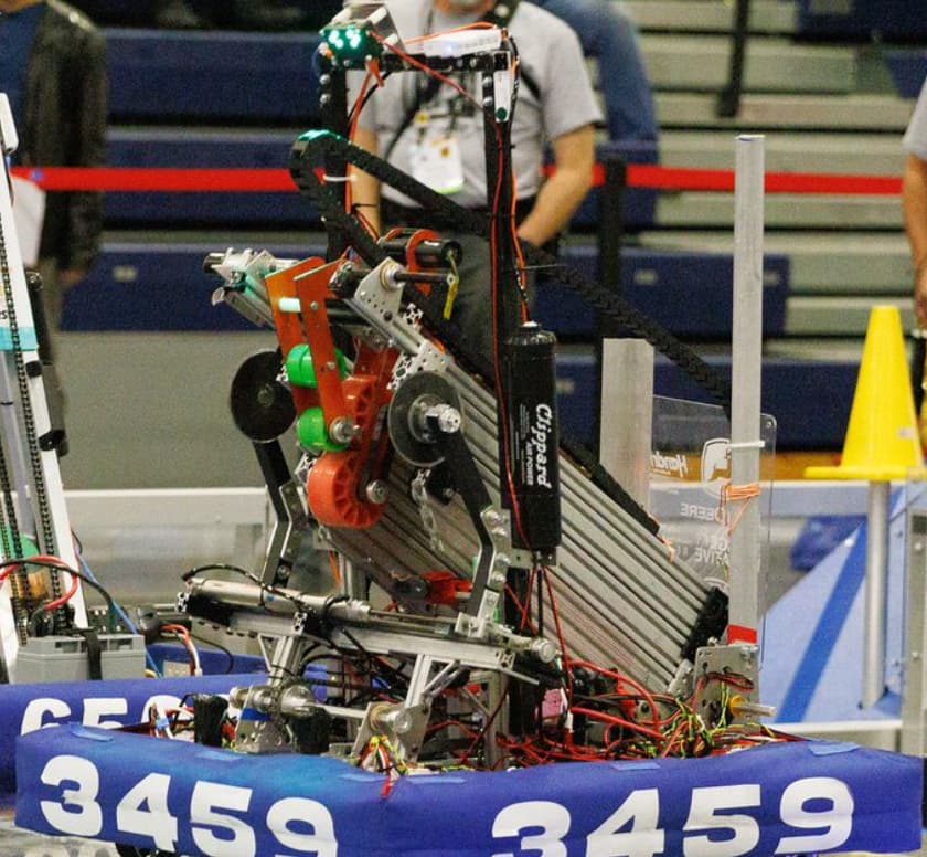

Team 3459 in North Carolina built a passive ground intake that handed off to an over the top grabber. It didn’t work great from what I saw, but it stood out from all the other grabbers I’ve seen.

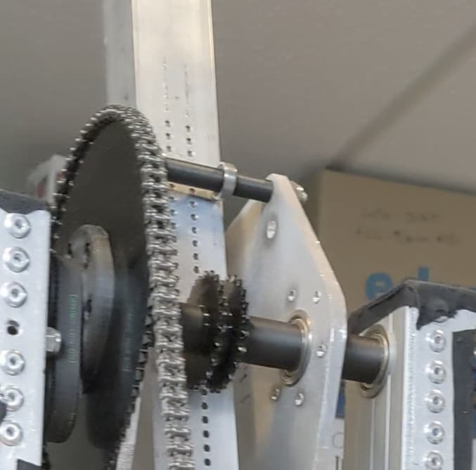

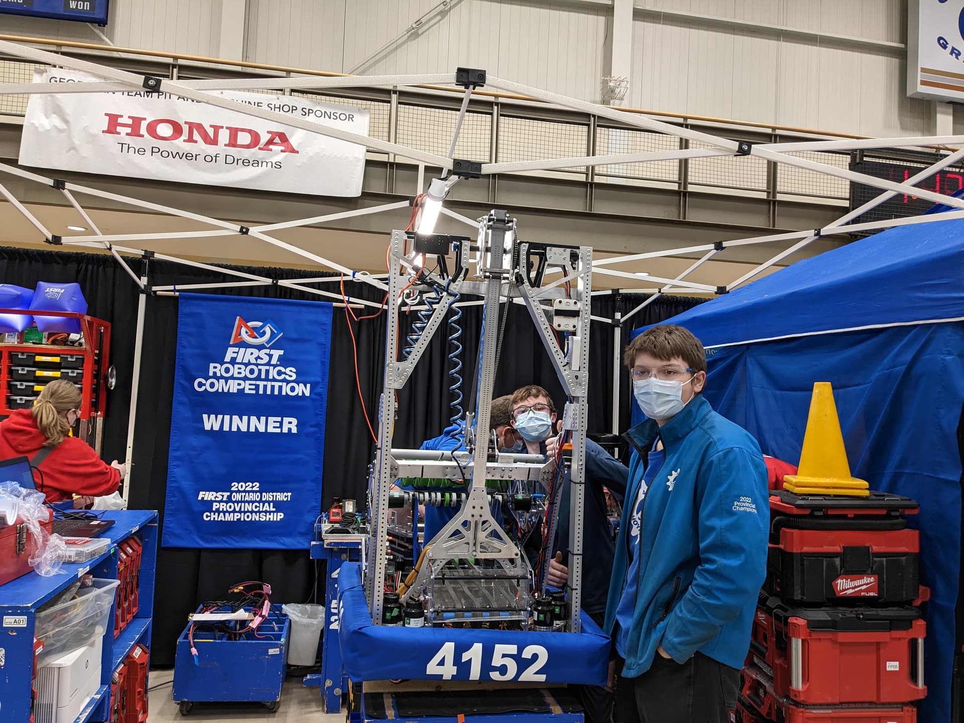

We won the creativity award at Georgian College for our stinger. Instead of rack and pinion we drilled holes and use a sprocket. Works very smoothly.
3468 did this as well.
I don’t recall who, but someone at Magnolia had a rack and pinion using a sprocket for a pinion and for a rack, they managed to slide some 25 chain down into the groove of a 90-20 style extrusion. I could see at a glance that it had to go up and down because of the cable runs to allow for it, but it took me a few seconds to find the actual engagement.
I"ve definitely seen more R&P type systems (some using belt secured to a piece of extrusion with a sheave as well as those above and traditional gearing) this year than I ever have before.
