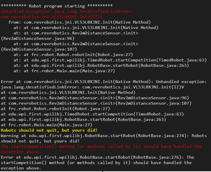

Hi all, my team has just moved up from FTC this year and is trying to use our old REV 2 meter distance sensors on the i2c ports on the roboRio. Thing is, when ever the program is deployed with the reference to the port on the board (distOnboard = new Rev2mDistanceSensor(Port.kOnboard0; ) we get an unsatisfied link error.
This is my first time seeing this error and I am not quite sure how to deal with it. Any help would be appreciated.

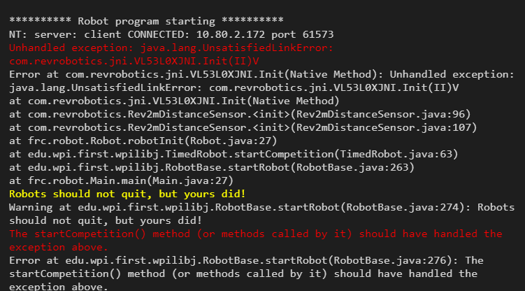

Thanks for the response! Now this just got super weird, after re-adding the library based off of the installation specified on the Rev github the actual rev example code managed to deploy to the robot and give us correct values but after trying to add in the same code to our own robot class, the error continued to persist. After this testing happened we went back to the rev example code and the error was back! I ssh-ed into the Rio and the libDistanceSensorDriver.so is there. So I’m not exactly sure what is causing the issue now.
here is a picture of the most recent error:
I ran into a similar issue with the libDistanceSensorDriver.so not getting deployed to the RIO. I found the file did exist in the maven folder after I merged the SDK contents like the instructions said. What I found was in looking at the related Rev2mDistanceSensor.json file in the VendorDeps folder, there was a setting that I was suspicious of. In the cppDependencies section, the setting “SharedLibrary” was set to true. I changed it to false, saved and redeployed the code to the RIO. Now I have functioning robot code.
