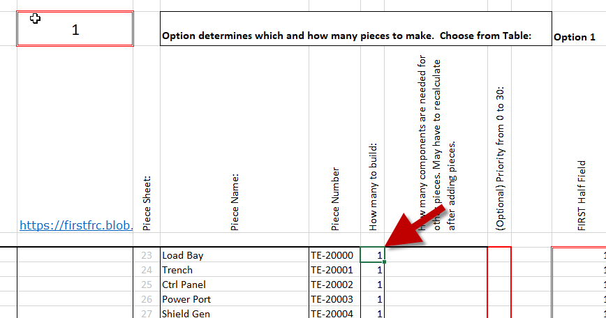

Question: If we plan to build some, but not all pieces (make mot build the load station immediately), is there a way to edit the planning page to reflect that?
Absolutely. Change the numbers under an “option” a little to the right, then choose that option.
(Overall, red-bordered boxes can be changed.)
