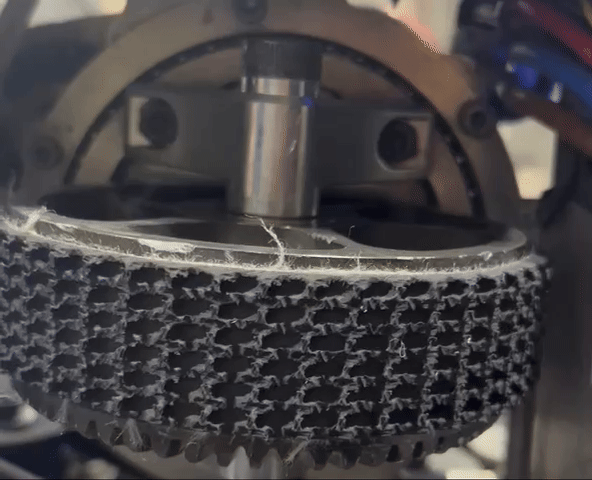

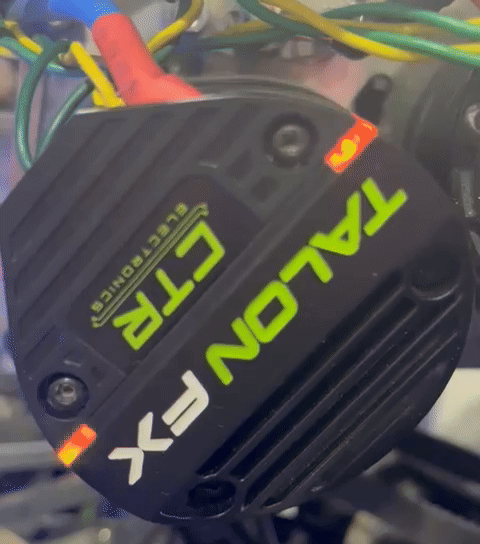

As can be seen and heard in the videos below, when blinking the motor through the Phoenix Tuner X the motor makes an atypical sound and moves although it isn’t supposed to.
VID-20240216-WA0012-ezgif.com-video-to-gif-converter
VID-20240216-WA0011-ezgif.com-video-to-gif-converter
(Both sides of the motor at the same time)

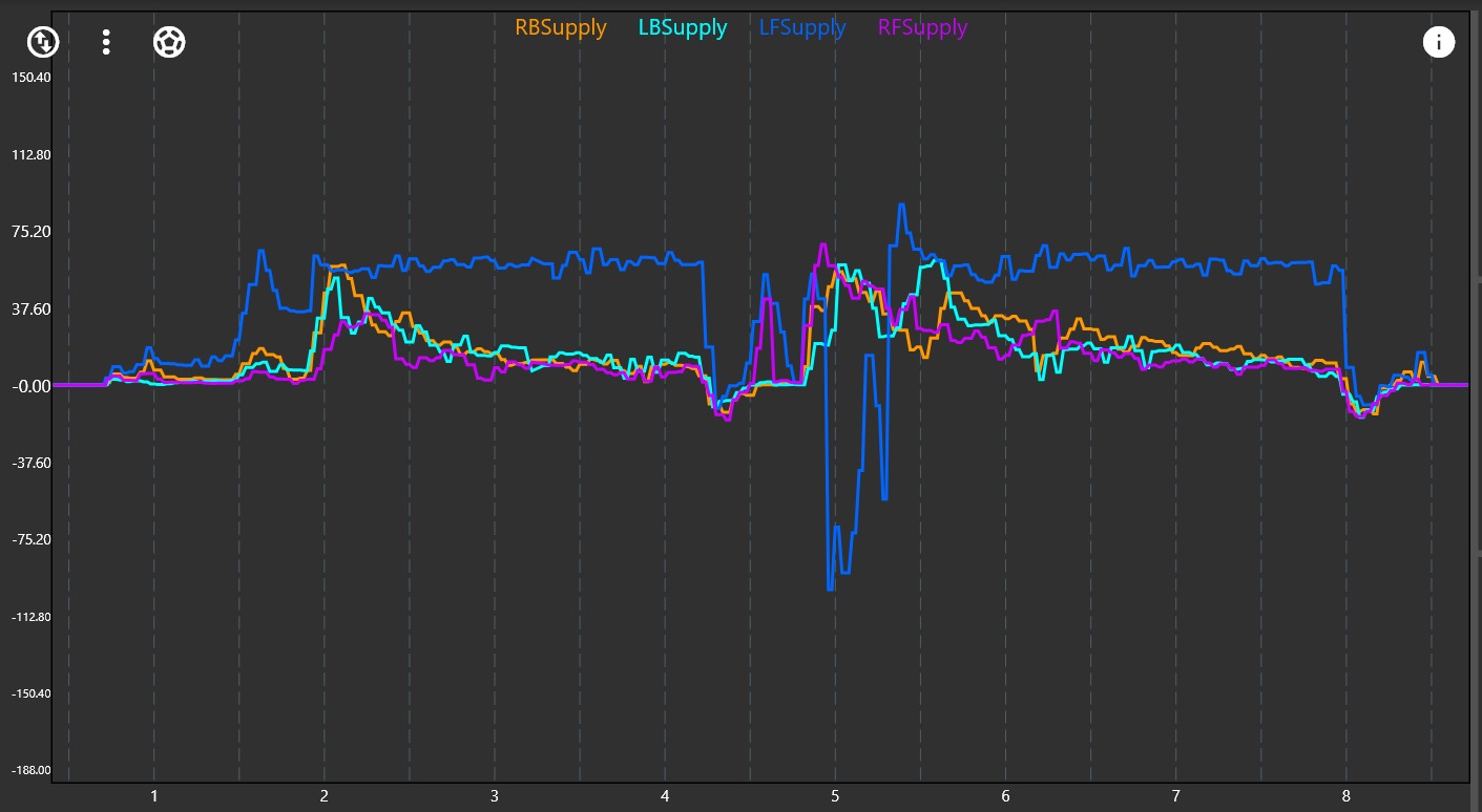

In this graph you can see the reported supply current difference between the faulted Kraken (the darker blue) and the rest of the drive Krakens on our swerve, without using FOC:
​Even during short test drives, the faulty motor consistently ran significantly hotter than the others.
This issue is unprecedented for us, and we are concerned about its frequency and magnitude. The sole modification made to the control system was the upgrade to Phoenix 6 (and Phoenix 6 Pro).
Despite attempts to address the problem, such as running the Krakens with and without FOC, the outcome remains unchanged.
