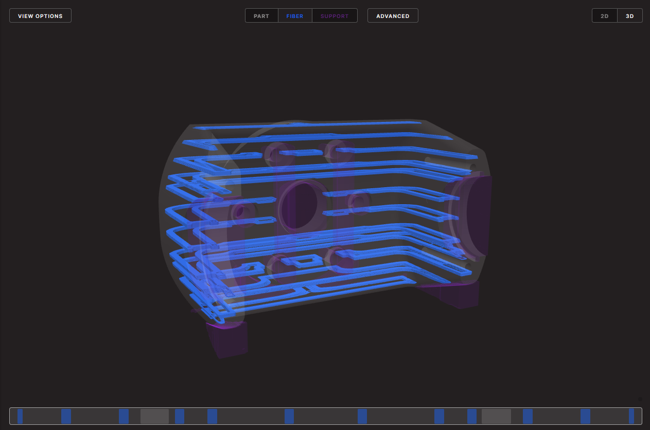

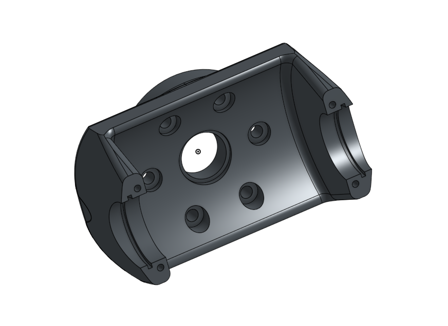

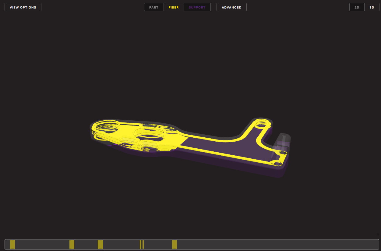

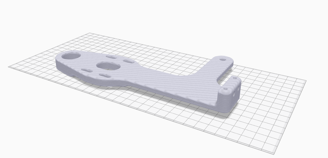

Swerve Saddle
These hold the wheels and are quite abused. Carbon fiber (verses Kevlar) to stiffen them. Flexing causes changes in the bevel gear backlash. These are super stiff!
Work around: Make it out of Aluminum.

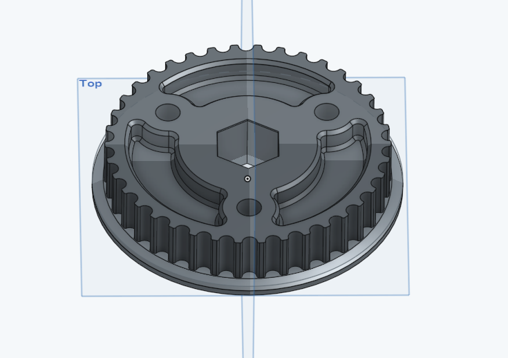

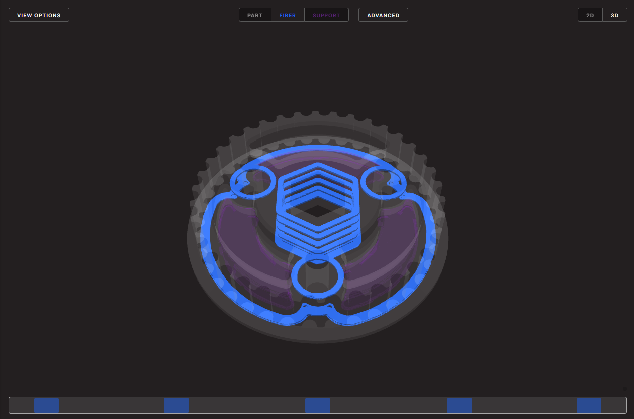

Azimuth drive pulley
This pulley sees shock loads from the wheels hitting any bump on the field. The hex shaft tries to spin in the hub. The fiber increases hoop strength.
Work around: Add an insert from Thrifty Bot or a small metal 20DP gear.

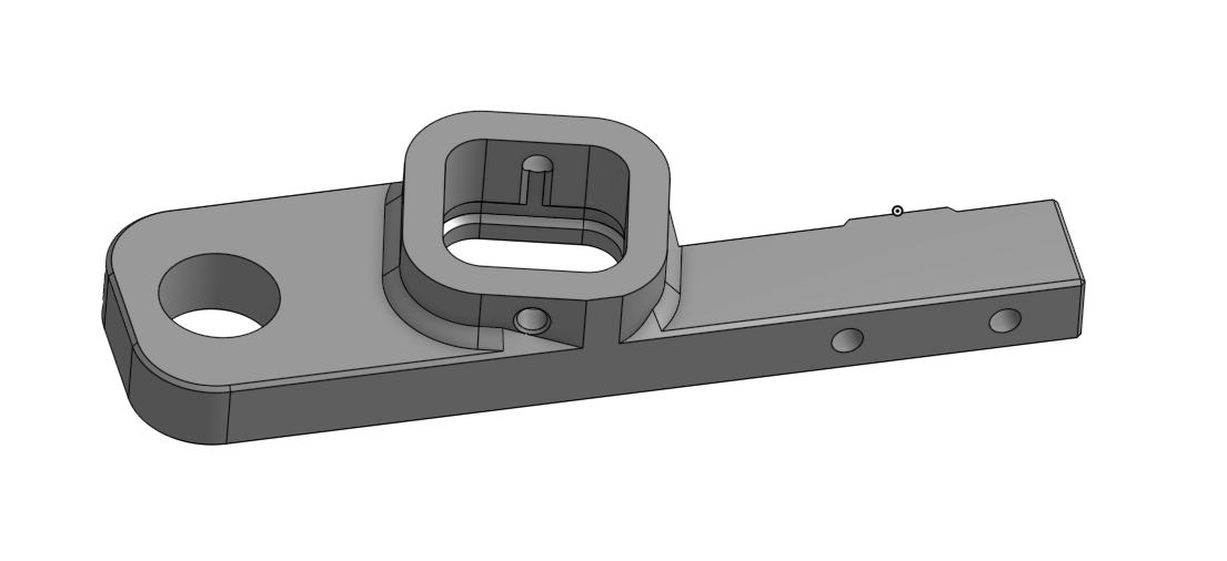

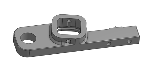

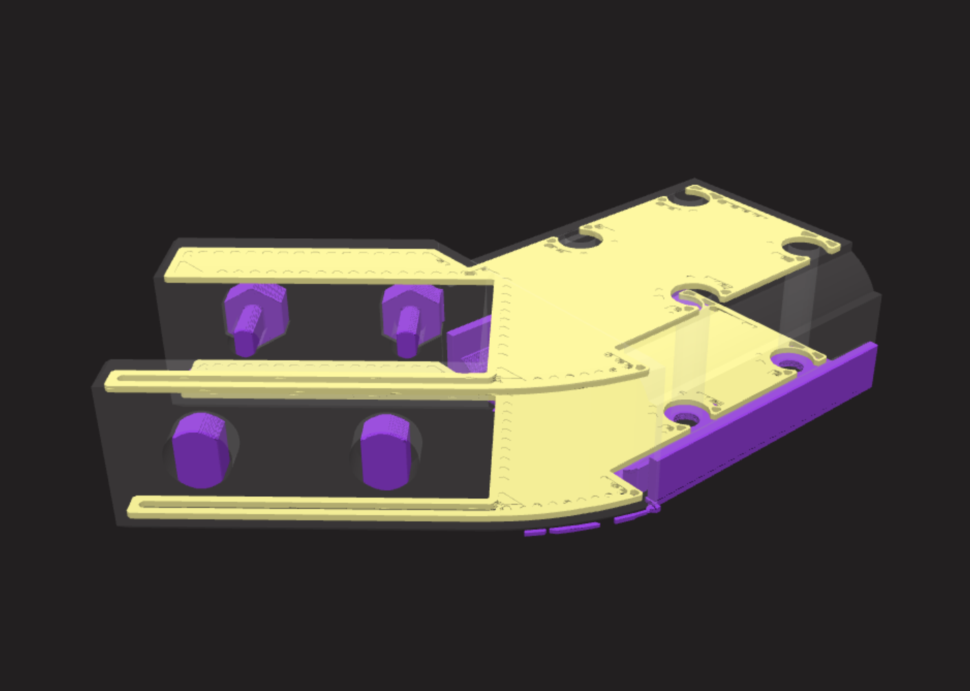

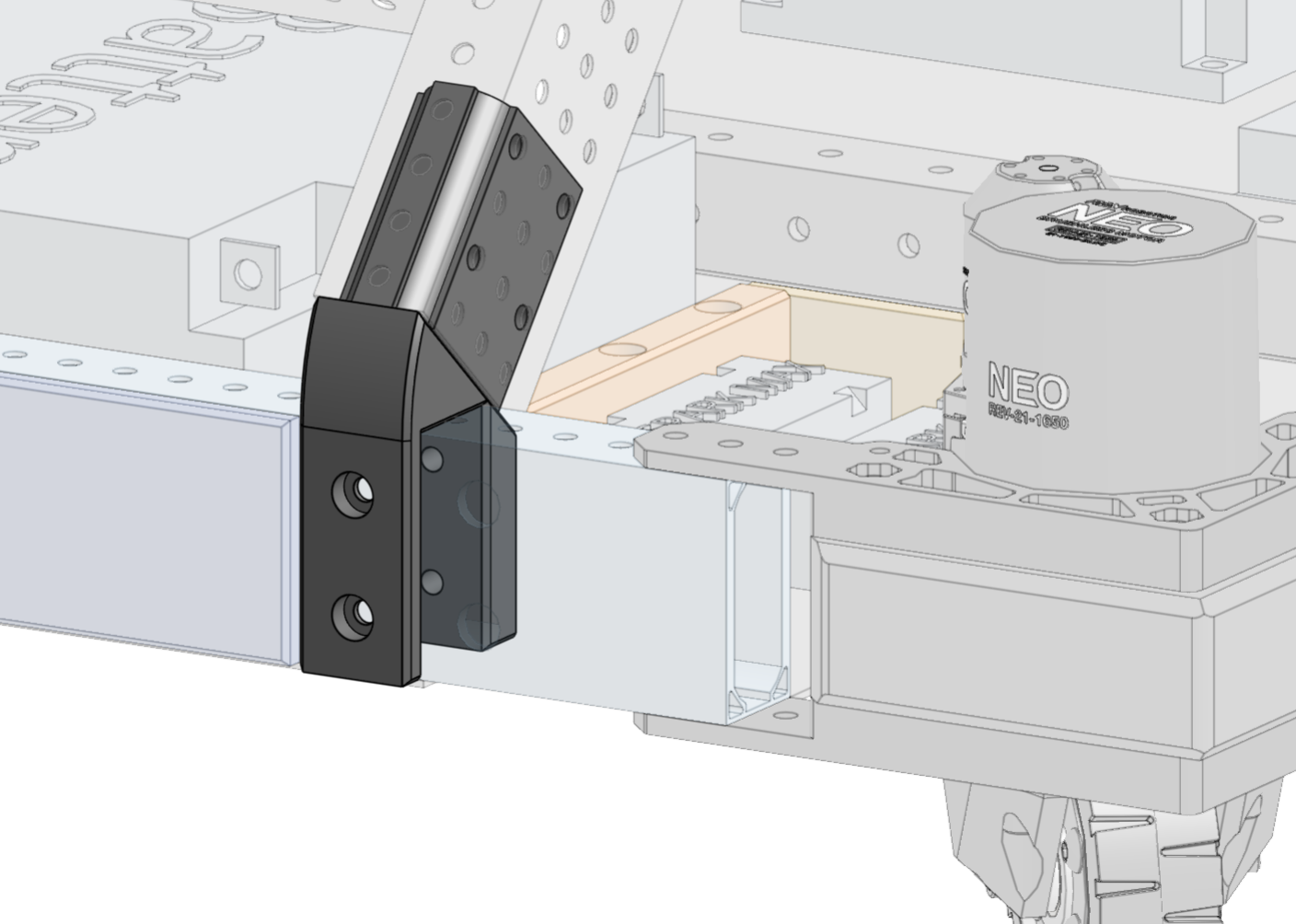

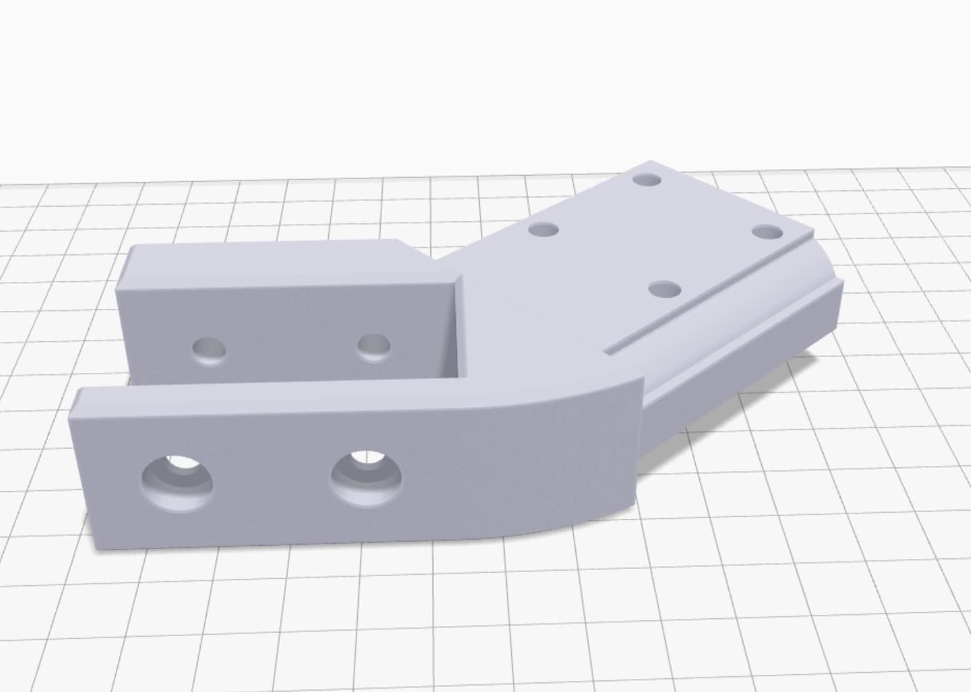

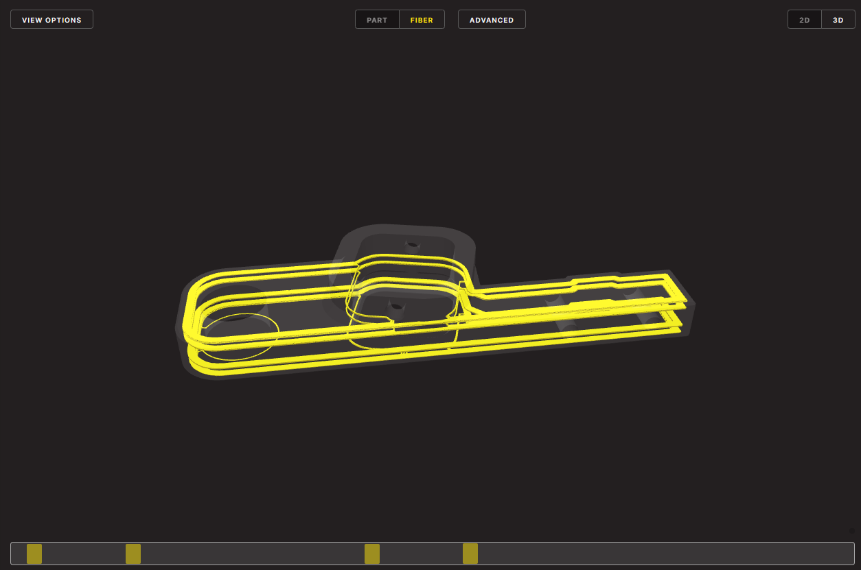

Elevator Frame Mount:
There were 4 of these. This held the elevator to the chassis (square hole) was the hinge point to tilt the elevator (round hole) and held a Falcon while keeping a chain tight. There was a bunch of twisting, torsional, cantilever action going on here. Kevlar was chosen because it’s forgiving.
Work around: Don’t design such a silly thing!
These are the only parts in our 2023 robot that had continuous fiber. Most of the work arounds are straight forward.

Here’s the story on the 3 parts listed.
Saddle:
Without continuous fiber, the saddle would “parallelogram” when turning hard and the bevel gears would either be crammed together or spread apart. When spread apart, the gears would jump and skip. The saddle didn’t break but it is a definite operation failure. Can’t be jumpin’ gears.
Azimuth pulley:
Without continuous fiber, the pulley would eventually start slipping around the hex. This only shows up if the azimuth encoder is on the motor side vs. on the module side. If on the module side, the encoder doesn’t see the slip but the more the slip happens, the weaker the pulley gets, and azimuth performance is degraded and eventually it stops working all together. Pulley didn’t actually break, but the module stops working.
This one wasn’t tested but without continuous fiber we feel that we needed hoop strength on the square hole because the elevator was putting a lot of twisting action on that, so we feared the same phenomena that happens to the azimuth hex interface. We also feared that the Falcon mount would bend or break from getting pulled hard by elevator drive chains.
