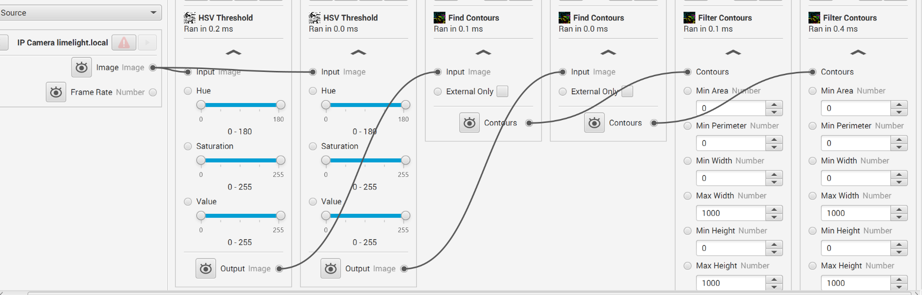

I looked into using GRIP vision for this somewhat, but it seems to only be able to track one color at a time similar to the limelight. Would making one limelight pipeline for red balls and one for blue and then constantly switching between them work?

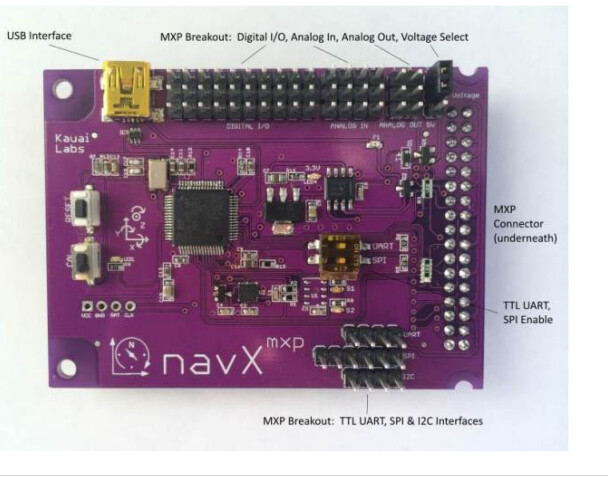

I am looking at the github and it’s saying to plug into the mxp port on the rio. But we already have our NavX gyro there, so are there any wiring alternatives? Or am I missing something?

The NavX does breakout the pins.

You can use Limelight’s GRIP feature in order to use GRIP pipelines on your vision system.
try creating a pipeline that includes 2 HSV thresholds, Find Contour and Filter Contour - one for each color. make sure to follow Limelight’s docs about generating output and collecting input.
Please note - searching for two colors at once should(I assume) damage your performance, but It shouldn’t be bad - Limelight’s regular speed is 90 FPS, Which is faster than most FRC teams actually needs.

Update: I have created a pipeline for example:
