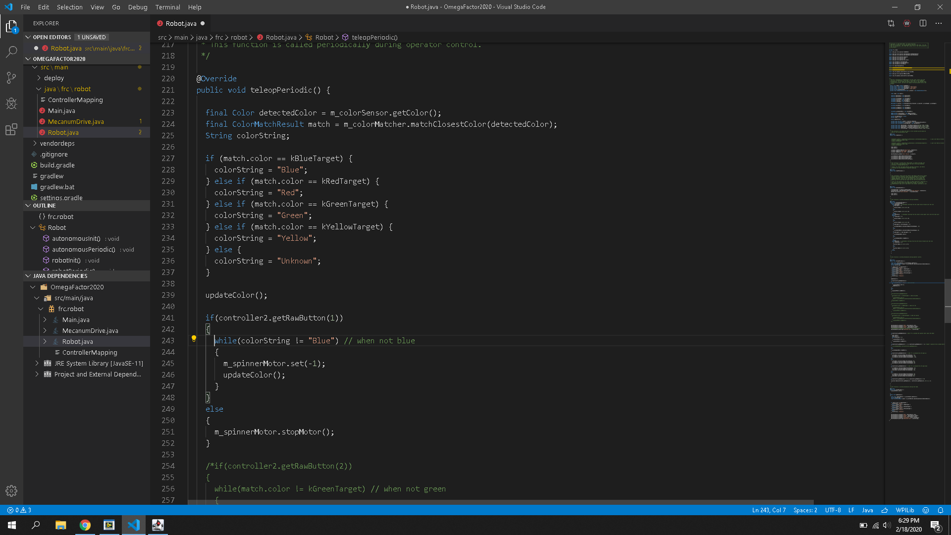

Hi, I am using the REV Color Sensor V3 that came in this years kit of parts. I’m using the example code that was in the sensors documentation. I am trying to get the motor to stop when the sensor senses blue, but I think the code gets stuck in the while loop because when I press the button to execute this code the motor never stops. The updateColor() method just updates the color sensed by the sensor. The SmartDashboard is updating what color the sensor is seeing, but the motor never stops when it sees blue.
Do you have any suggestions on what is happening?

Don’t use open-ended while loops in periodic functions. You block all the rest of the code from running. Instead save the information to need to keep over a longer period of time in a state variable at class level.
So, do you think I should use a for loop instead of the while loop?
No, err… unless you have a counter (@Peter_Johnson is that what you mean?) he means don’t loop at all. In periodic() it loops 50 hz, about . 002 seconds.
Also, how I recommend you do this is (This is for command based but bear with me) have the end condition for you motor running to be if some method of you color choose returns true. Since you are doing this iteratvley you can check if the color your seeing is the color you want and return true. Then when you call you motor on the next iteration have it end if the color book is true
I have no idea why that example code uses a while loop…
The TeleopPerodic function is already being called in a loop. The segment of code should be more like…
updatecolor();
if(controller2.getRawButton(1) && colorString != "Blue")
    m_spinnerMotor.set(-1.0);
else
   m_spinnerMotor.stopMotor();
It doesn’t. It was added later by OP.
@rachelcinn, @JohnFogarty and @Peter_Johnson have some good advice. teleopPeriodic() gets called over and over again, so you can think of it as your loop.
I agree with what the previous commentors have said. TeleopPeriodic runs every 20 milliseconds, so you don’t need a loop in the code. Replacing it with a if statement should solve your issue.
To the specific issue you mentioend
TeleopPeriodic forms the guts of what’s called “Superloop” architecture in embedded software.
The key to keep in mind is that programming for a robot requires a slightly different mentality than “usual” desktop PC programs. Inside of teleop periodic, teams get to provide a list of things to do every 20ms.
The while loop in your code currently says “Every 20ms, stop doing anything else until we detect blue” . What I’m strongly suspecting you actually want is “Every 20ms, if we see blue, stop. Otherwise, spin”.

The key - the robot will already call teleopPeriodic inside of a loop. teleopPeriodic can’t “block” - it has to “do its thing” fast and get out of the way, because there’s other things the robot needs to do.
