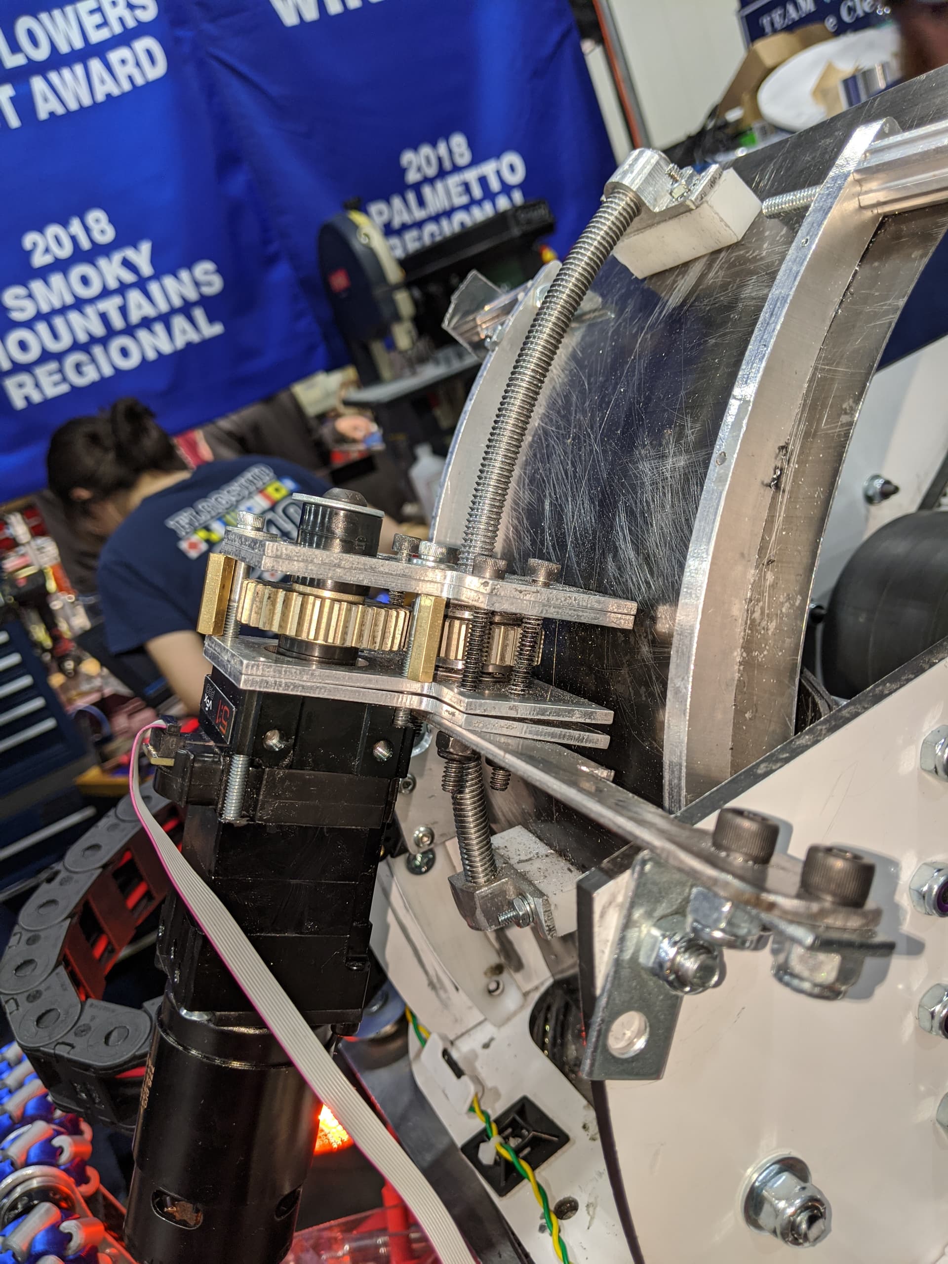

Here’s a photo I took at the Palmetto Regional in 2020. It was used to adjust the hood for different shooting angles. Unfortunately, I don’t recall the team.
If those banners in the background are from that team’s pit, 3140.
I blame TBA for the ability to find teams based on awards banners…
Definitely in the background of the pit with the curved lead screw. I know I was standing near the front of the pit.
Probably could correlate with match videos.
I’ll give you a confirmed, first video in the link, bottom left robot at the start of the match, with the hood assembly clearly visible at the end of auto.

Woah, never seen a curved lead screw before.
I imagine the threads only actually make contact on the inner side…
