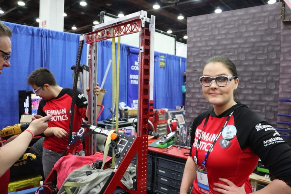

Team 4618 made good use of aluminum unistrut in 2018 to make a light weight elevator stage. The c-shaped profile makes it easy to build a linear slider without so many bearings
That said, there are so many good elevator kits now, this technique might be obsolete.

Funnily enough this is basically what we did in 2018 and 2022 but we did it with 2x1 tubing with a slot cut in one wall.
