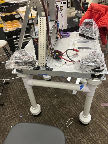

5937 has a great PVC stand for their robot. It was 4 PVC post that held their swerve drive with cross member. Let them work on the electronics and test their swerve. I wish I had a picture of it.

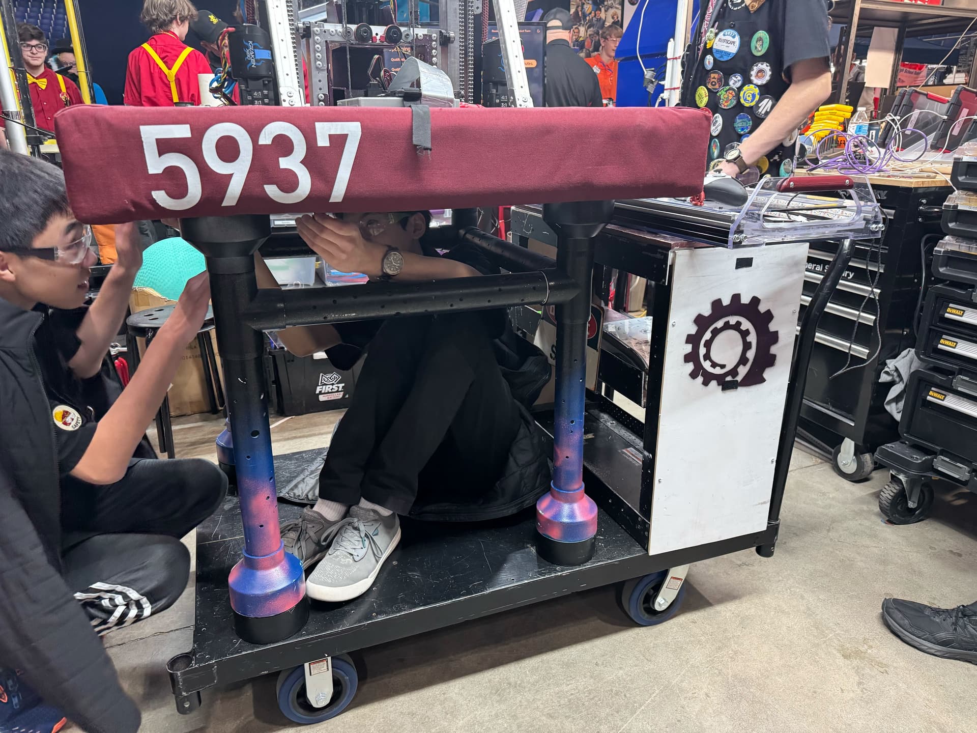

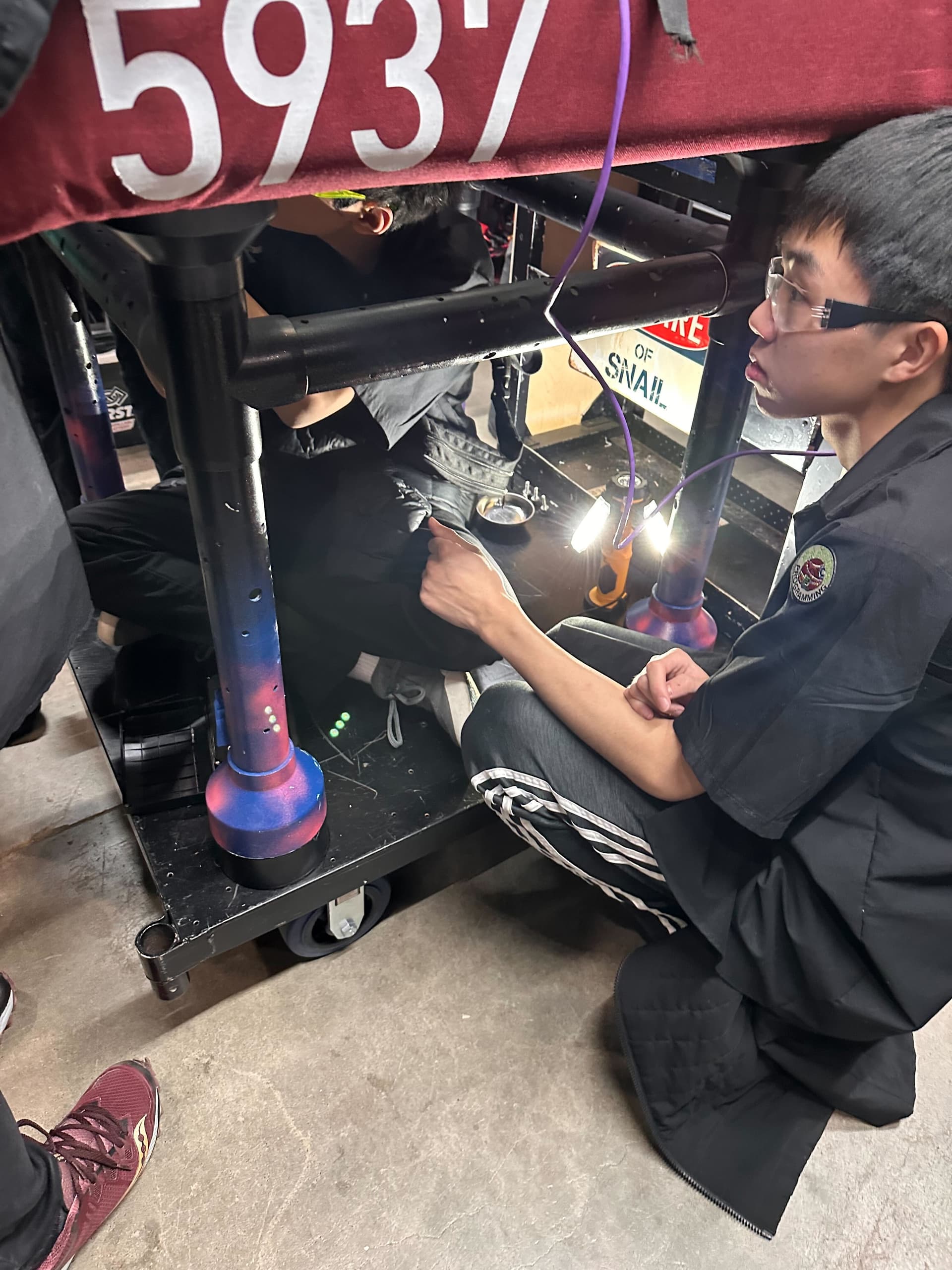

Thanks for the shoutout, here are some images of our “oil rig” as we call it. Its designed to work both on and off our robo cart due to the cups we have installed that keeps it snug.
Its been super helpful having our electrical members work down under while doing mech checks up top!
