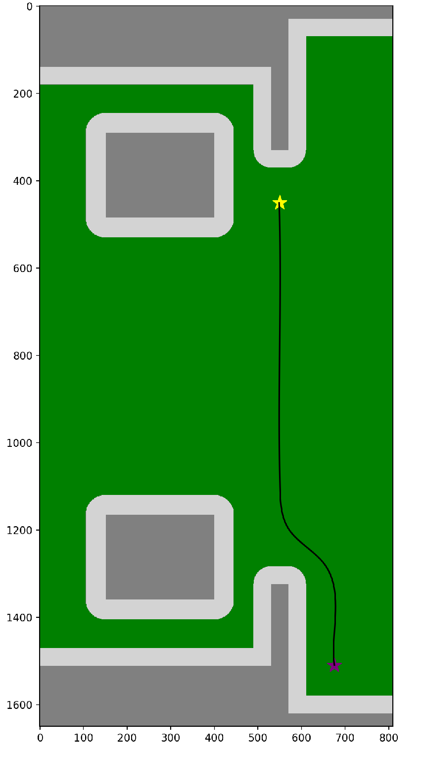

I’ve got a separate A* pathfinding program that spits out points that are roughly 30cm apart for most of the path, then 1cm apart for the last 30cm or so. And I want to use PathPlannerLib to drive the path defined by those points.

My script already generates paths like this, post-processed and smoothed.

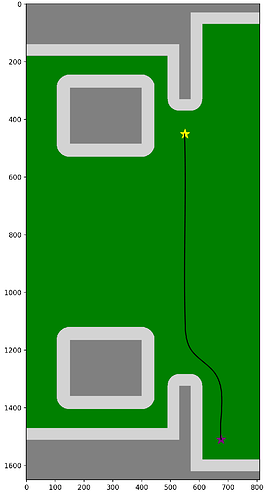

The following path is defined by 1000 points. I just need to generate a trajectory defined by a path that I’ve already found.
Yellow star is the start point.
If its pre smoothed then you’d just want to pass those points directly to a trajectory to generate off of them instead of fitting a spline. 2023 PPLib does not really allow this, 2024 will.
