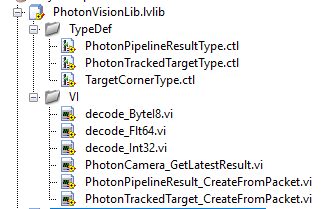

Attached is a zip file with a LabVIEW library that might decode the packet.
PhotonVisionLibLabVIEW.zip (64.8 KB)

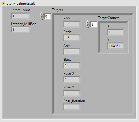

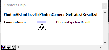

Add the library file to your robot project and call “PhotonCamera_GetLatestResult”. Pass it the camera name. It returns a cluster with the data.
Here is the cluster
Use the cluster unpack and array index functions to get individual pieces of data.
If there is interest I can continue to create the rest of the library.
Note that this version returns the POSE as individual X,Y,Rotation values. I could return a Pose, in the future but this library would need the LabVIEW trajectory and control library as a dependency.

I started down the path of doing the entire photo lib. So far the photo camera is coded and most of the photon utils. This did need the geometry functions so for those having the trajectory / control lib will be a prerequisite to those functions compiling.
