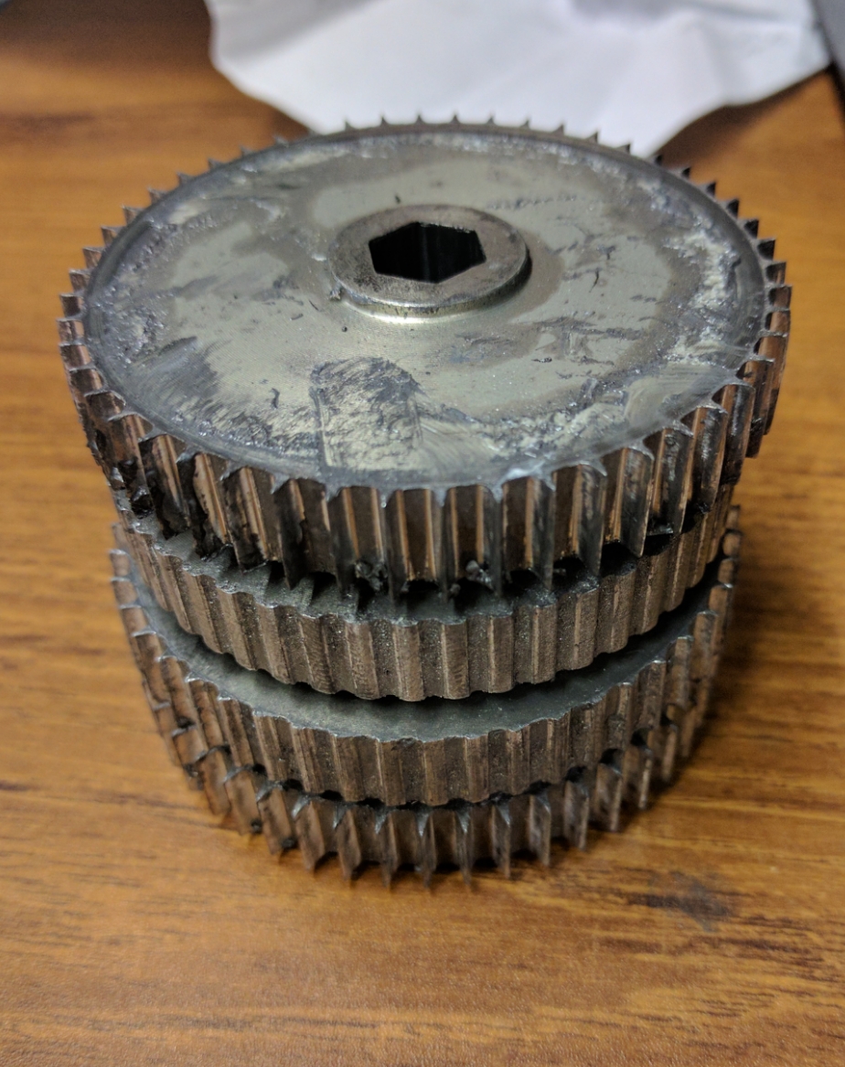

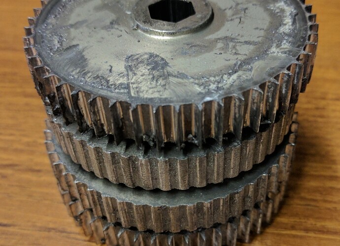

My team has noticed some very significant wear on the 50t gear in the 3 cim ball shifters that meshes with the cim pinions. My theory is that this is because it is aluminum and the cim pinions are steel, so it would wear faster. As it itself does not mesh with any aluminum gears, would it be worth it to replace it with a steel gear of the same size? We have some lying around from AndyMark. What might be some problems with this if any?

We have seen serious wear on the 50t first stage gear in 3 cim ball shifters. We had to replace that gear at least once during each of the two seasons we used them as drive gearboxes.
We used the steel pinions on the motors. Aluminum pinions might have been kinder, or they might have worn out too. The gearboxes were stuffed with lubricant.

I’ve only ever seen significant wear on the the ball shifter gears when used with steel pinions. If aluminium gears were the issue then why don’t we see significant wear on the 2nd stage? Additionally since it’s 3 steel pinions on one aluminium gear that’s 3x the wear of a normal gear reduction with steel exasperating the effect even more. Aluminium pinions are really the preferable choice. With the drive train forces divided over 3 pinions breakage shouldn’t be an issue.

The other common problem that I have seen is that, with high loading, the motor mounts can deflect and cause the contact point of the gear mesh to shift. Given the separation loads, the mesh will usually shift out toward the tip of the gear tooth and also toward the edge of the tooth closer to the motor (rather than being uniform across the entire tooth width) so if you are seeing a lot of wear on the motor end of the teeth, it is likely to be motor deflection. Make sure the motor bolts are tight and wiggle the motors to make sure there is a good amount of stiffness in the mounting. Keep in mind that the motors can also move due to inertia during robot acceleration or impacts and not just the separation forces at the gear contact point.
The 3 CIM ball shifters seem to have a decent amount of stiffness and strength so I would not expect this problem with that gearbox unless the motor bolts are loose. We used one of these gearboxes for the first time this past season for our lift and I was pretty impressed with the construction. But our application was not very abusive in terms of loading, so others may have a better input on the gearbox stiffness for more abusive applications.
The other “issue” that I would expect could cause excessive wear (although I have not experienced this directly) would be if you had one dead or poor performing motor. If one motor was dragging on the gear instead of driving, then you have the other motors working harder which would cause higher loads and more wear. Plus the bad motor would be being driven which could result in load and wear on the other side of the tooth.
We’ve been using aluminum gears for a long time (2011?). You’ll experience worse results using the aluminum gears as the pinion and I would not use them. I forget what year but we made 11T and 12T gears out of 7068 Aluminum and had issues with them wearing out. I’d much rather change the large gear out than replace each cim gear.
The first stage experiences the most wear due to high speed + multiple pinions on the same stage. The second stage doesn’t wear as badly due to slower speed and single gear contact.

We’ve experienced a similar condition with the first stage of the WCP Dog Shifter gearboxes over the last 3 seasons in which we used them. We would have to change out the large aluminum gear(s) that mesh with the steel CIM pinions at least once throughout the season due to failure or fear of failure.
One theory I have to explain this wear condition is that the plates or housing that the CIMs are cantilevered from is not entirely rigid. As a result, the motor has a slight rotational degree of freedom by which it can “wobble” away from it’s axis and its shaft can deflect toward/away from the gear it meshes with. The small variation in gear mesh could contribute to the steel pinions grinding away at the aluminum gear slowly over time. Other components of the gearbox are all supported on both ends by the parallel plates of the gearbox, whereas the motors (for the most part) are cantilevered off a single plate or a plastic housing. Take this with a grain of salt as this effect has in no way been measured or proven.
Add to this that the first stage gears mesh and un-mesh at 1.5-3 times the rate and with 3 times as many contact surfaces as compared to the output stage, and it could help explain why we observe nearly no wear on the output stage gear sets but a substantial amount of wear on the first stage.
We also had even worse problems in 2014 before we 3D printed custom “snowman hole” spacers to prevent the motors from vibrating away from their intended location, but that is a separate issue that does not apply to the ball shifters as far as I am aware.
We are looking into steel gears and belts for the first stage as potential alternatives to see if it would solve this problem.
