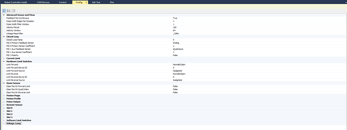

Could you also post a screenshot of the config screen? Specifically with the advanced sensor and meas, closed loop, hardware limit switches, and home sensor tabs open like below? You can right-click collapse all and open just the ones we care about to make it easier.

Based on this it sounds like Brandon was configuring the sensor to be not continuous at some point, but later un-configured it. That’s why I asked for the screenshot of the configs to confirm this.
