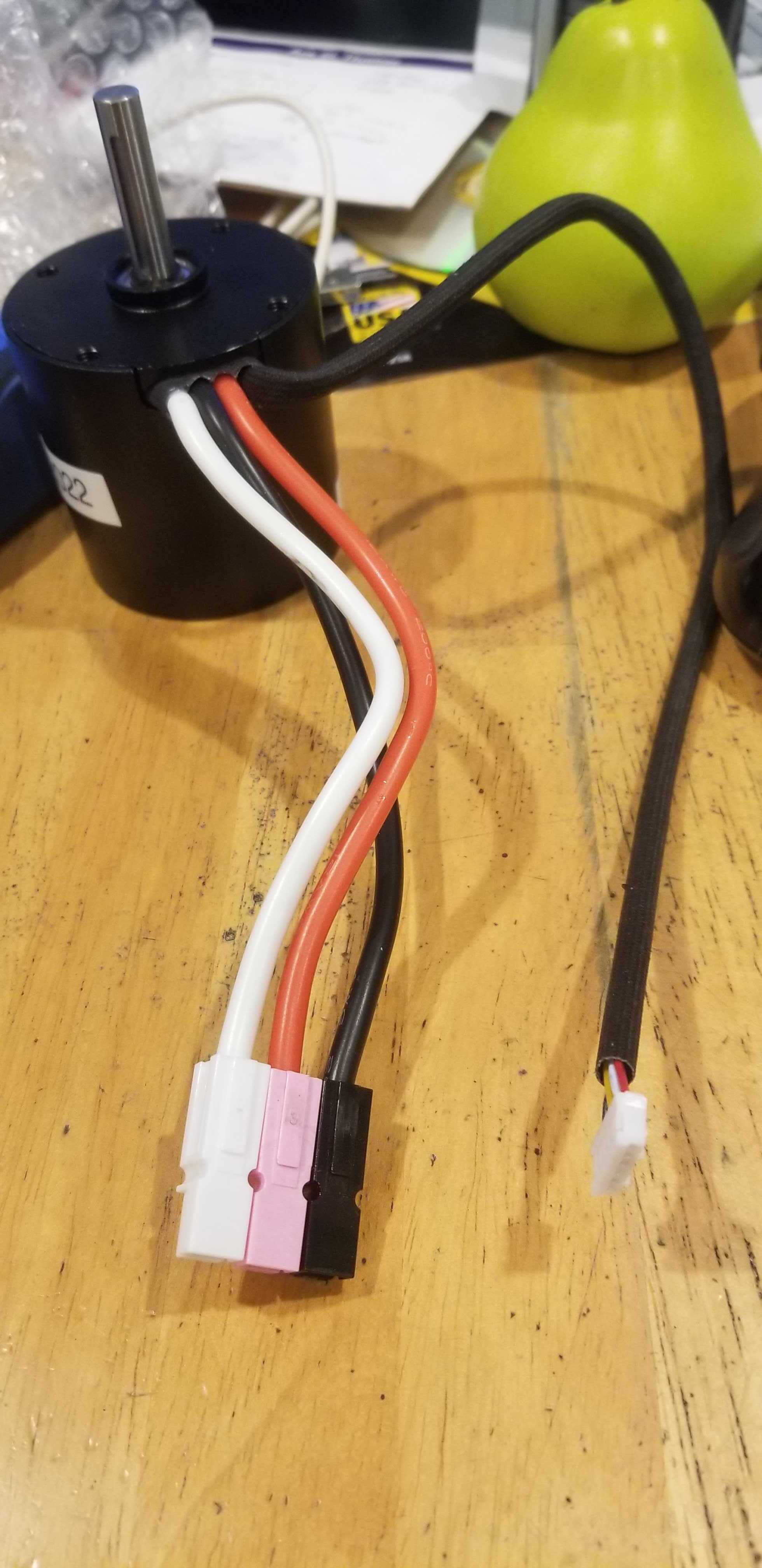

We use Anderson Power Poles for all of our motor connectors. We standardized on a pink APP housing for the red wire so we know pink is for motors.

I like that you got white Anderson housings for the white wires, too. It keeps the whole setup nice and clean, with very little chance of an incorrect connection. And you pic is a perfect example of why this works so well for these three wire connections. You can block the three Anderson housings together and use two of the Powerwerx retention clips to keep the whole thing solidly connected pretty much no matter what happens.

Honestly, a declaration of “pink is for motors” is kinda genius–especially for teams who still have brushed motors in the mix (even I have to look closely at an OG SPARK to make sure I got it right). Might explore that in the off-season; it’s not like changing out PowerPole housings is a big production.
1293 braids its NEO and SPARK MAX cables to keep them from getting tangled on things, a tip we stole from Spectrum. The main thing we have to do is ensure we got the red-black-white slotting order consistent across each connector. If not, undo the joint and swap them back around. The ability to slap whatever SPARK MAX into whatever NEO makes assembly and maintenance super simple.
I encouraged my team to use green/white housings for the motor side and red/black for power side. And this was even before the TalonSRX came out with the green/white wires. Unfortunately we had picked the opposite coloring they did (we did green+ white-) so there was some wires to swap around. In any case, +1 to utilizing different housing colors for different things.
