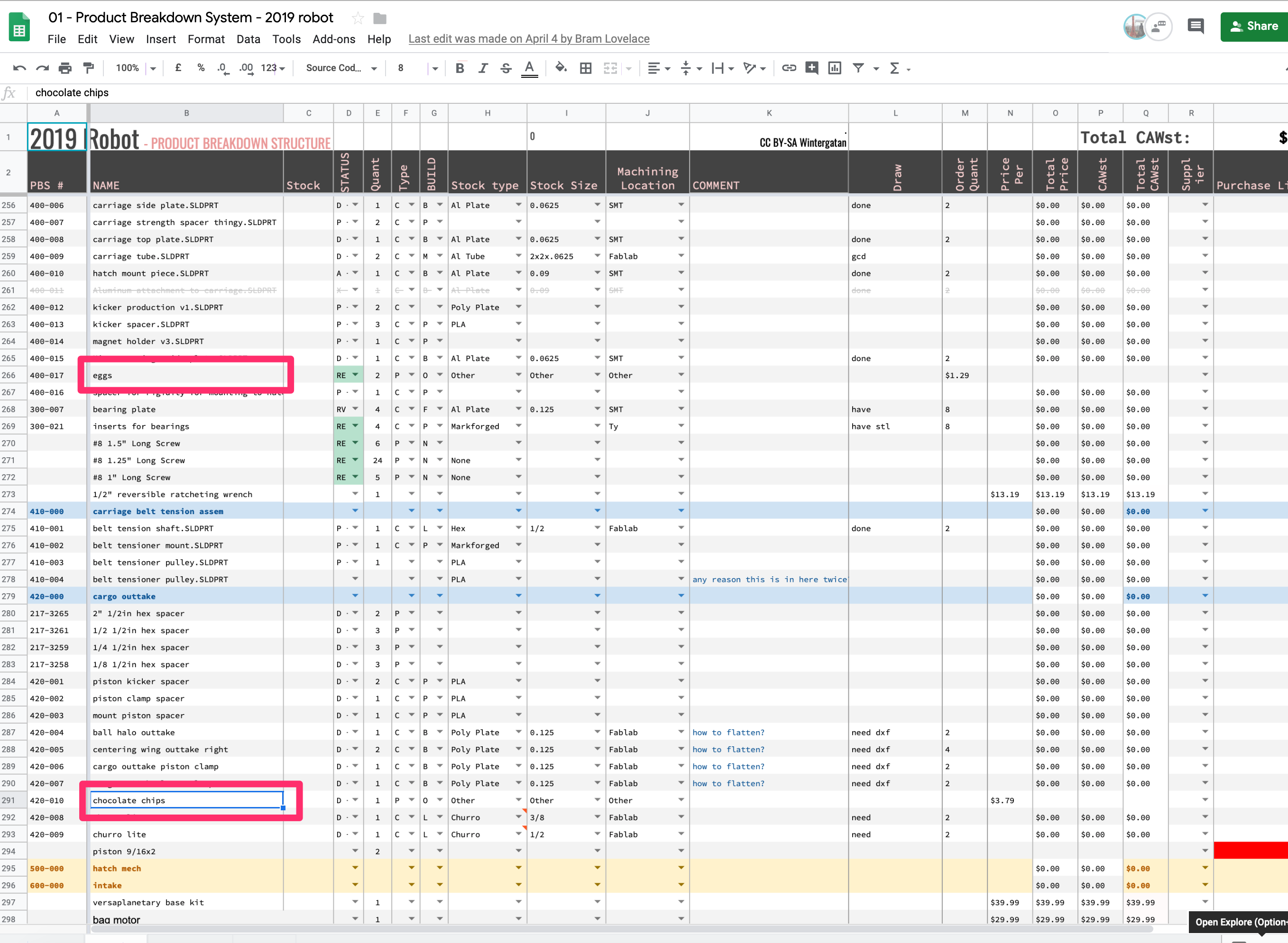

Back in the days of the BOM, at least one team included food ingredients on their list of robot parts…

Don’t know about soup cans, but no inspectors seemed to have problems with chocolate chip cookies (or at least their ingredients) on a robot
Edit: sniped by about 8 hours
See above: Validity of strange materials - #4 by marshall
Don’t know how I missed that…
