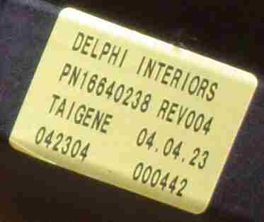

Did the sticker on the motor call out the same part number as the one I attached a thumbnail of, or the spec sheet motor? Cause they seem to be two different models, and/or part numbers.
Sorry I didn’t check it, but I will tommorow and let you know
I opened ours up. This year’s has a ~104 tooth worm gear (as best as I can count without complete disassembly) and a worm with two threads for a 52:1 reduction. A prior year’s (with a 75rpm free speed) had a 65 tooth worm gear and a single thread worm. So the speed reduction is not due to the gearing.
Ok. What was the part number on the sticker of yours?
Tested ours, this years 51 rpm battery voltage 12.4, Last years 78 same battery voltage. Both will back drive with a wrench, BTW no speed difference on this years motor forward or backward. Sticker on the motor is similar to one further up in the post. Didn’t check the numbers yet. Will do and and edit this post. Ours is the rev 02 and part number 16644829 the same as the pic posted by Elgin Clock post #19

Wow, our motor number (16640238 rev 4) is different from both the spec sheet and the thumbnail above. Today, we did a whole lot of testing with textbooks and a multimeter on it, and we’ll come up with a power curve for this given model, and post it up if anyone cares/is willing to believe our Überghetto experiments. What’s really annoying is that there are 4 different models of the “same” motor mentioned in this thread only… What does FIRST have to say on this variety?

Here’s our model number. 50 rpm both directions @12.4v.

Has anyone found a resolution to this problem yet? I posted this just now:
ID: 1624 Section: 5.4 Status: Unanswered Date Posted: 2/13/2005
Q: Our van door motor, labeled “bad” has a serial number of 16640238, while the motor spec’d in the FIRST spec sheets is 16638628(appears to be last year’s). Our motor has an RPM only max of 52rpm, spec is 76rpm, what do we do??
Since it seems like all the other questions asked by other teams on this issue were deleted, I figured I would try again.
As the question states, we are seeing the same thing mentioned in this thread. Our van door motor has a different serial number than the specification document on the FIRST 2005 motor spec:
http://www2.usfirst.org/2005comp/Specs/Taigene_PSD.pdf
We have checked all of our wiring, and even run straight from 12.8V, and the motor will only spin a maximum of 52RPM!!! We had planned and designed around the specification of 76RPM, but now our lift is way too slow!!
