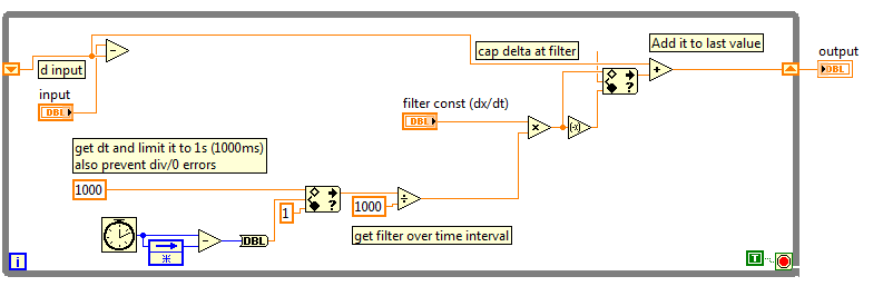

We use LabVIEW, and this VI is probably what does the trick.
I am sure that this method is available in Java and C++.

So, in labview…
lineal ramp…
We use this.
Believe it was written by Killer Bees, we have just been dragging it along for years.
