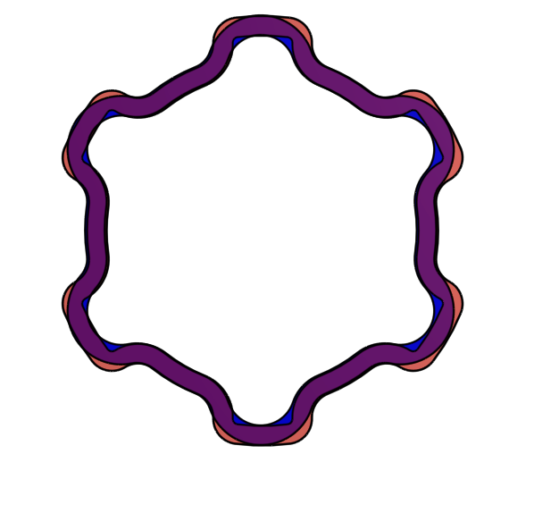

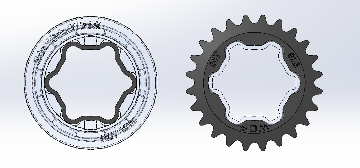

First: MAXSpline vs SplineXL
Yes, MAXSpline was released last year while SplineXL was this year but there are compatibility issues with both
There will certainly be compatibility issues that may come across but if there was just 1 standard to the spline, this would be solved. I really, really love what @R.C and WCP are doing with SplineXL by keeping it open and allowing other companies to build/design around SplineXL.

For what it’s worth, I expect SplineXS to be the definitive spline shaft going forward, unless Vex somehow puts Falcons back into production and manages to recapture the market. With the Neo Vortex having a swappable shaft, REV should be able to put out a SplineXS shaft and ensure its usage across vendors.
Ya. I forgot to mention about the NEO Vortex. I really love this feature and that REV is actively adding new shafts!
