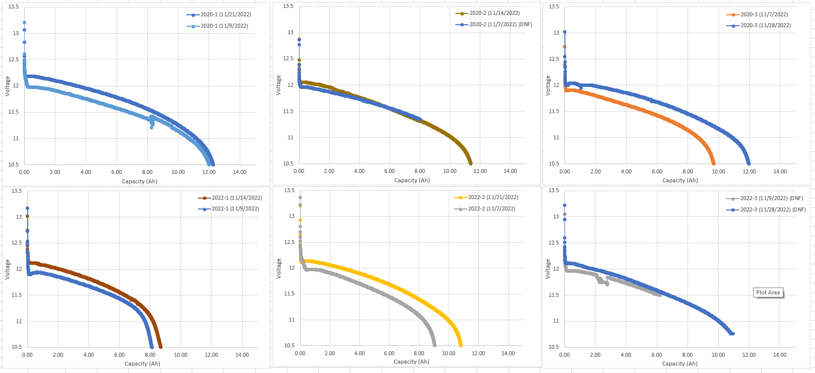

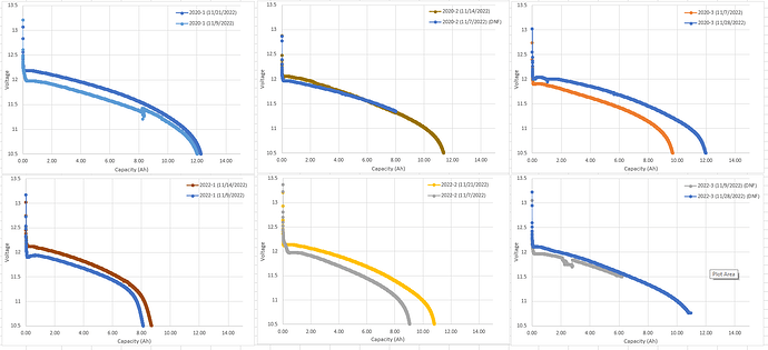

Just to add to this. Here’s some testing of 6 of our batteries. The initial high voltage doesn’t really last that long.
Good point, hot off the charger voltage isn’t always a good indicator of actual charge.

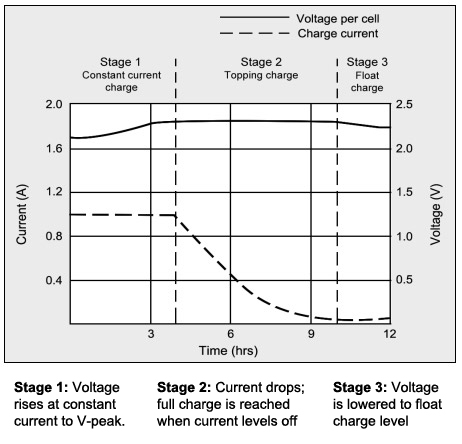

This is not always true, depending on the type of charge profile. Most smart chargers will use this charge profile:
Note that the current drops almost to zero, thus the voltage loss from a high resistance in the charge circuit will drop almost to zero.
In the constant-voltage float portion of charging the high resistance connection will result in a smaller charge current vs a good connection, but at ambient temperature the battery will still be charged up effectively and efficiently. At least, efficiently from an energy perspective, not a time perspective.
So, while I very much agree that loose or degraded battery-related connections are REALLY bad, and will increase charging time, they ought not to have an outsized impact on the final SOC of a battery.
A qualitative example is charging a car battery on a charger with spring clamp terminals. The spring clamps make pretty lousy contact and cannot transmit much power, but my car battery still gets to the same 13.x volts of a full charge.
This depends on the control logic in the charger being used. A high sensed voltage can cause it to switch to trickle charge and stay in that mode. It is possible that the control logic may detect the lower voltage due to a lower state of charge and switch back to a high current but a simple control scheme probably won’t.
The charge current graph assumes a good, low resistance connection. The OP did not have that.

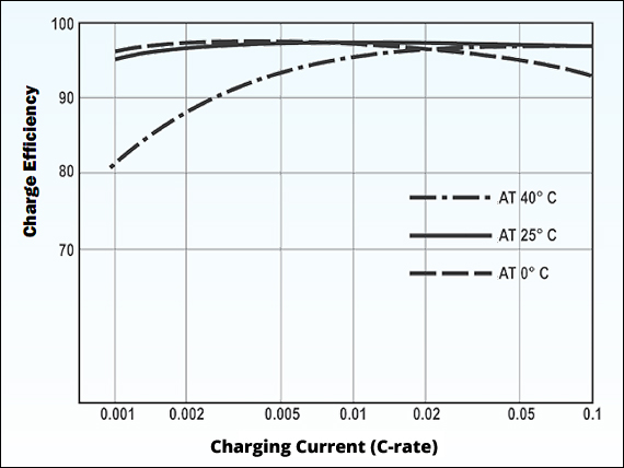

I don’t think that’s true, but that’s a little immaterial to my main point. I also thing the CV/float portion will bring the batteries to the same charge point, eventually. But, if you’re not convinced by that… let us crayola the math:
A 100mOhm resistance (which is crazy high for a contact resistance) at max charge current of 6A will cause a loss of 0.6V. You’ll charge to 13.0V instead of the nominal 13.6V float. I suspect most people would agree that starting at match at 13.0V should provide far more than the ~70s of runtime OP is describing.
A 100mOhm resistance would only allow the battery to discharge at 68A, which would be observed as a nearly-instantaneous brown-out while driving. Yet the SOC is still decent (not great, just decent).
