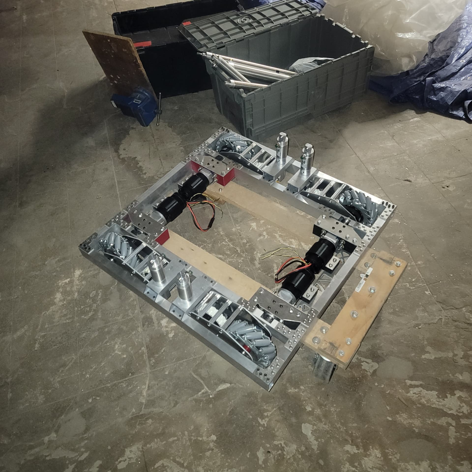

We used the AndyMark mecanum last year they were terrific. Not one roller failure. From build thru competition we ran on carpet only. We now use they bot for demos and training on concrete floors in our shop and ran it retty hard wih no significant wear. They are a little pricey but well worth it if you plan to go this route. If you can’t go swerve its a good alternative. In this photo the wheel setup is different than what we eventually mounted, we chaged the mecuanum pattern to better work with our programming.

The AndyMark were srurdy but there was a lot of design work that went into it we made a butterfly fly system for the climb and some defense last year not to mention all the machining we did on a Bridgeport end mill and Waterjet cutting. All of that came we a weight penalty we had to overcome. The weight of the chassis was 65 lbs. So we drilled out a lot of holes. But it drives well.
