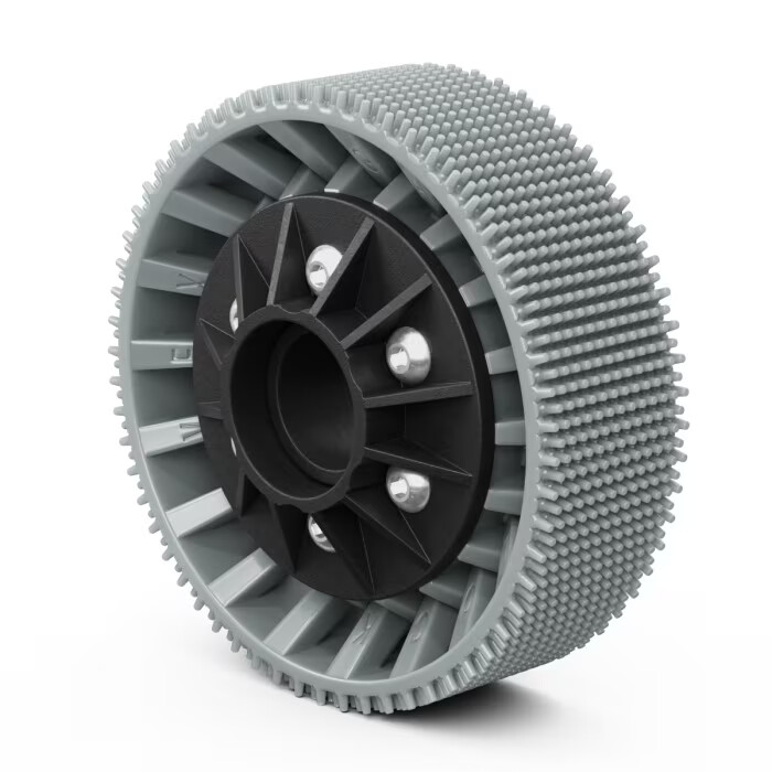

217-9042 - Grip Lock Wheel 4" (4-pack)
The Grip Lock Wheel is optimized for low pile carpet applications. When compared to rigid wheels made of aluminum, plastic, or rubber, the Grip Lock Wheel greatly improves the contact patch with the carpet, increasing traction and providing shock absorption.
These wheels were inspired by the TJ2 (FRC88) team and their novel TPU Grippy Tires
Technical Highlights:
  • 4” nominal diameter
  • Durable Glass Filled Nylon hub
  • Compatible with major swerve modules using 4" wheels (MK4i and SwerveX)
  • Does not require fork removal for wheel replacement on MK4i modules.

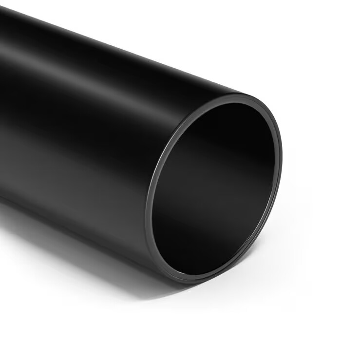

217-9057 - VersaRoller Grip Tube 2” (1-pack)
The VersaRoller Grip Tube is a cut-to-length intake roller constructed with silicone pre-stretched over 2” OD polycarbonate round extrusion. The 2” roller allows for a greater surface speed as well as a larger tangent contact, helping to intake and manipulate objects quickly and efficiently. This product makes building true “touch it, own it” roller intakes a breeze.
  • 30” length
  • 1.875” ID, 2.1” OD
  • Wrapped in soft black silicone

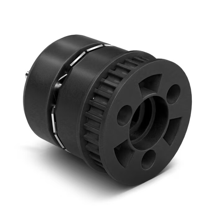

217-9038 - VersaRoller Hub 2” (2-pack)
The new VersaRoller Hub was developed to revolutionize how fast a good, robust intake can be constructed. It comes with a 30T HTD 5mm pulley that keys directly into the hub, making power transmission simple. The new hub is able to work with both “dead” and “live” axles to provide maximum versatility.
It provides a hub option for our new 2” VersaRoller system that only needs a saw and a T15 driver to create a custom length intake roller.
  • Comes with a 30T HTD 5mm pulley
  • Attaches to tube with an internal, expanding steel plate
  • Compatible with ⅜” or ½” round dead shafts or ½” ThunderHex live shafts. (not compatible with true ½” Hex Shaft)
  • Compatible with most common FRC roller materials with a 1.875” ID

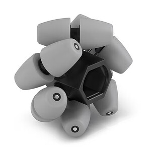

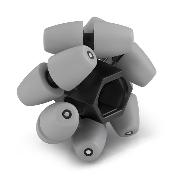

276-9041 - 2" Mecanum Wheels v2 (4 pack)
The new 2" Mecanum Wheel v2 provides a good all-round vectored intake wheel for game object intaking and control. This new iteration significantly increases the distance between the hub and rollers, nearly eliminating all dead spots. This seamlessly integrates into your robot’s intake system. The diameter of this wheel matches the diameter of the new Omni-Directional Wheels and VersaRoller Grip Tube.
  • Near seamless contact patch
  • 2” effective OD
  • ½” Hex Bore
  • Designed specifically for intake applications
  • Rubberized rollers for extra grip

What plastic type is used in the carpet wheels? How long are they expected to last?
TPU 85A durometer.
We hope to have more information and documentation available for the Grip Lock wheels soon. We conducted some traction testing comparing this wheel to various wheels popularly used in drivetrains currently. We are still compiling the data and making it presentable. Stay tuned!

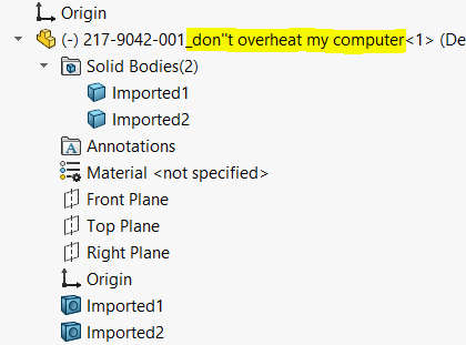

I do appreciate this after having experienced the slideshow those features can cause :rofl:

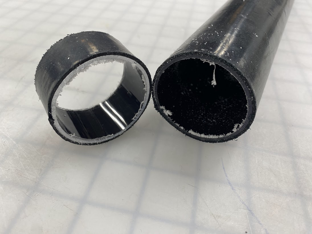

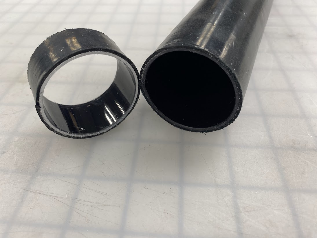

That Grip Tube is really interesting… But, you mentioned the silicone being stretched over polycarbonate. How does that stretching survive being cut? (and, how do you cut that?)
I can’t say for certain for this product, but based on my experience with silicone surgical tubing manually applied to VersaRoller in the past, it actually cuts really nicely.
You’d expect it to want to chunk away or peel apart, but as long as you have a sharp blade and take care, it cuts beautifully.
The “Stretch” happens radially. So you take a silicone tube and stretch it around a PC tube with an OD larger than the ID of the silicone. This retains the rubber quite well.
For cutting the versaroller grip tube, we’ve just used our bandsaw here at the shop, and it cuts through both the rubber and polycarbonate great!
This is fresh off the bandsaw:
This is after deburring

Could we also get more information on the VersaRoller Hub? How does it actually attach? Is it one time use? Am I going to need to buy a new one every time we install one and then need to remove it? How does this internal expanding steel plate compare to the traditional method of using a bolt from the outside of the tube? It seems like these would slip out? What happens if only 2/3 of the bolts are tightened and the 3rd somehow got loose? How does that affect the pull out force? If the roller is held still, what is the maximum torque it can handle before slipping inside the tube?

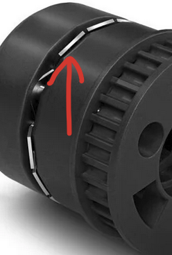

It looks like there is a steel plate that expands/folds out when screws are tightened through it:

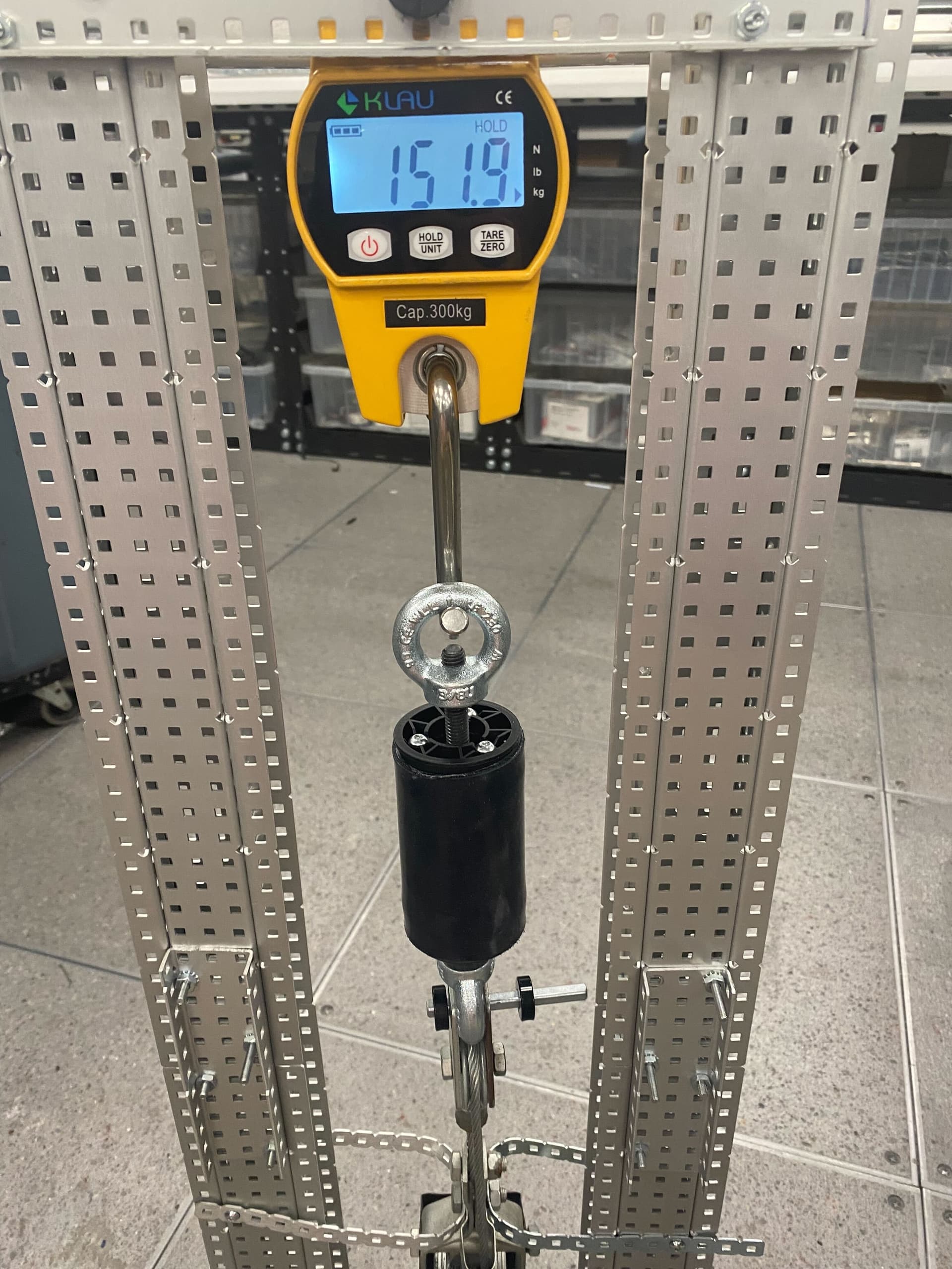

For the new VersaRoller Hub, I can answer some of your questions.
  • It attaches to the tube via an expanding spring steel plate. This plate sits between two plastic hubs, which compress the plate and force the integrated fingers to expand into the tube material. This creates a strong connection between the hub and the tube.
  • It is not one time use. The metal plate is made from spring steel, so it springs back to its initial shape when you unscrew the clamping screws and remove the hub from the tube. From our testing so far, there is no noticeable change in shape after many install/removal cycles.
  • We have tested the pull out force of new hub in our new VersaRoller Grip Tube. It can take over 300lbs of force to remove the hub when the screws were tightened to 1 ft*lb.
  • I was curious about the change in pull out force if one of the screws got loose, so I did another pull test, but this time only installed 2 of the 3 screws (tightened to 1 ft*lb). That test had a pullout force approximately 2/3 of the ones measured prior.

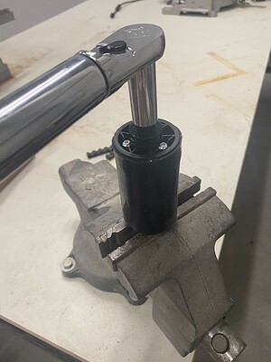

  • I tested the torque the hubs could handle with a short roller with the ThunderHex adapters installed. I locked one thunderhex shaft in the vice and attached another independent shaft to a torque wrench. I measured over 25 N*m of torque before the hubs slipped in the tube.
Torque test setup:
Tube after torque test:
Pull test setup: [Scale shows kg]
Tube after pull test:
Pull test with 2 screws: [Scale shows kg]
