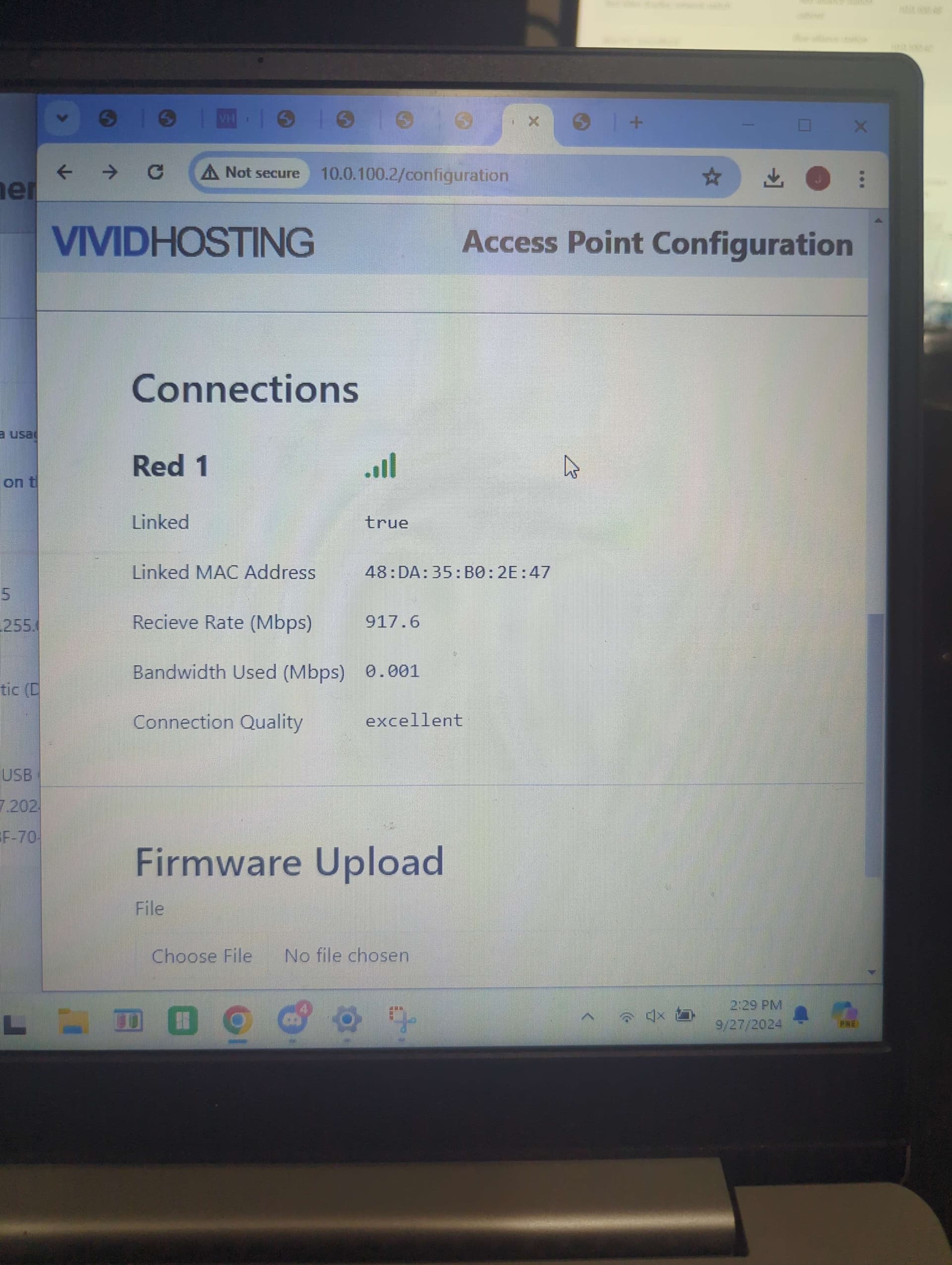

I was able to deploy the firmware upgrade/conversion (Field AP). I configured a test robot radio, used the configuration page on the VH-113 conversion to manually set a allowed robot radio SSID and WPA key as RED 1 and got an excellent connection.
DS opened on an attached PC to the VH-113 conversion and was able to successfully see the test robot radio.

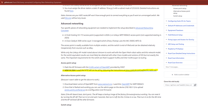

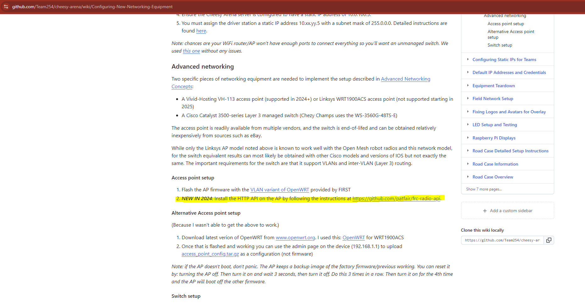

I note the CA Advanced networking page says you must install the RESTful API - and perhaps this is where my problem lays - I would have thought this layer/API would already be included in the VH-113 conversion image?

That REST API installation instruction is only for the old field AP, not the VH-113 (which has its own REST API included already). The Cheesy Arena docs seem to still have a mix of both instructions during this transitional time.

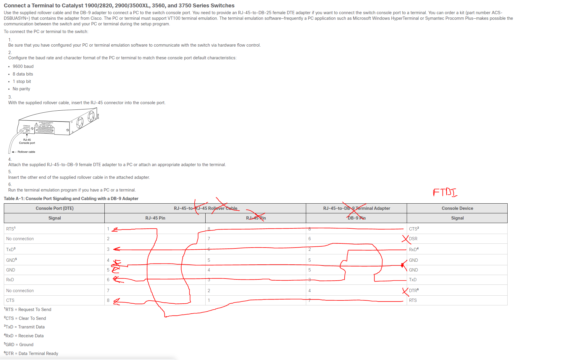

Fired up our recently purchased used Cisco3560G. Used an FTDI USB-Serial adapter and wired a RJ45 connector according to the hardware docs for the console port pinout omitting DTS and DRS (weren’t available from the FTDI adapter board and appeared to not be required by the wiring diagram).
Installed PUTTY and tried to establish a serial connection to the 3560G switch using the above cisco hardware doc baud rate and settings - but no luck. Could not get a response printed out on the terminal emulator.
My FTDI adapter board TX light would flash every keystroke, and during/after boot the RX light would illuminate/strobe indicating activity/data but nothing showed up in the terminal.

Edit: perhaps my terminal emulator was not properly configured ( set term=xterm or set term=vt100)…xterm is the default but I believe I need VT100
Is your FTDI serial adapter a TTL or RS-232 adapter?
It is an older version of Adafruit’s FTDI Friend I had laying around.
Console ports on switches typically use rs232 logic levels (± 5v to 15v, inverted logic) instead of ttl (0-5v). These are incompatible, and rs232 levels can potentially cause damage to devices expecting ttl. You’ll need to use an rs232 to ttl converter to use that adapter, or find an rs232 to usb adapter. Here’s an adapter that should work out of the box:
Edit: in your wiring diagram, you also have the wires connected incorrectly; The switches TX line should be connected to the adapter’s RX line and the switches RX line should be connected to the adapter’s TX line. Likewise, the switches CTS and RTS should go to the adapter’s RTS and CTS respectively.
If my FTDI Friend is shot, so be it, its not the end of the world. I’m getting ahold of a RS232-RJ45 adapter tomorrow omitting my handmade device entirely making the following academic…
Thanks for spotting the signal flops - I dont know why I didnt think of that yesterday making the adapter. I was thinking of the table as “tracing the wire from A-B-C”.
Using the top Console Device signal as an example (CTS), I interpreted the table as saying: CTS–>pin 8 in DB/RJ45 adapter–>pin 8 entering rollover cable which then logically “rolls over” to the bottom.
But looking at the table now in the rollover cable pin 8 becomes pin 1, meaning all of my wires should be straight across :stuck_out_tongue:
All in all: I’ll try again with the real-deal adapter tomorrow :slight_smile: And make sure VT100 is set in m y Putty session.

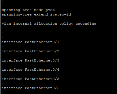

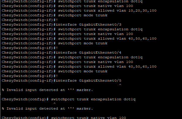

Although…Its not loving the config file. The switch I purchased is IOS version 12.2, it gives a warning at the <Version 15.0> line that the configuration may not be fully understood.
It moves on however and finally starts giving up the ghost at the interfaces. Do I just need to rename all the GigibitEthernet interfaces to FastEthernet? The boot running switch config labels the 48 switch ports as FastEthernet with only 4 GigabitEthernet interfaces.

Yeah just rename the interfaces in the config file and paste then again.
