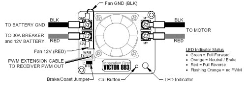

Hello. I would first like to start by thanking all of you that have been helping with my summer project (now a before-build season project). I am to the point now where I am wiring the electrical system together. I ran into a problem however with the victors. I know how to set the victors up to the breaker and to the PWM input. My question is how and where to the connections of the fan run to. Do they attach to the M+ and M- or do they need to be run to a spike, or are they run right off of the battery?

You’re supposed to crimp ring connectors on the leads, and screw them into the +12 and Common terminals on the Victor, itself. Note that these are not the same as the M+ and M- terminals.

All I see on the victors are M+, M-, +V, and GRD.
-Greg The Great
That’s fine: +V is the same as +12, (i.e. +12 V) and GRD (or GND) is the same as common (i.e. ground).
You should connect them to the input side of things in order to keep the fan running at all times; if you had them on M+ and M-, respectively, the fan would work, but only when you applied power to the motors! (Don’t do that!)

So the fan connections as well as the input for the 12 volt and ground both go on the +V and Common?

Hmmm. I’m not quite sure you got that right. Remember to check out that wiring diagram. A picture is worth a million words in that case!
yup, make sure you connect them correctly otherwise you will fry the fans, then you will probably fry the victors, and that is expensive.
http://www.innovationfirst.com/firstrobotics/pdfs/V883UsersManual.pdf
You should aprobably read the manual linked above, the wiring and everything is on the first page.
Here you are:
Think about this:
