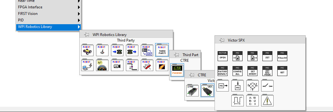

Download and run Phoenix Installer: https://github.com/CrossTheRoadElec/Phoenix-Releases/releases/download/Phoenix_v5.15.0.0/CTRE.Phoenix.Framework.v5.15.0.1.zip
This should place the necessary LabVIEW libraries for Victor SPX.
When you right-click on the block diagram in LabVIEW, you can find the third party VIs for the Victor SPX as shown here:

Maybe some confusion about whether these are wired for PWM (red/black/white wire to RoboRIO) or for CAN (green/yellow twisted wire to CAN bus between RIO and PDP).
For PWM, I would probably just treat them as a Victor SP (their predecessor that was PWM-only).
For CAN, you need the libraries I put above.
