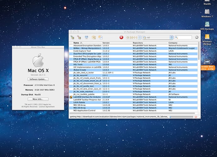

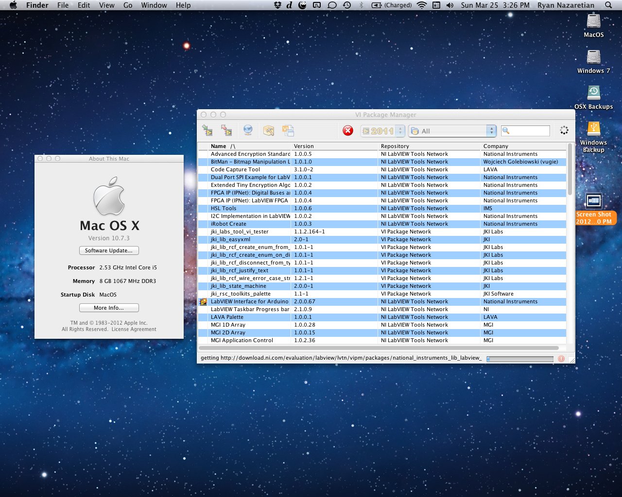

Doesn’t work on OSX Lion you say?
I installed it a while back. I remember having to allow some permissions within the terminal to get it to install.

We (JKI) have a knowledge base article on how to install VIPM 2010 for Mac on OSX 10.7+ located here:
http://support.jki.net/entries/21234937-vipm-installation-error-on-osx-10-7
