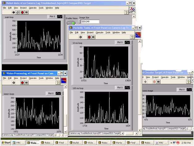

I have done a little more testing today, but people have been busy putting the cRIO on the practice bot. a few thoughts/ questions:
-when vision processing is disabled, the dashboard image does not update at all. Is this normal?
-is the main loop, with teleop and autonomous code and such supposed to run quickly while image processing is enabled?
Again, we are running the updated version of LabVIEW, and have done the recent cRIO imaging. I am running code via ethernet from a single laptop (not the Classmate, it is at a scrimmage). We are using the remote dashboard utility.

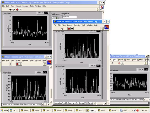

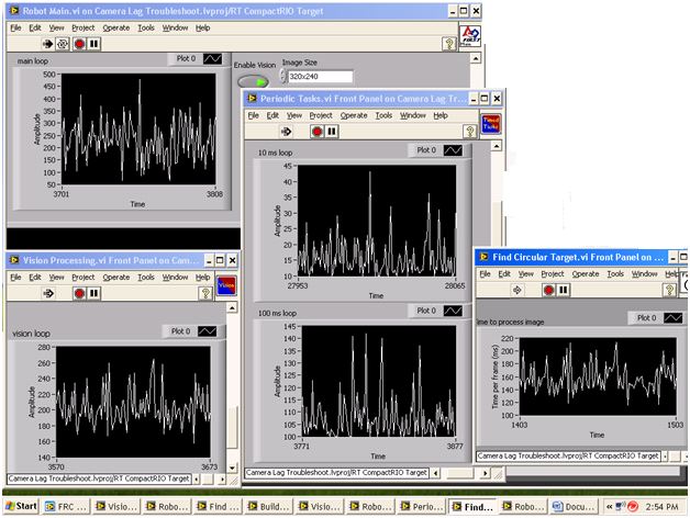

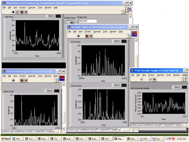

I am including a few screenshots. The first is with vision enabled and the local dashboard on. The second is with vision processing disabled and the dashboard running. the third is with vision enabled after I exited out of the dashboard, and the fourth is with vision disabled and the dashboard closed. The graphs are gathered using this snippet of code, excetpt the seconds to respond, which is already in the default project.please note that the time to process image, bottom right, did not change with vision processing off.

A couple questions: Is the dashboard supposed to show live feed from the camera while vision is disabled? Ours doesn’t…
Quickly, I have been running from a single laptop, through ethernet cables, to the cRIO, and using the local dashboard.
Has there been a dashboard update? How do I check what version I have?
I THINK that the main loop, with teleop code and such, is supposed to run fairly quickly, and since it is not related to the vision loop, should be mostly unaffected by having image processing on, as is suggested by the comment in the robot main block diagram. Is this correct?
We have tried compression (5, 20, 25) and taking out all of the teleop and autonomous code from a default project, but the main loop still takes around 200ms with vision processing on. The periodic tasks also appear affected, but not as much.
Could these issues have anything to do with the recent update?

Since I don’t have a cRIO at home, I can only look at the code for now. The only thing that stands out is that the camera is set to only 4 fps. This shouldn’t cause lag, but will cause the vision loop to run slowly.
One thing that would be good to try is to go to the I/O tab on the DS, and set the configuration to Enhanced. Also, make sure that you do your timings with the minimal panels open.
We’ll look at the VIs in more detail tomorrow.
Greg McKaskle
How does that affect the timing?
Changing the driver station configuration to advanced does not appear to have an effect. Changing Frames pper second does not have any visible effect. With only the robot main frontpanel open, the main loop is running at 200 ms with a target, 100 without, and 40 without vision. Oh well.

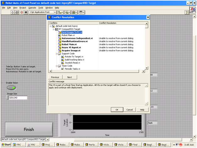

Also, I got an error thing whenever I tried to run code. It was probably the laptop being funky, but I will post it When I get back to school.
here is a screenshot of the error that comes up
That’s not an error. It’s just an informational message telling you that there’s already code running on the cRIO, and that it will be halted in order to run the code you’re telling it to run instead.
I downloaded and tested your Camera Lag Troubleshoot.zip code. With vision enabled I get loop times between 40 and 170 ms. With vision disabled I get loops times between 30 and 65 ms.
Then I turned off auto error logging following the instructions here. With vision enabled I now get loop times between 15 and 65 ms. With vision disabled I get loop times between 15 and 23 ms.
You might want to try turning off auto error logging.
