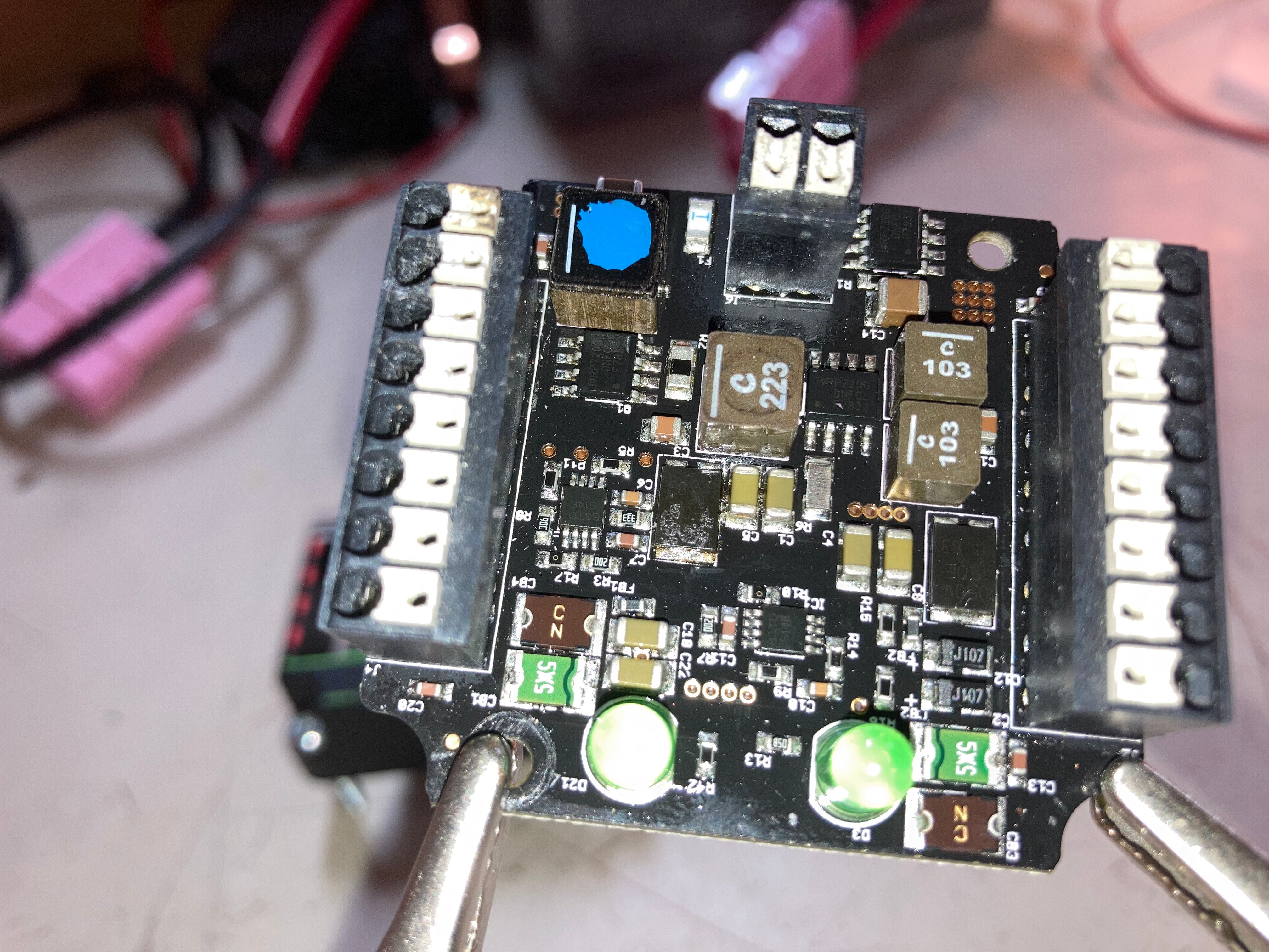

The image I gave is the inside of the vrm. Can you see any burn marks? I’m not a pro on these and I really need to know if its frayed or not…

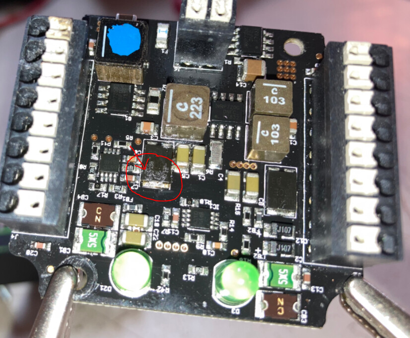

However, since you’ve opened up the VRM, what I show in the circle there is concerning. It appears that chip is pretty damaged, so I would dare say this VRM is not usable.
ETA: I sent a close up of that chip to a friend who does chip replacement and diagnosis for circuit boards, and he said the chip definitely overheated and is damaged.

In my opinion, no, it’s not worth fixing. They aren’t so expensive nor are they something that’s (usually) difficult to find, so replacing it would be the better option. Besides, you can’t know if any other components were damaged besides that one. Chances are quite good that one or more of the surface mount resistors are fried too.
