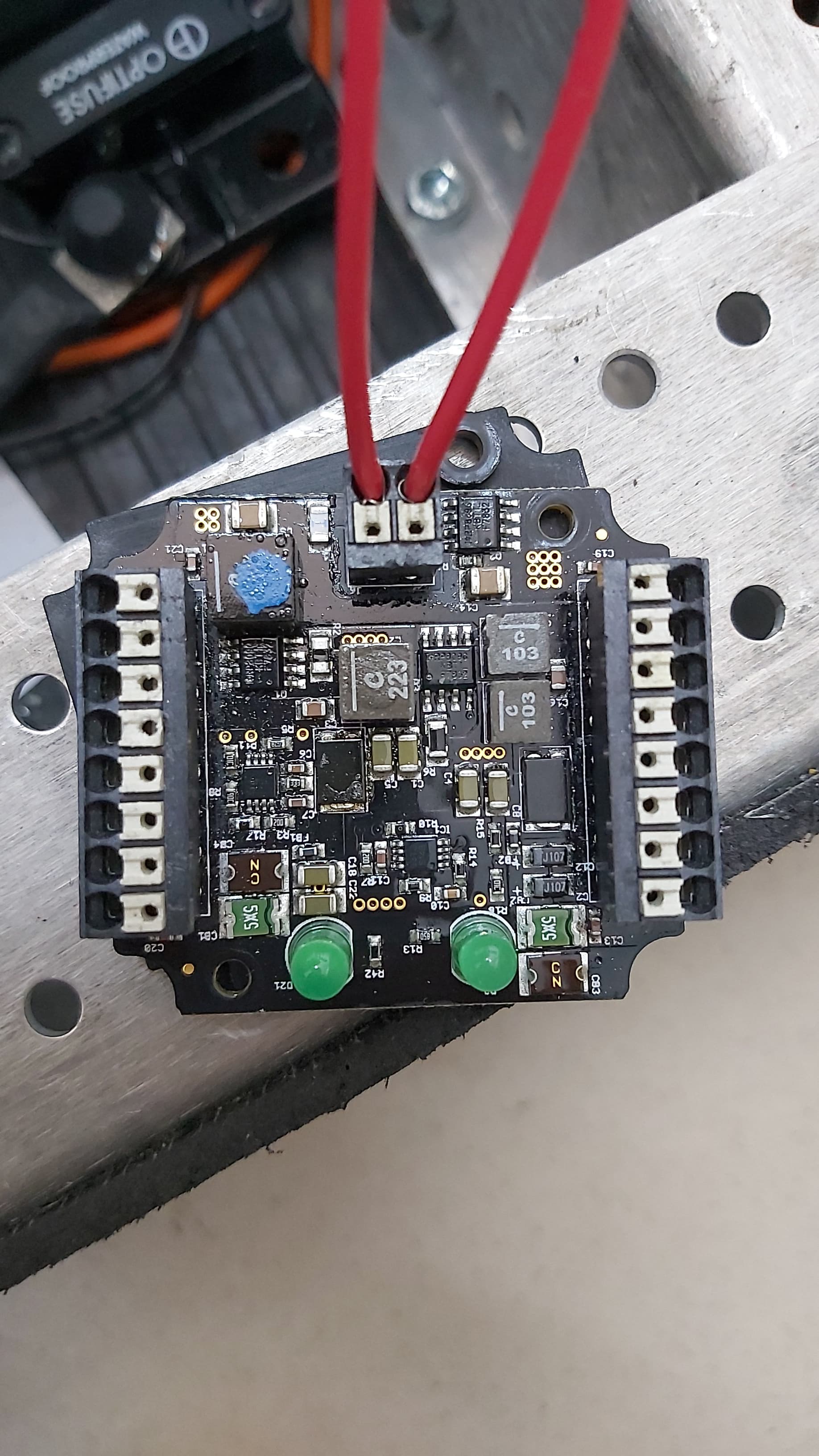

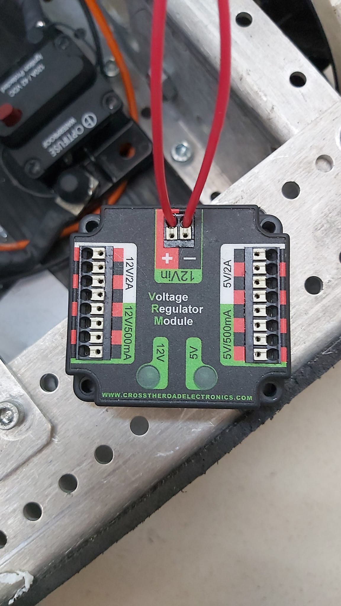

Hi everyone,
One of the VRM’s isn’t working. The leds is not working and they plugged 12v fan but it isn’t work as well. And also there isn’t over heated area on vrm.

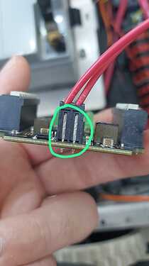

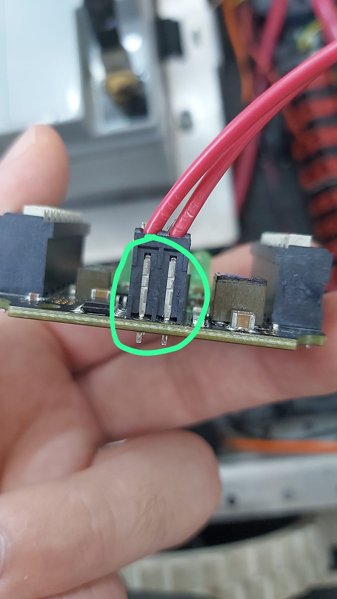

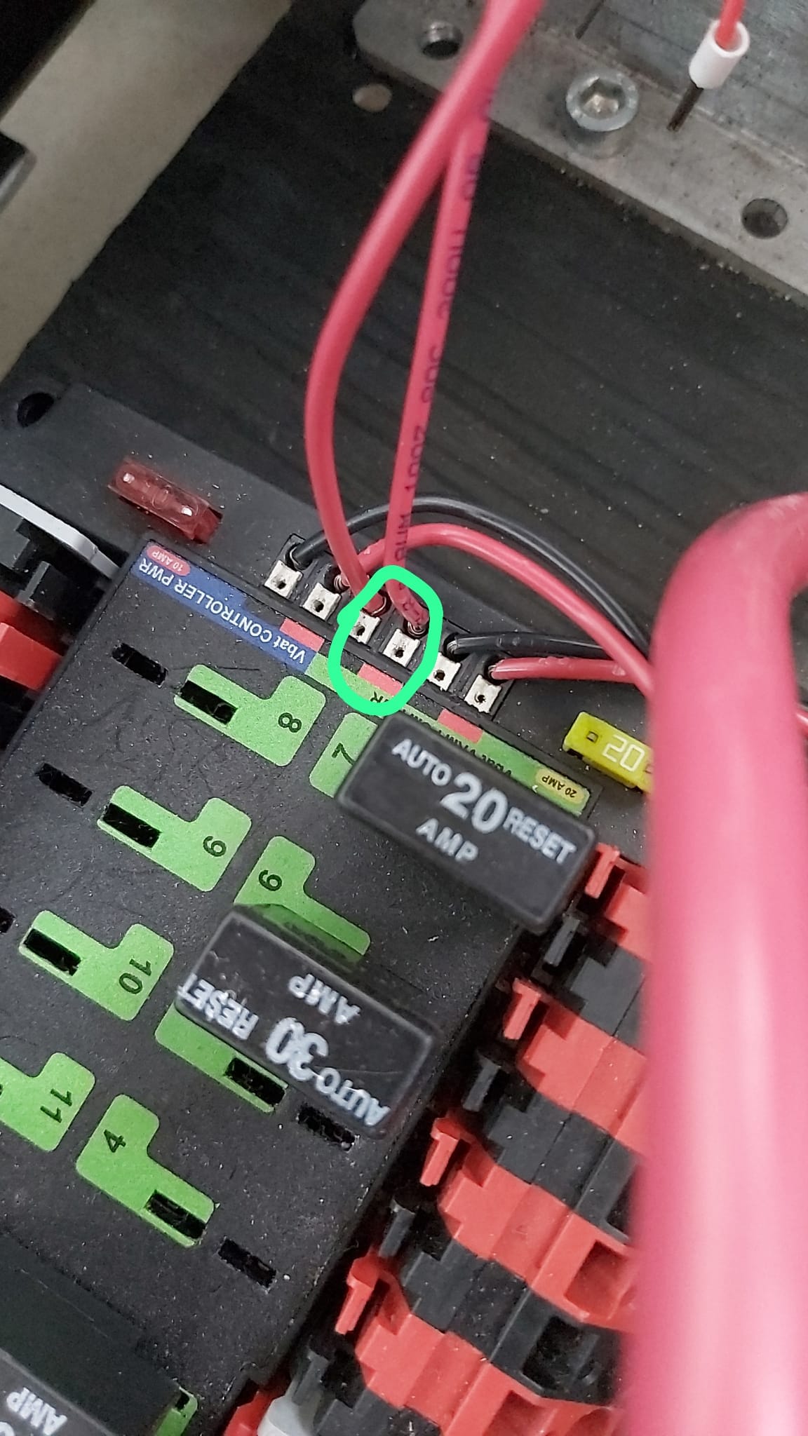

They plugged this pins in PDP.
Inside of the VRM;
They checked positive and negative pins on VRM ass well. It is working normally 12v.

If you don’t have power at the leads, check the pdp outputs for power, then check the fuses, do the other items plugged into the low amp ports on your pdp work?
Please start by using the correctly colored wires. There’s no way for us to tell if you cross wired it if the wires are the same color, and there’s a very real possibility that you mis-wired it without meaning to since the wires are the same.
After that, verify you have +12 at the end of the wires, measuring red to black. Then plug in the VRM.
Start doing things right from the very start - otherwise you’ll get all the way to the end and realize it’s a nightmare to troubleshoot.
Yes I can’t get any voltage on leads. I checked fuses and wiring. And other devices are working good.
Yeah. you are right wires can’t be same color but I don’t have black cable so I used red cable. Pdp to Vrm Cables at +12V.
Check the connection to the pdp make sure you have it in the clamping connector. If it is in good try the other low amp ports, or even a breaker port, you may have a bad port in your pdp

If you measured +12V on the sides of the connector (as shown in your photo), and if the polarity isn’t backwards, and if the LEDs are not coming on, the VRM may be bad. Check to be sure there is nothing shorting any of the pins on the VRM, double check the polarity, and you can also measure any voltage on the output terminals, in case something is wrong with the LEDs.

I’ll just mention that according to the User Guide, the VRM has reverse polarity protection. So in theory you should be able to swap the wires and not kill it. Not sure how well this works in practice though.
