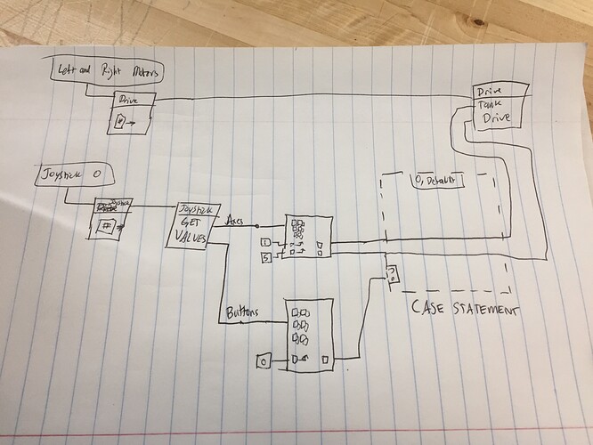

edit: give me 10 mins I will sketch it out. it’ll be a really rough sketch that assumes you already have regular tank drive working

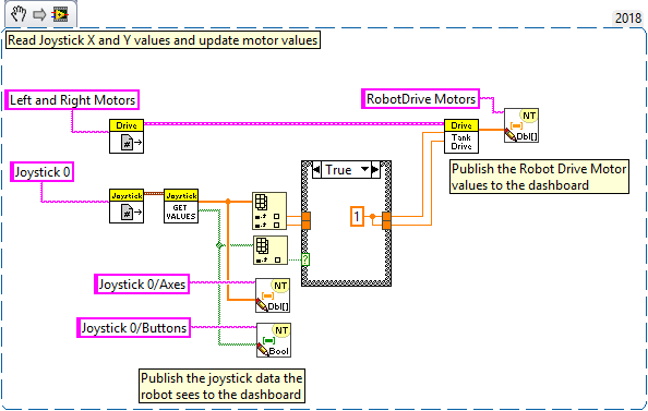

Here is what you originally asked for.
Drive%20Full%20Power

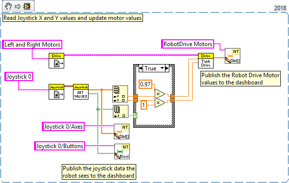

Here is the percent reduction of a side. I would personally recommending figuring out which side is “stronger” and reduce it assuming that it applies linerally. For example if you are turning to the left than your right is “stronger” so if you make your right go at 97% power you will drive straight.
Percent%20Reduction%20on%20a%20Side

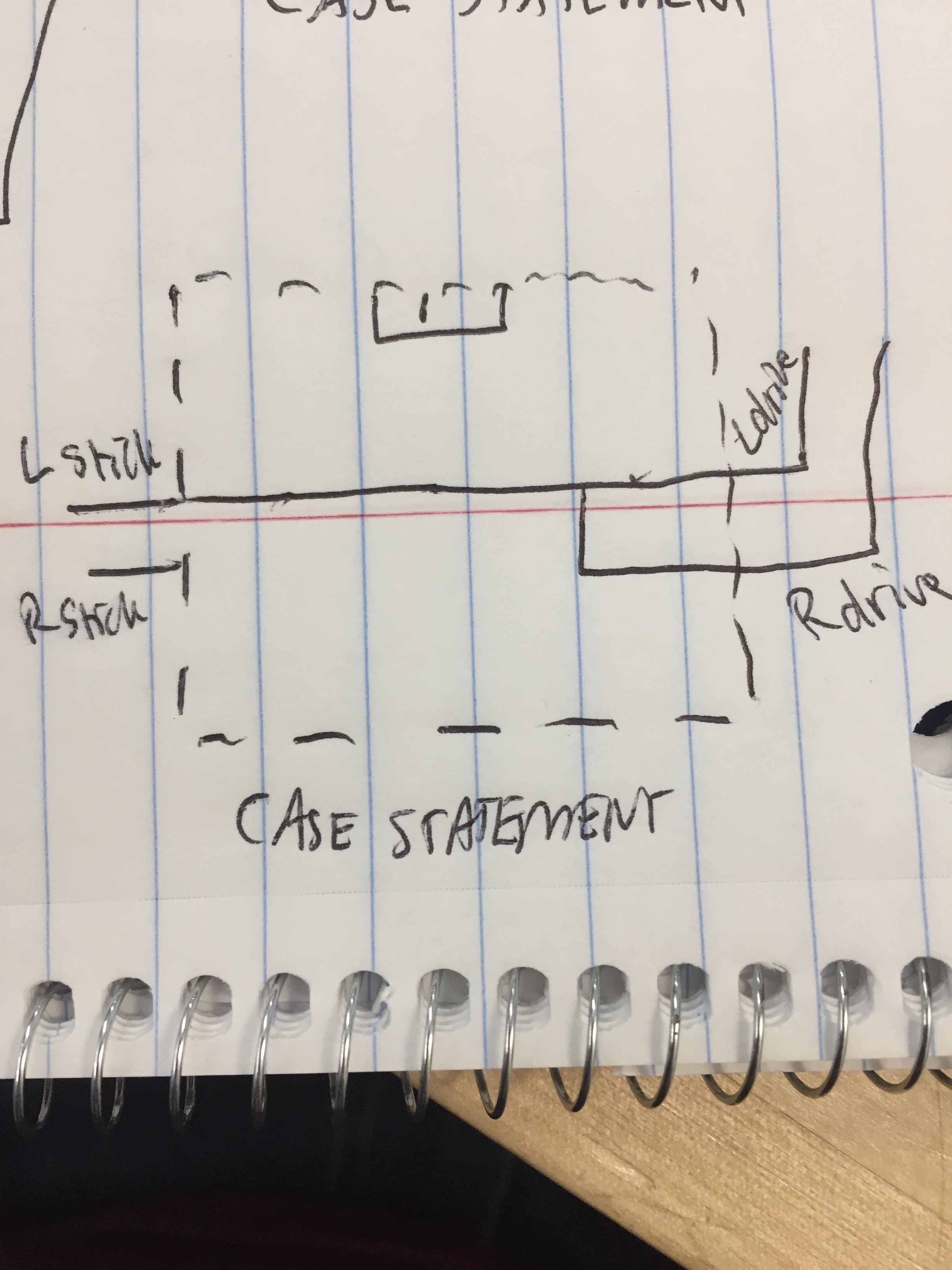

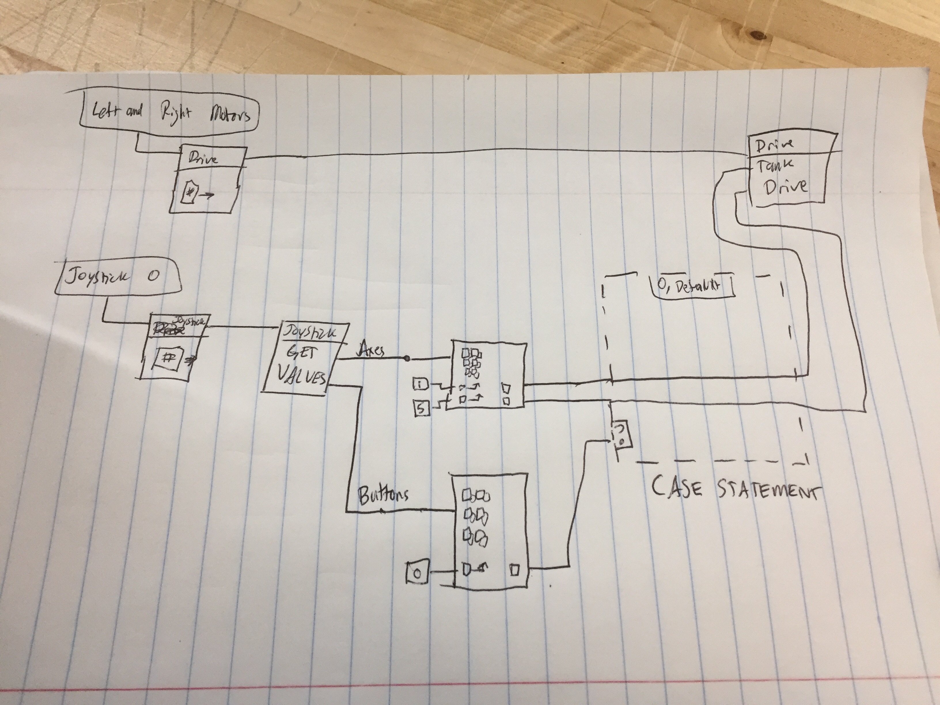

Ok so your main drive logic would be like this:
So when the button is not pressed (case statement in 0 mode) it would pass through the stick values to the left and right sides of the drivetrain. When the button is pressed (case statement in 1 mode) it should pass the left stick through to both sides of the drivetrain.
