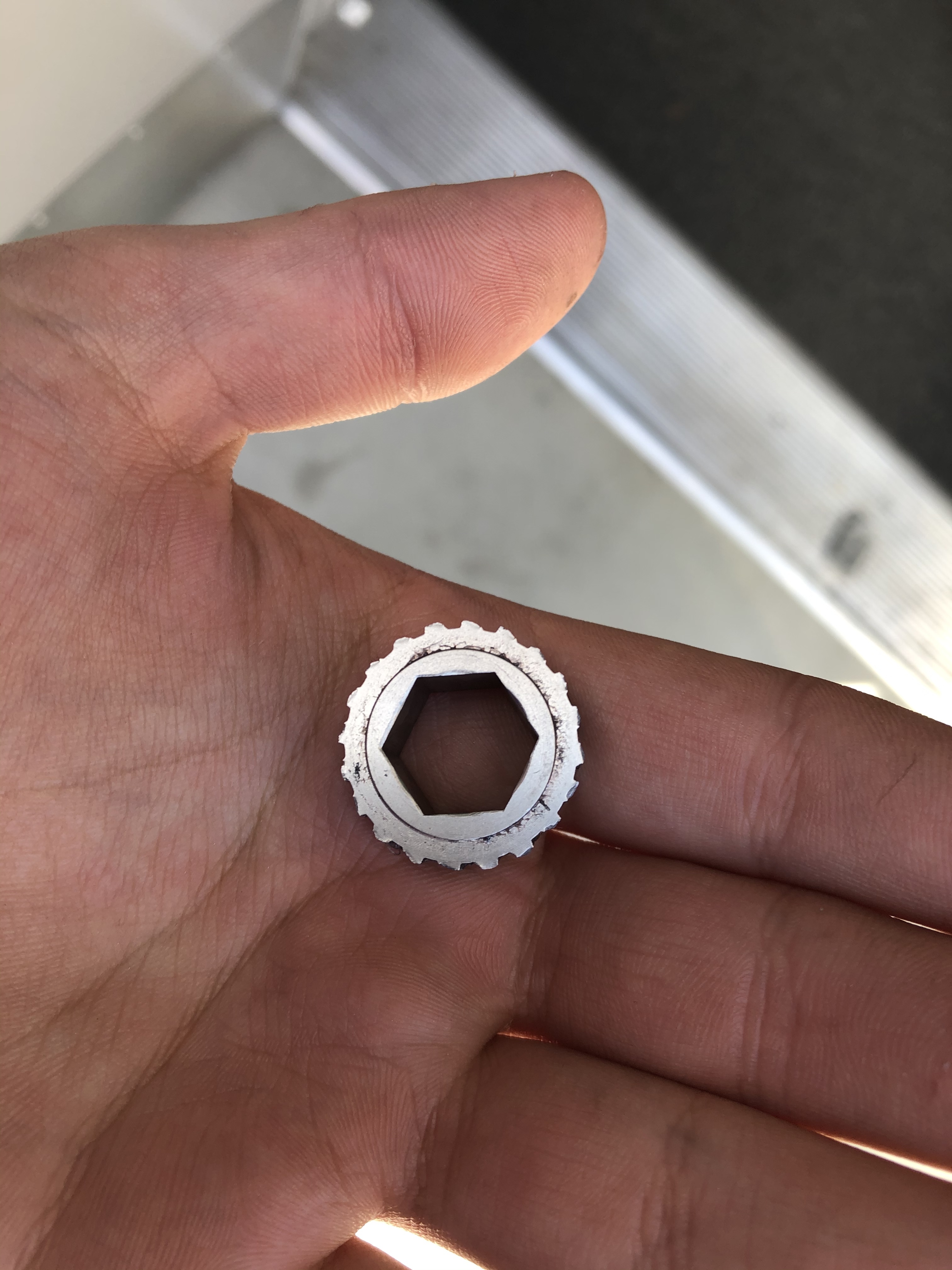

If anyone is using 2 falcon 500s in a gearbox and has aluminum gearing I highly recommend swapping them out for steel gears. At the la regional my team 4501 fully stripped 2 20dp 20t aluminum spur gears. At the same event 2637 using aluminum gears in a dual falcon 500 gearbox also stripped their 14t gear. It may only be for the small gears but if you have the weight I highly recommend swapping all the gearing out. If not, at least do it for the small gears. WCP is currently in stock in most steel gearing. We checked before our last match as this had just happened on the other side of our gearbox and the gear was fine. This is what it looked like after that match.
Some people asked for gearing specifics. We are using the wcp ss flipped gearboxes with 2 falcons and 10t steel falcon pinions. Gearing is 10:60 20:36 32:34 the 20t is the one that shredded

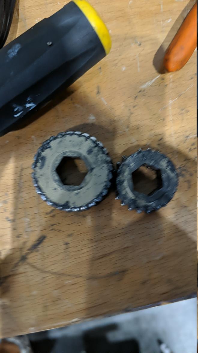

Same thing happening here. The bumps are really hard on robots. We broke both a 22:28 pair and a 20:30 pair.

We had gears end up looking like that when they didn’t get greased years ago with Cims.

@ChymeRu, I would most suspect either 1) inadequate grease/lubrication or 2) mediocre gear mesh. Which gears failed? If it’s in the final stage of your gearing, I’d suspect it is some combination of too much torque/power (for the strength of the gear) and the above 2 possibilities… Obviously you’d want to know if your motors were fighting each other, but I expect you’d see other problems first and you’d probably lose teeth on your motor pinions first.
In a high torque and speed application like the drivetrain - particularly with likelihood of high dynamic loading - a relatively small gear wear or tooth damage could quickly propagate to fully stripped teeth.
For the second part that is why we were rather confused. It’s In the middle stage of three and it’s in the wcp ss flipped gearbox. The falcon pinions are steel so even if that’s where most of the old is I doubt they would snap before another aluminum gear. The gearing in our gearbox is 10:60, 20:36, 32:34
