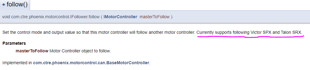

The general warning: The .follow() method is not supported by TalonFX.
Problem Manifestation
Within a gear box containing 2 falcons (in this case for a drive pod), one of the two motors will get hot, while the other will remain cool. We believe this is due to the leader trying to drive while the follower is “along for the ride.” Note, even though it’s not matching the leader, our testing showed the follower will still blink the same corresponding red or green blink code to match the leader. This problem will not appear unless you can drive your robot around; there isn’t enough resistance by driving it on blocks for the issue to manifest.
There have been threads that discussed this in the past, such as this one and this one, but neither explicitly state the .follow method as the issue.
Upon further research, it can be found in the CTRE API Docs that .follow() currently supports following for VictorSPX and TalonFX

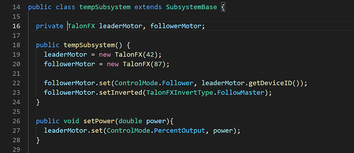

CTRE provides TalonFXControlMode.Follower, which lets a motor be put into follower mode. Here is a short example provided below.
This method is the currently supported way, and should be used instead of .follow().
Note 2 things:
  1. The set method takes in a double, so you must provide it with the TalonFX device id of the motor you wish to follow. This differs from .follow(), where you provided it the TalonFX object itself.
  2. You only have to set this once. If you use the set function on the follower motor again, it will detach itself from the leader motor.

Kinda confused…I emailed CTRE about this same question and was told its just that the API doc is not up to date.
@TytanRock can we get a final verdict on this?
Yeah, I have a hard time believing the Falcon500/TalonFX has been out for a couple years without having .follow() properly implemented. As a software engineer, I can confidently state that documentation seems to always be outdated the moment it’s published.
I also don’t quite understand the issue. If it works fine on blocks, then follower mode (via .follow()) is working just fine. Has this been tested with 2 motors outside of a gearbox? The presence/absence of a mechanical link should not matter when testing that functionality. Now, if there’s extra resistance in the gearbox (improper tolerances, no grease, etc), that could certainly cause issues.
This is symptomatic of a bad documentation process. WPILib docs are built and published automatically from the current source, and we don’t accept PRs that do not update the documentation. There are still some lingering patches from the pre-open-source days that aren’t totally mapped yet, but progress can be made.
If I right-click on the follow() call to open its definition, it eventually ends up calling set(ControlMode.Follower, id), which suggests that the javadoc is simply outdated.
Getting the same LED patterns on the primary motor and the follower also suggests that the following basically works. There must be some other, mechanical explanation for the different workload of the two motors if one gets way hotter than the other.
Can you please verify that the leader motor is heating up and not the follower?
I ran into a similar issue back in 2019 using SRXs, where a follower controller was heating up unreasonably and as a result being thermal throttled and the motor plugged into it would barely spin.
Follow mode definitely works for TalonFX. I just tested taking two falcons and having one follow the other using the .follow API.
The API documentation doesn’t cover TalonFX because it got missed when we added TalonFX support, I’ve added a tracker to update it in the next release.

I also want to note your solution snippet won’t work as-is, because the follower motor is ID 87, when we only support IDs up to 62. In addition, the follower control mode is sufficient for same device type controllers such as Talons to Talons and Victors to Victors, but will not work for inter-device following such as Victors to Talons. Just something to keep in mind if you’re using the suggested workaround.
