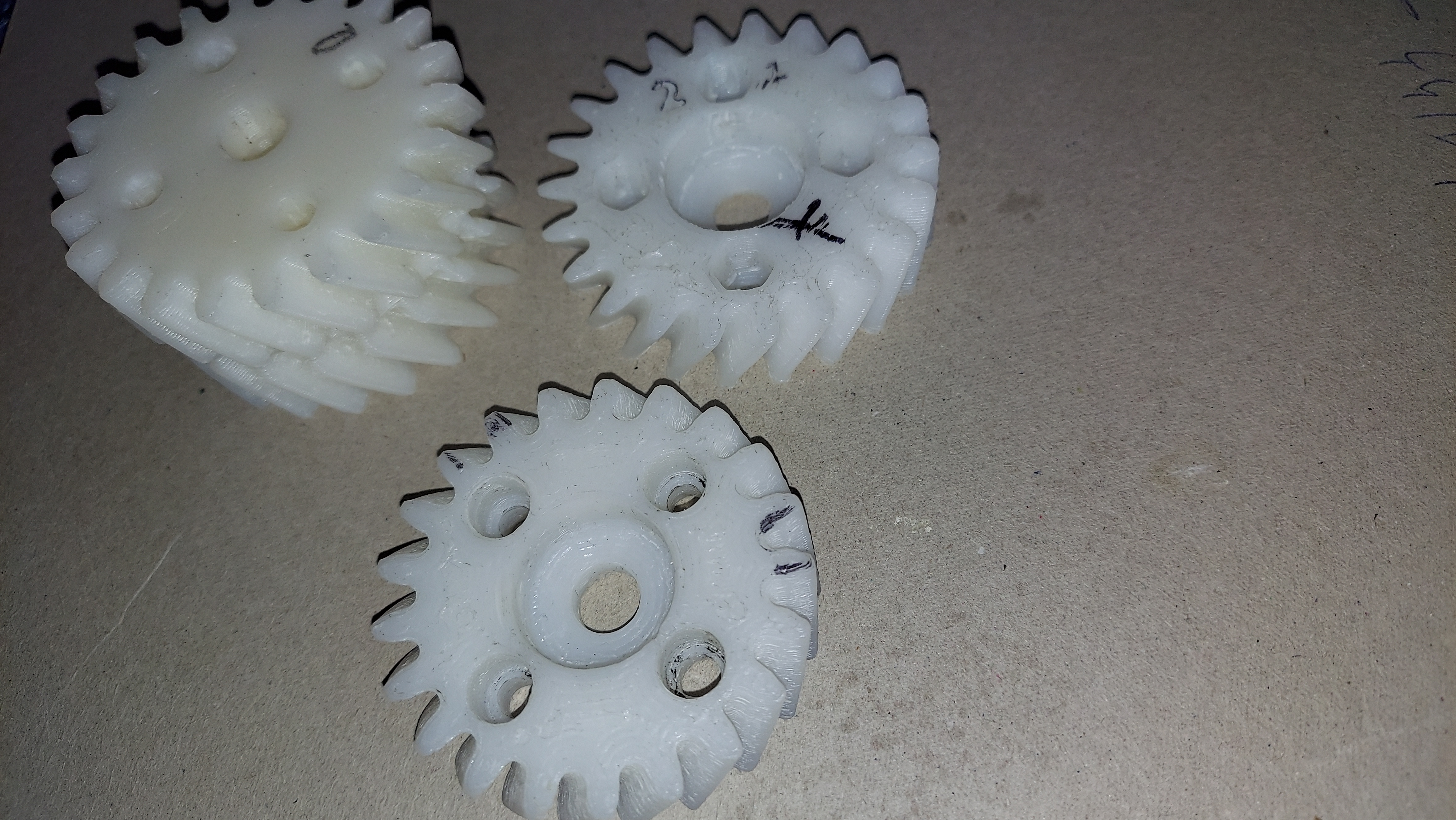

So each P2 except the one in the 0 position needs to be turned .2619 teeth or (360/22) * .2619 =4.2857 degrees Hence making the need of designing 4 individual stacks and making sure the gears are in the right position.

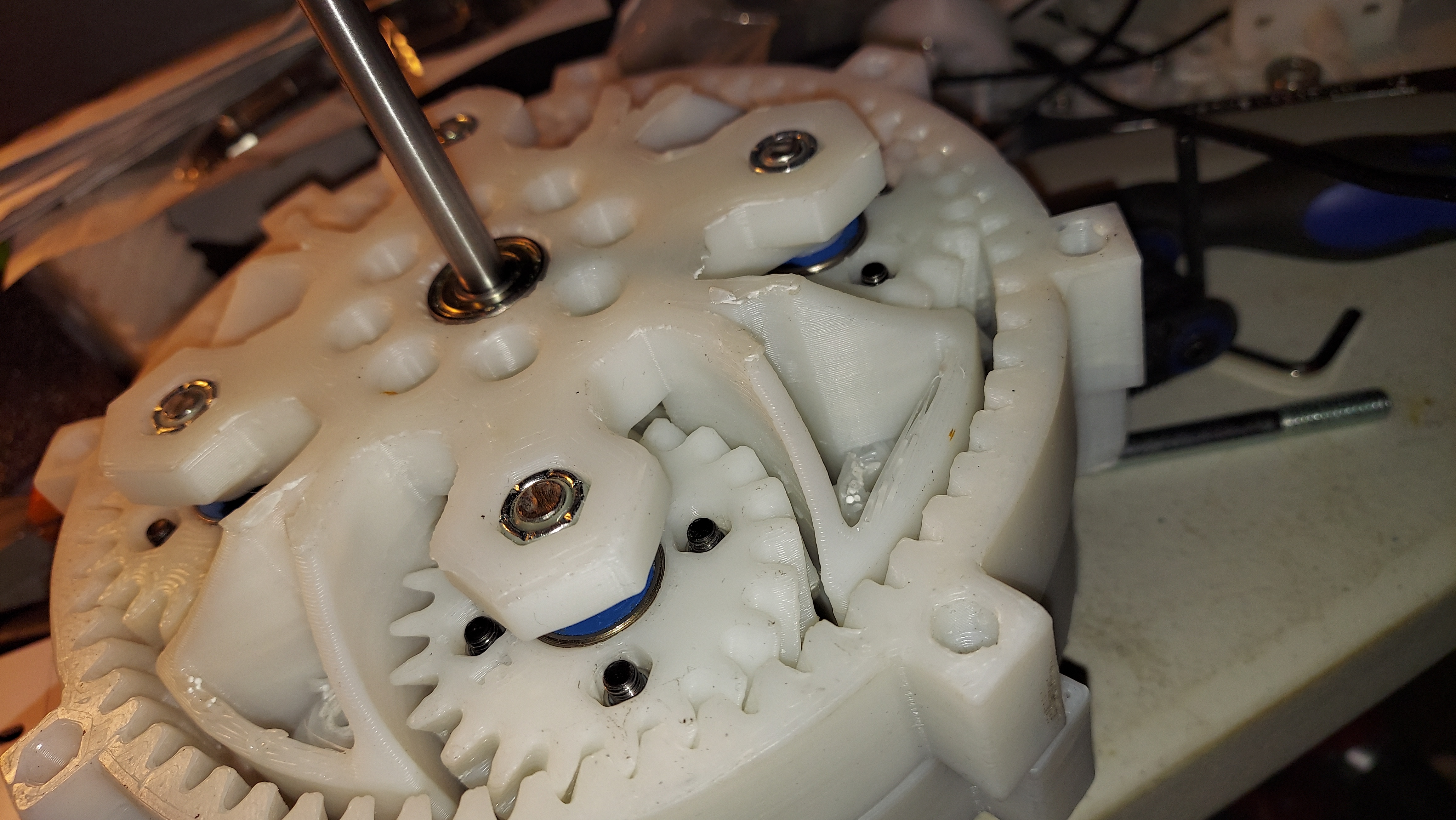

To assemble the stacks they were broken in 3 parts
And then bolted together In cad a single stack was designed first and then split into the 3 pieces to make sure all holes line up Furthermore the bolts help give the plastic more rigidity .
S2 in theory is not necessary for the system to work but at R2 is the output and will take some load S2 helps P2 to stay aligned and transfers that load through the bearing to the central shaft. Some more "Unloading was done by tying the planet carrier into the ring holder via “bearing wheels” on the input side
And tying the output side planet holder to the shaft so to not only guarantee planet to planet position but also planet to center axle position
And then tying the ring gear R2 Also back to the center axle to transfer most of the load of the belt drive there (except of course the radial one from being a compound planetary gear system) and allowing fot the mount of a gear output in line with the central shaft

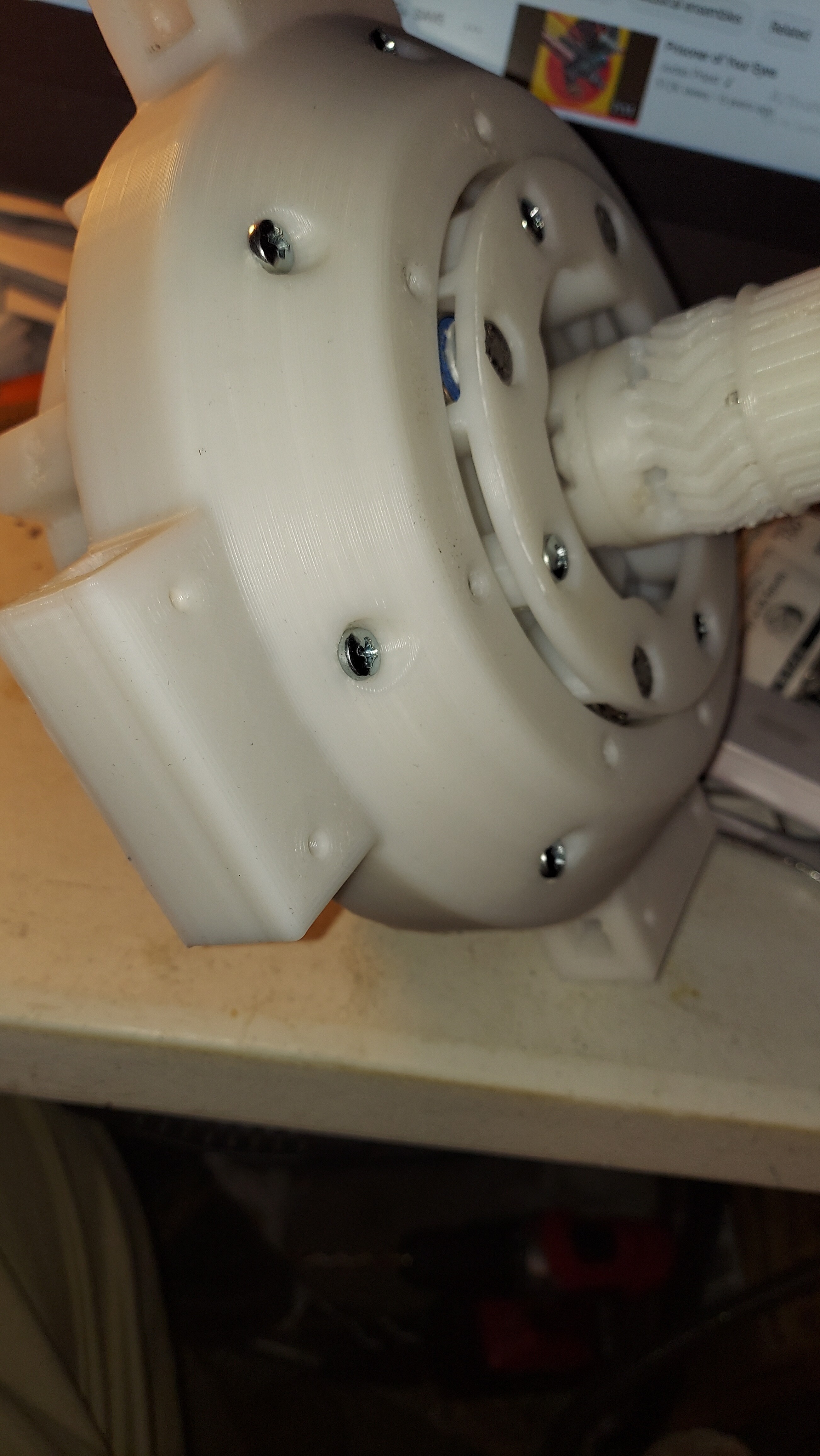

The 3 CIM Motors will mount to this
Also allowing to skin it and fully enclose the input side. On the output side I will most likely skin the Wheel that connects the ring to the shaft to keep dirt out and grease in leaving a small gap between R1 and R2 that probably will get a TPU gasket (not designed yet)
