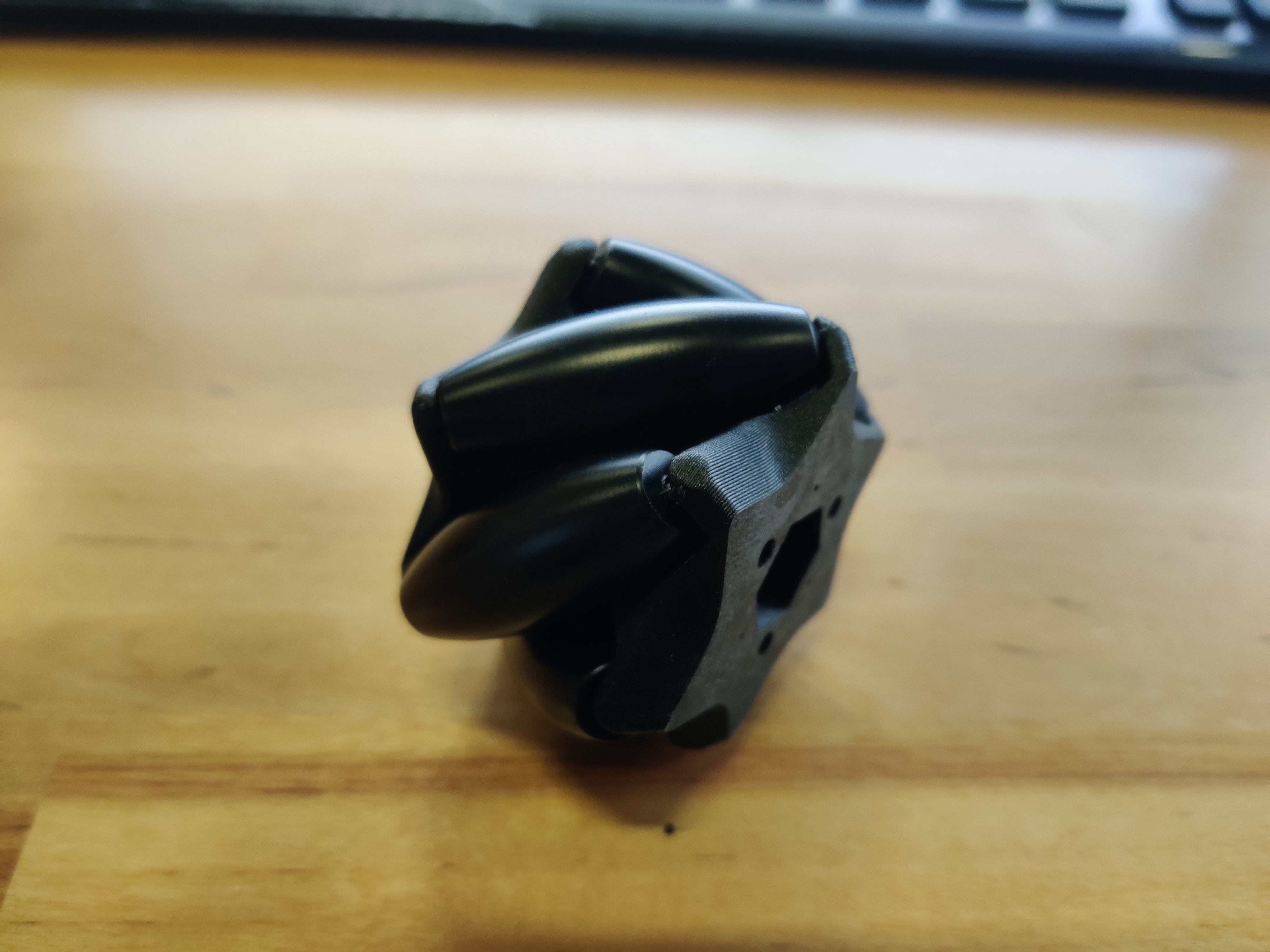

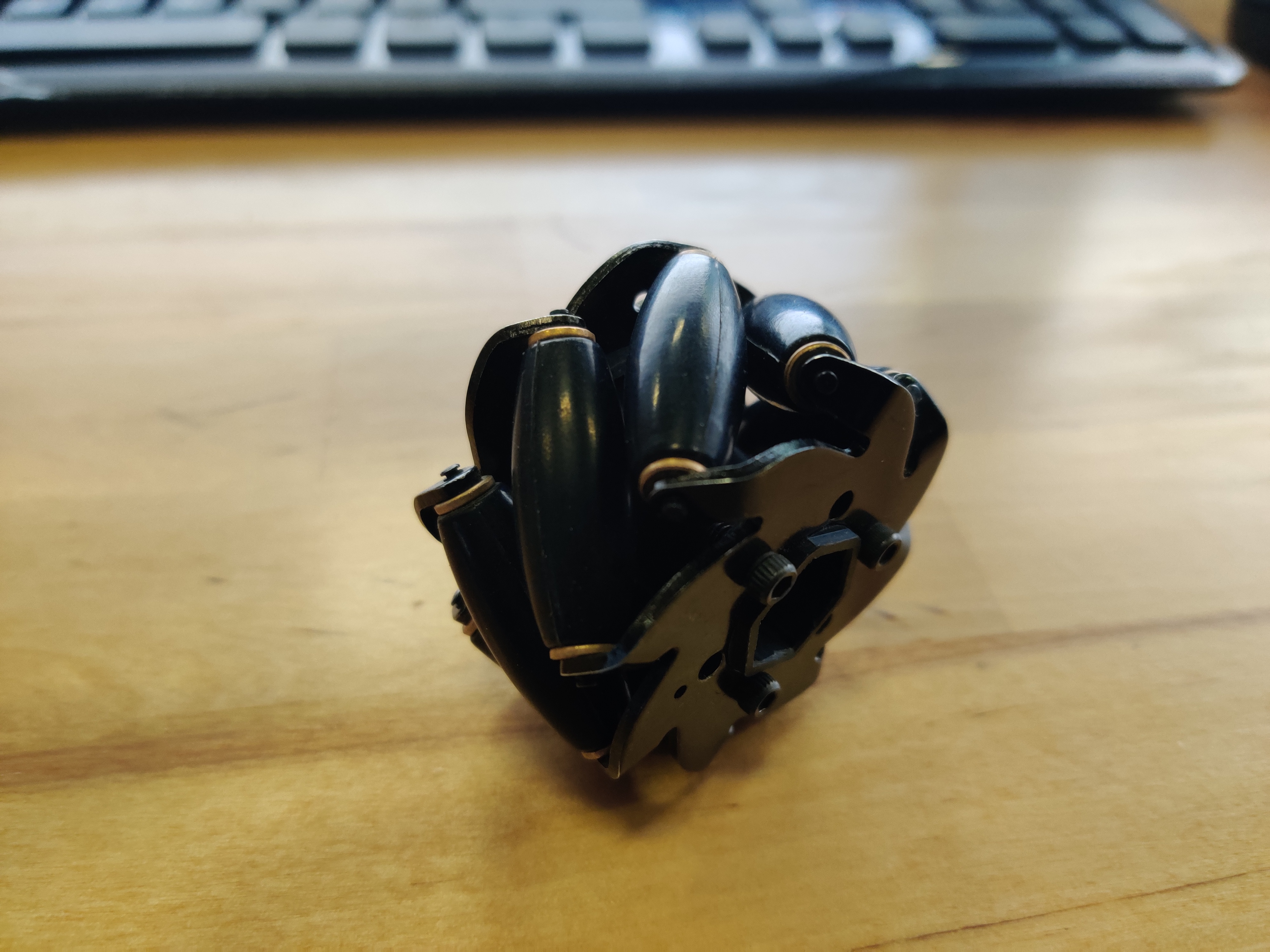

You probably noticed a 2" wheel that looks like the Nutron 2" Mecanum. You’re not wrong to believe this, we have been working with 125 to create a v2 of their v1 mecanum to be injection molded. We ran out of time this year to get the item produced and I have been kicking myself about it the past week. @Brandon_Holley and crew have worked with me to create an FDM version from the injection part to be sold in the meantime. We’ve always wanted the perfect mecanum and believe that 125 has one the best designs for a True 2" mecanum. We used a flat roller version in 2017 and hated it/created to much of a chopping action vs rolling. Below are pictures of mecanum’s from Left to Right:
(125v1 (FDM), 125 v2 (FDM), WCP Metal:
