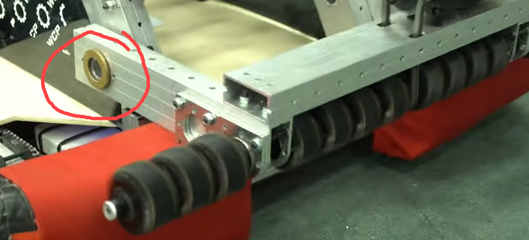

Curious as to what bushing / pivot use on the front intake arm?
How did you retract this arm back in starting position?
@R.C should have used the plastic bushing shakes head
Yes… We got real lazy :frowning:
