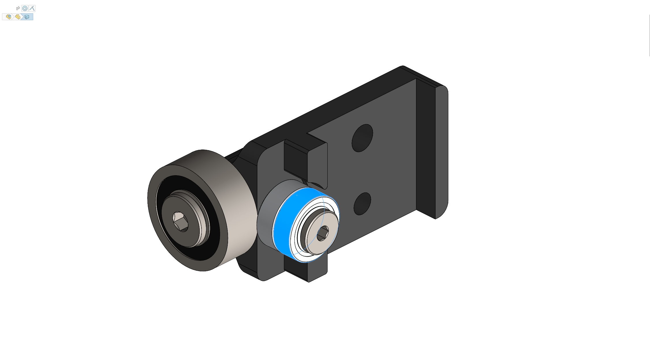

Upgraded Clamping Block - The block now has a backwards compatible option to add a second bearing, we saw in 2022 that the .25” ID x .5” OD & 6mm x 12mm bearings did not handle dynamic loading very well. On our Telescope products we have upgrades planned that will fix any breakage due to dynamic loading of the small bearing only. Last year we also got some feedback that the .5” bearing also broke after 60+ hangs on inline elevator block design but no issues by going to .25” ID x .625” OD or .25” ID x .75” OD. So we have added an extended shoulder bolt to allow for a higher loading option.
Inline Clamping Block - We have also added another block option that mounts directly to our tube plugs. This block has some cool features
  • Direct mount to our tube plugs
  • Cbore for shoulder bolts to help with loading
  • Double small bearing stackup (4x) to prevent any breaking

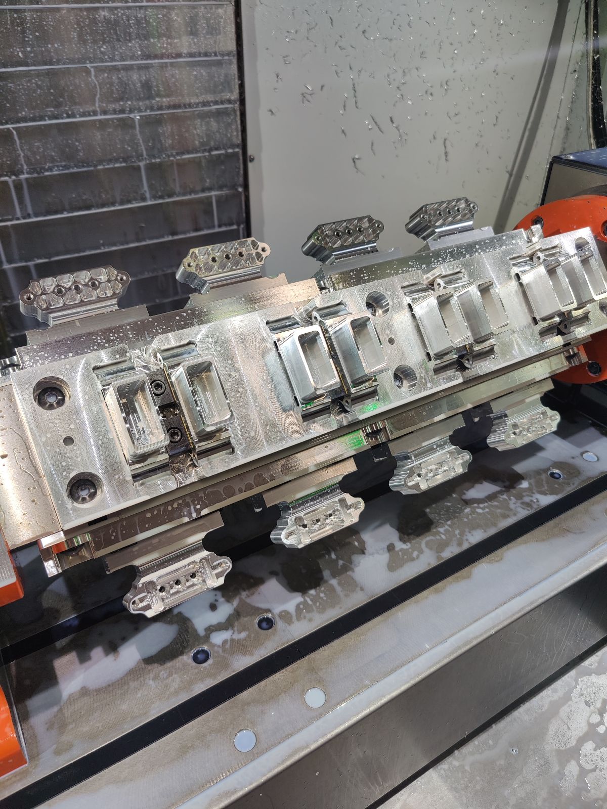

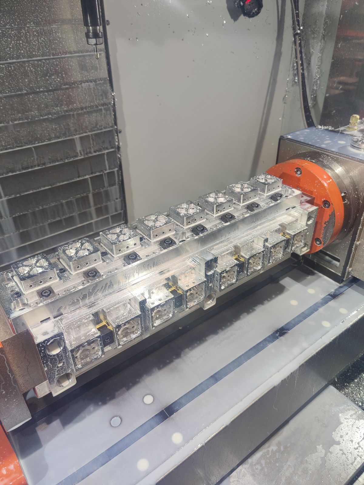

For this season the GreyT elevator will come stock with the side clamping blocks and will mostly change to the inline clamping block as the standard option for the GreyT kit. These products are made here locally on a pallet system so we can keep up with demand a lot easier. Some 4th axis pictures below for fun!

Awesome! Martin makes a good trunnion table. with the 4th axis it really does expand capabilities. perfect for a lot of production parts like these.
Question about the elevators and bearing blocks. The GreyT Cascade looks great. However the students and I are debating on the pros and Cons of building our own with the inline bearing blocks vs getting a kit like the GreyT.
Why do the GreyT products not use the inline bearing blocks, and instead use the clamping blocks ( wcp-0323) ?
Also are the WCP-0199 being phased out in favor of the WCP 0897 or ar they just different options. Can they be used on the same elevator? ie one type as the top bearing block and the other as the bottom?
Tim,
After the 2022 season we spent time doing test hangs (500+) with the 1323 2022 robot to test some updates we were going to across all our products. The main thing we learned from this was the .25" x .500" and 6mm x 12mm bearing is marginal in our product use case and that we need to double up or move to one size bigger .25" x .625".
We were able to easily at that time add an additional bearing/shoulder bolt to the clamping block as shown above. So we invested more resources into mass producing that setup. At the time we didn’t have a good solution to the inline clamping block to allow 2x (4 total) bearings and bolt into our tube plugs until recently (October/November). I know the solution was so easy…
It is easier and cheaper for us to produce the inline clamping blocks as they are done on our pallet system 3 axis mill vs our 4th axis setup. So in the future we will re evaluate (next offseason) to make the inline the default or not. Fwiw my personal preference of blocks is: Inline (Large) → Clamping → Inline clamping.
If you want the option to skip the clamping blocks the easiest way to do it is:
  1. GreyT Cascade Elevator – WestCoast Products
  2. Click on “Individual components” and pick what you want.
  3. Direct link to the Kit Contents.
  4. We will be adding the cascade pulley block that Torrance linked above as a separate sku by tonight as well.
You can also copy the kit contents into excel & build your elevator. Head over to our quick order page to do this faster:
We had a similar discovery in our 2022 climber hook release mechanism. The 0.25x0.5 bearings are really weak, especially as rollers. We upgraded to 0.25" x 0.75" (R4): McMaster-Carr
