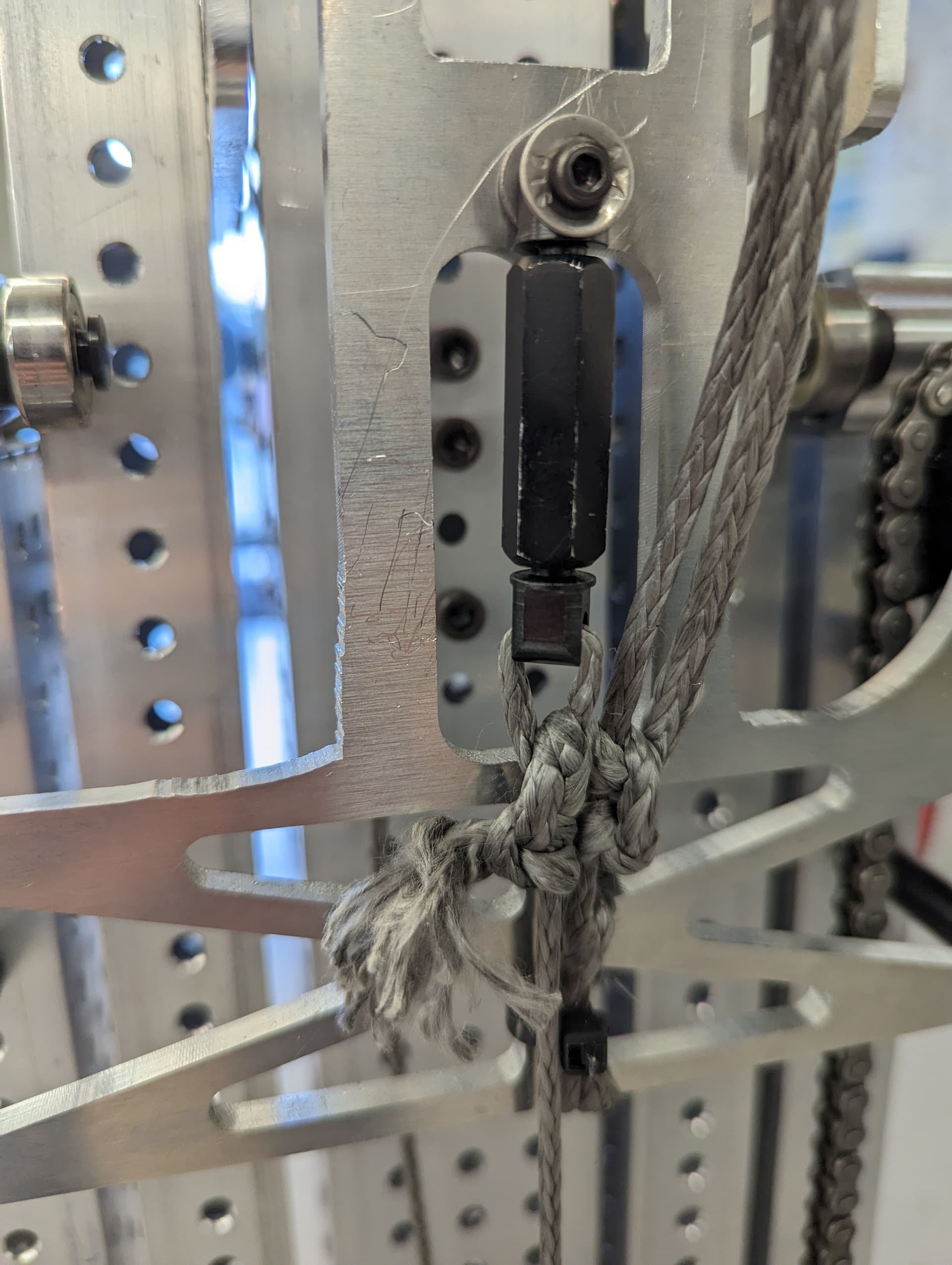

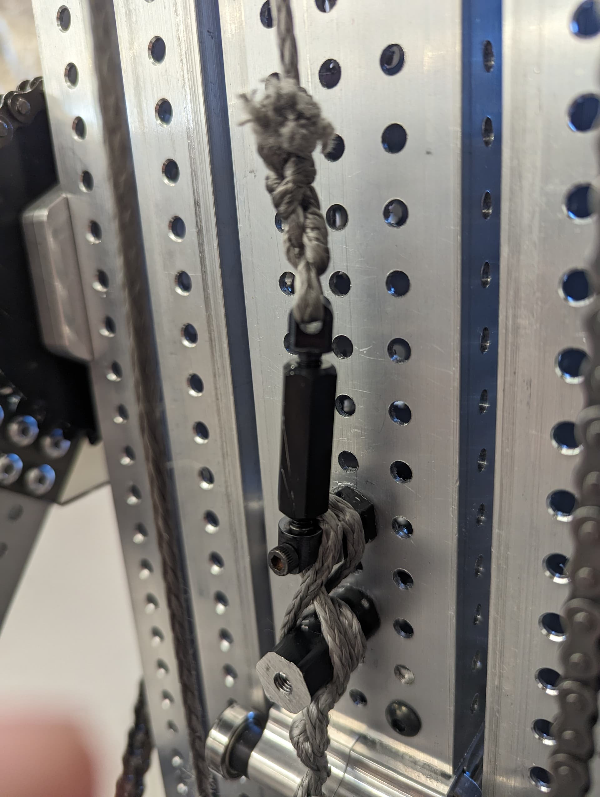

I’ll see what we’ve got tomorrow, kids did all the knots, I can barely tie my shoes. Our cable is decently tensioned throughout the entirety of travel, so I’ll get a pic of whatever we’ve got.
Here is what our turnbuckles & knots look like:
