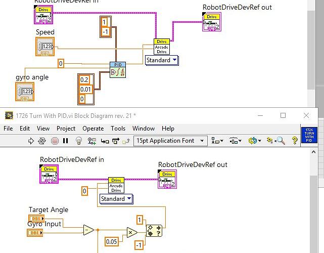

We too are using PID this year and are having some luck with it for a change.
I’ve attached a couple of images of some helper VIs we created. The drive VI uses the NI LabView PID. We didn’t have much luck controlling turns with it so we created our own PID using Proportional only. Seems to work pretty well too.
For driving we only use the encoders to tell us when to stop, the gyro works with PID to keep us going straight.
Looks nice.
Do you realize that the *In Range and Coerce *function has it’s upper limit disabled (by default)? That’s why it’s a clear box, rather than a filled box like the lower limit has.
Right-click on the function and choose Include upper limit
Wow! As many times as I’ve used it I never noticed that. Something new every day.
