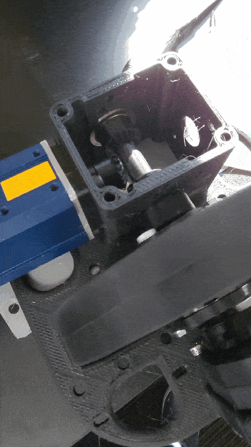

We have a falcon sport gearbox and need a 90 degree gearbox attached to it
The Versa planetary units do not show an option for Hex in and Hex out. I do not know if the Rev Ultra gear box has the 1/2" hex or the mounting pattern for the Falcon Sport. Any suggestions?
AndyMark sells a bevel gearbox designed to mount to a Sport.
I 3d printed a version of this when they were out of stock. It does work well, I had a redline motor on a sport planetary hex output gearbox, just needed some spacer plates.
Even 3d printed the gears.

Just note that this gearbox is not necessarily a good option for high torque applications like the shoulder joint of a long arm. I designed a couple of these in last year and they broke almost immediately when we tried to move the arm. This may have been partially due to poor alignment and deflection on the input shaft, but the gearbox is also designed for lower torque applications.

The MAX 90 has a socket 1/2in hex input and 10-32 clearance holes on the input plate. Adapting to the sport might take some custom 3d printed spacers and maybe cutting the sport shaft, but it should be possible.
