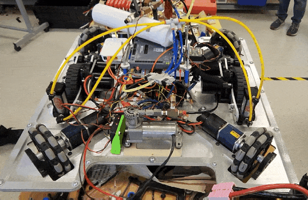

We have heard of a team running a 6 wheel 6 gear box robot we don’t know if it’s legal for actual events but would like to try it
We have heard of a team running a 6 wheel 6 gear box robot we don’t know if it’s legal for actual events but would like to try it And what’s are the odds of a double distribution panels being allowed
Any number of wheels and gearboxes are allowed as long as you don’t max out the ports on your PDP or PDH. You are only allowed one power distribution panel per robot.
If you want a 6 motor drive then two of the 3 motor transmissions will be the most efficient way to achieve that result. 1 two stage gear box will have lower frictional losses than 3, a single transmission with all motors tightly clusters will have a single smaller footprint, and assuming you are buying new transmissions likely cost less too.
If you want 6 individually driven wheels I have to ask why? With a drop center 6wd robot at best you’ll only be able to use power from 4 of the motors at any given time and in a serious pushing match you may only get any significant tractive force from two of the motors as the normal force on the center wheels is lowered and they become more likely to spin.
With a 3 motor gear box the torque from all three motors will be split between the 4 wheels on the ground with only a small amount used to overcome the friction in wheels that don’t currently have any normal force applied to them.
A flat 6 wheel does eliminate some of those problems but introduces others.

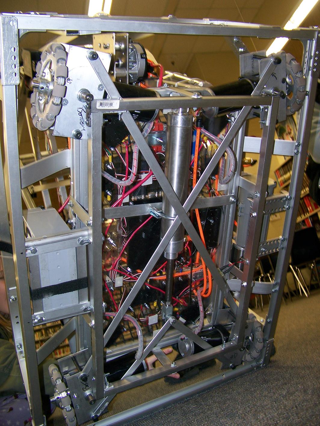

We had a 8 motor 6 gearbox drive system
Gif below
GIF-230325_140325
Also a reddit post showing more of the chassis design
We mixed NEOs to have Tank drive on a toggleable Pnuematic arm and the X drive is falcons that are adding to the tank drive or regular holonomic.
but-why
Couldn’t afford swerve! Literally that and we had done x drive for two years previously. We wanted traction tank for defense this year. So…
why-dont-we-have-both-both
Edit: we already had the falcons for x drive and the gearboxes. We could afford the new neo gearboxs from rev and 4 NEOs. New falcons were on back order for months even though we were trying to buy in November to replace our 3 year old ones. The team debated this alot and we even have a tank only practice chassis using CIMs and scrap KOP gear boxes too because of that. They went through 4 different materials and iterations of the design to end up with the final aluminum one. At Kettering we had an acrylic chassis that broke during the course of the event. We had done acrylic 2 years previously but forgot the ribs this time. It was a good learning lesson and also now is a pretty cool decoration!

But the moment it worked, the entire team was like this:
doc-brown-bttf
Totally worth it, let the students try some crazy ideas.

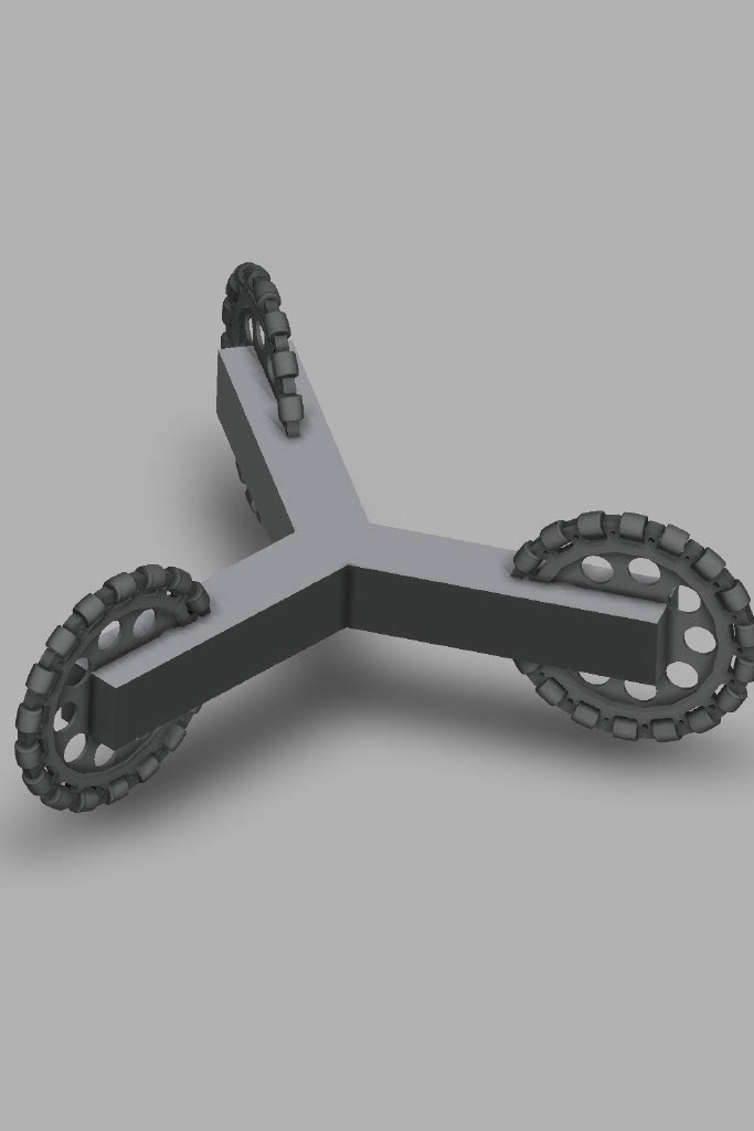

Oooo I have something for this… Killough Drive but funky! It’s an off-season idea.
It’s like kiwi but with the wheels 90° from normal. You can’t swerve nearly as well but you do get more pushing power and could maybe hold steady on a ramp better over kiwi.

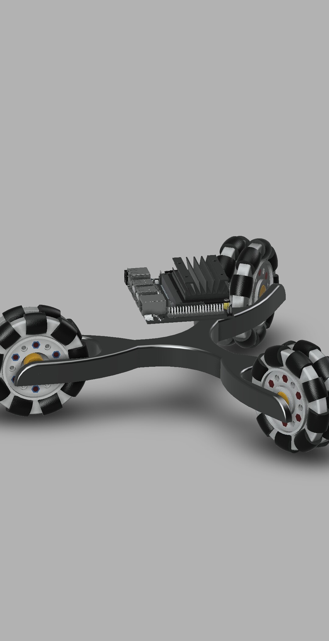

We printed a nicer version using omnis from the robot shop. The idea is to make it run from a Jetson nano possibly with arduino megas and use up our old victor SPs with pwm.
Definitely has more of a Mercedes/biohazard warning vibe with the filleting. We were able to push that one around on the floor and figure out how the wheels need to turn to do different motions. It also doesn’t turn 0 degrees nicely.
Thinking about this now, if you placed it on top of an exercise ball you essentially can drive the ball any direction…
