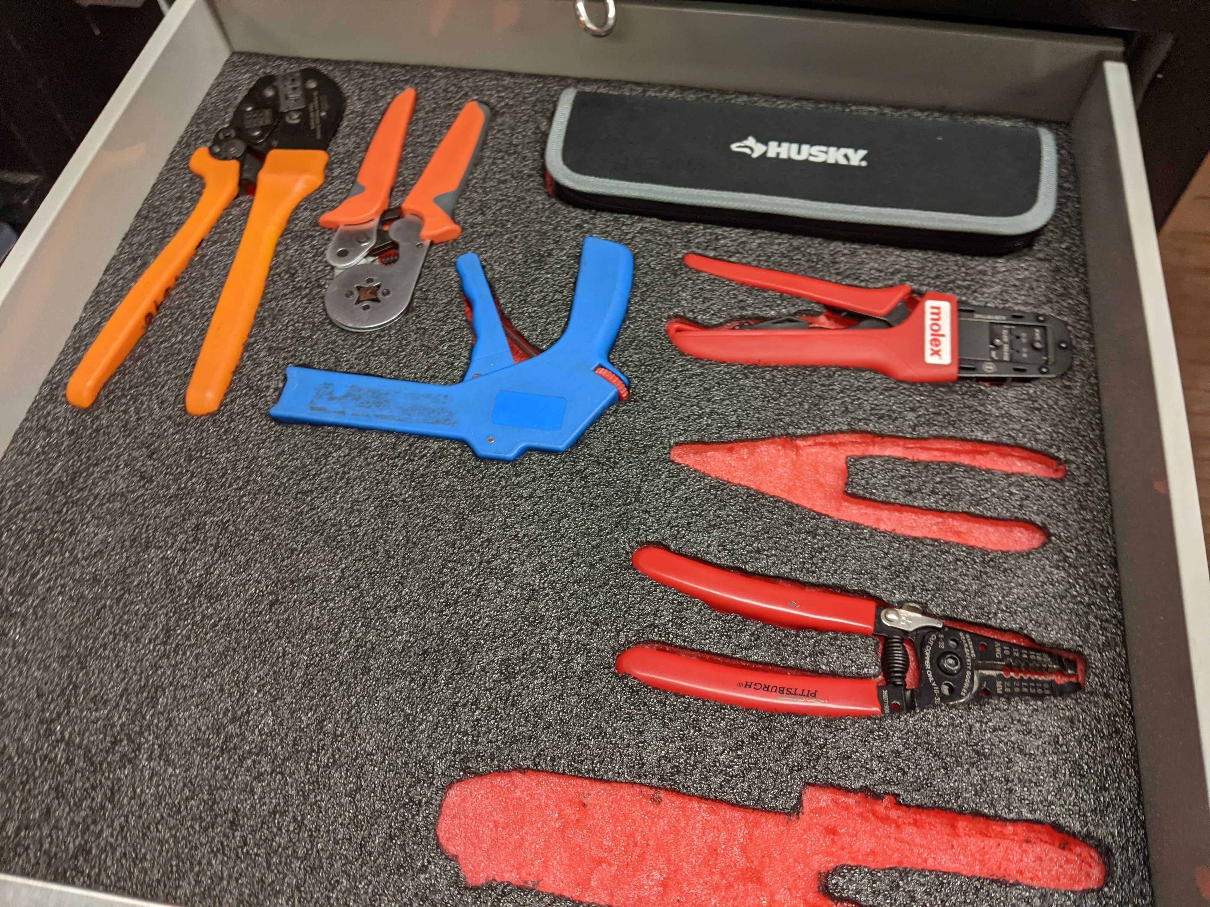

By far my biggest suggestion would be foam inserts. It’s super nice to have profiles for all your tools, so you always know which ones are there and which ones are missing. Sometimes the site is a little pricey and you have better luck on amazon.

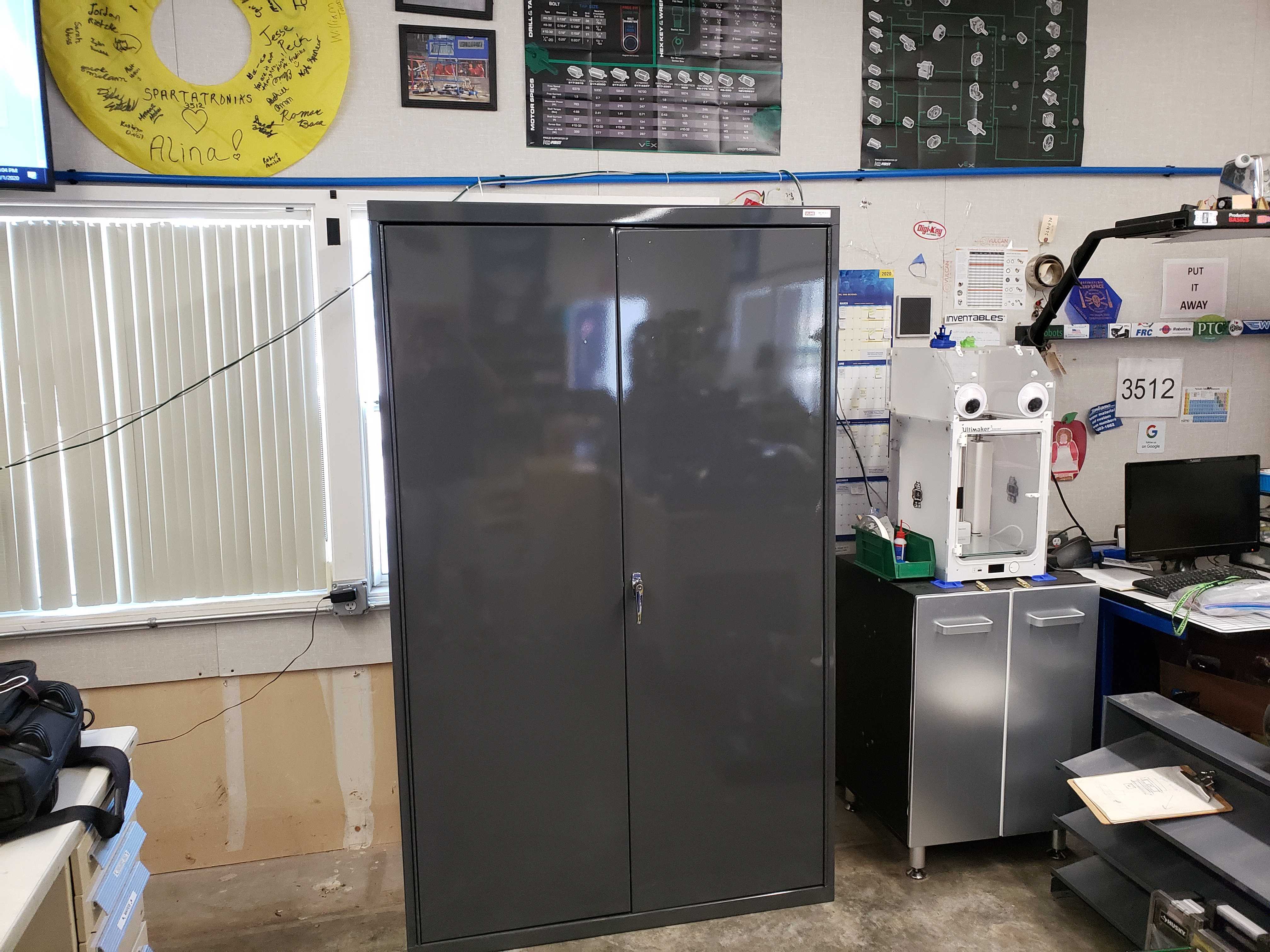

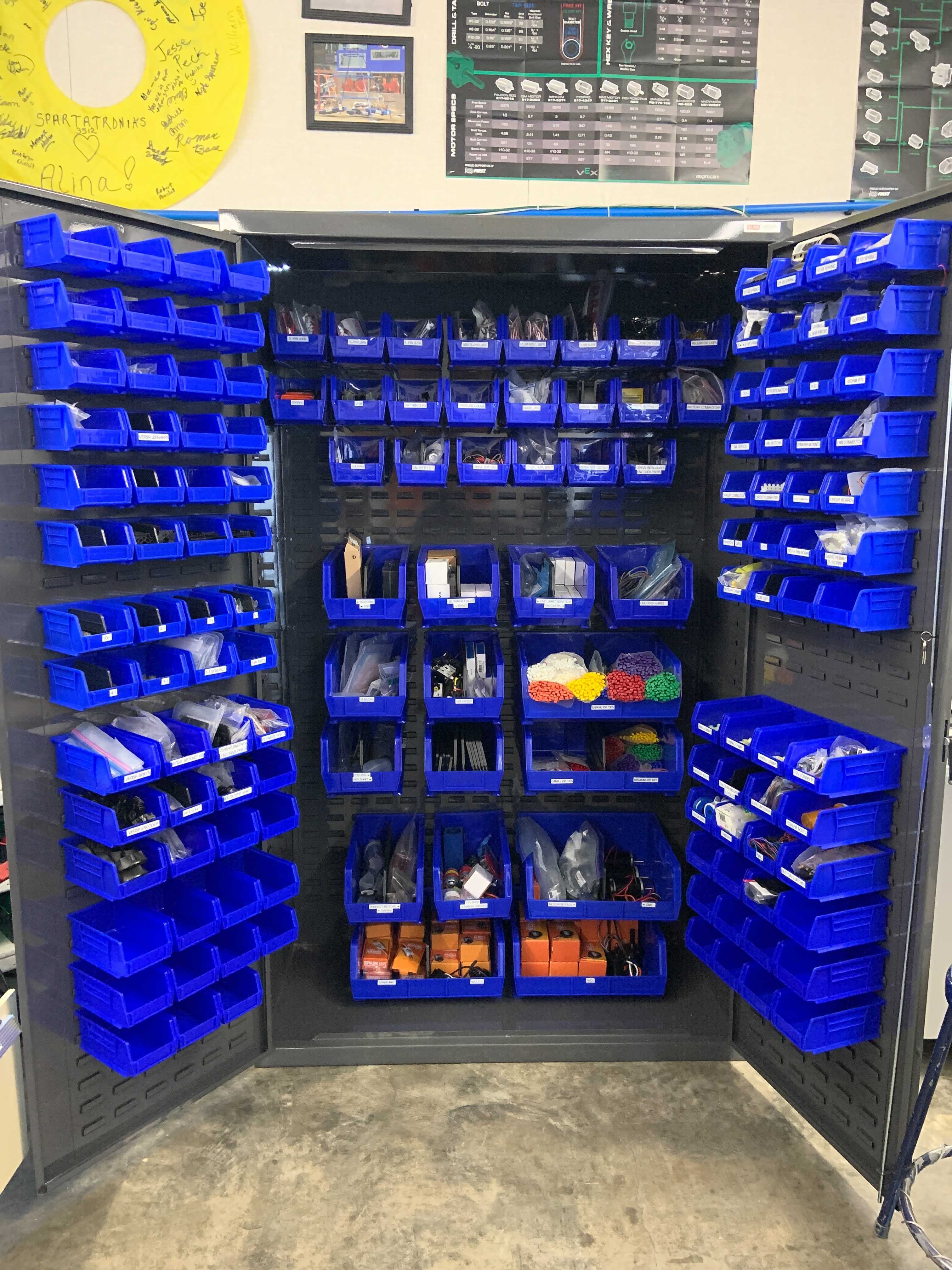

We are a HUGE fan of these cabinets. They are very customizable and hold a ton!
We bought 2, 1 for Electrical Subteam and 1 for our Mechanical Subteam. We store essentially ALL of our COTS parts in them now:

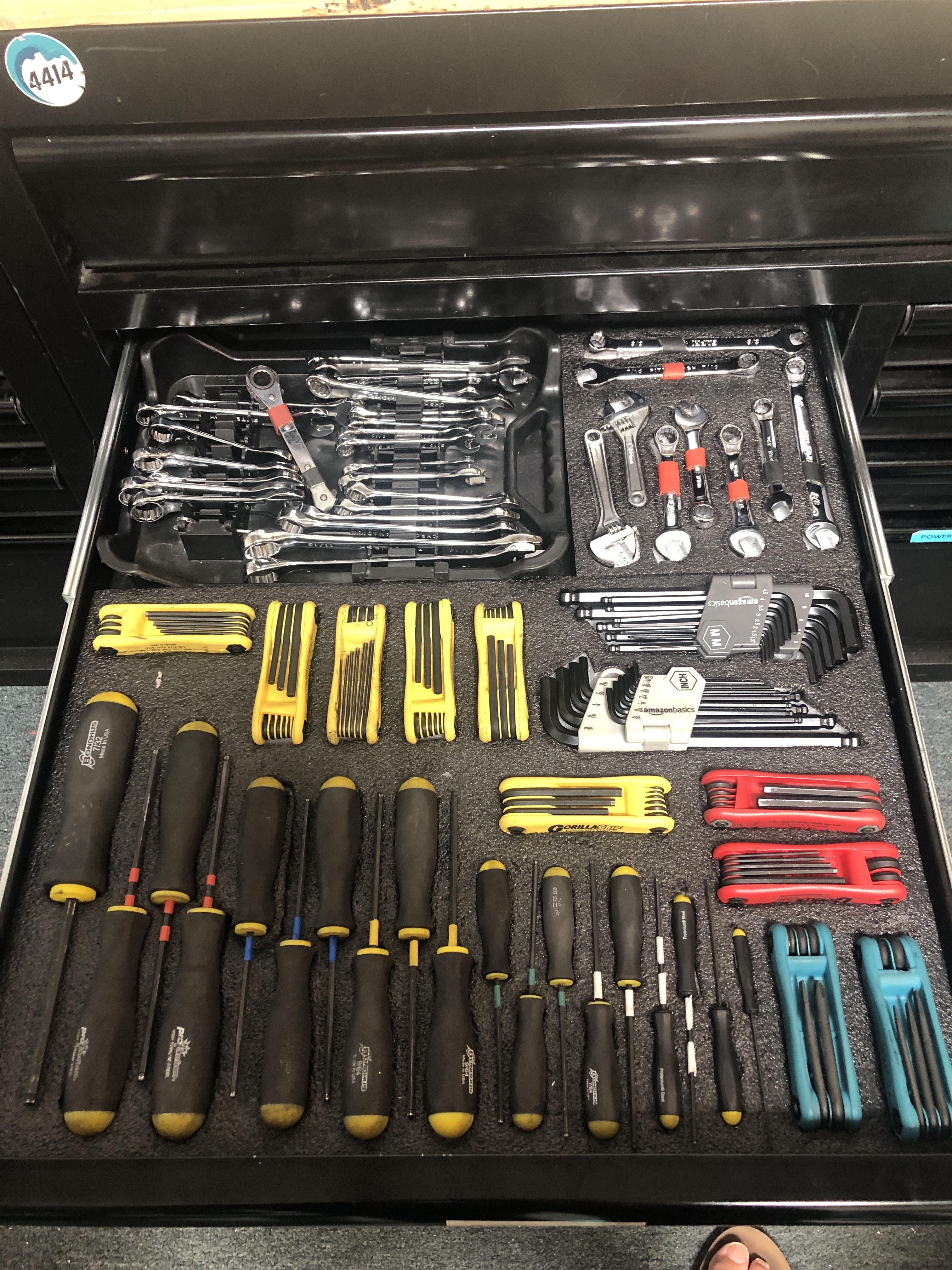

  • Drop the HF T-handle set (they last maybe a year tops at work), get the Bondhus T-handles, and the ball end screwdrivers, and the foldy ones, and the stubby L wrenches, and the…
    Easy way to pad out the list here is just a bunch of Bondhus stuff lol. They’re right in the value sweet spot for anything with a hex drive (and some Torx). Put a set by every machine that uses them, have 2 sets in the pits, etc. Massive qol improvement.

If you run out of stuff to add, start “plussing” things where it matters. Upgrade to the name brand/recognized best value brand. Tekton, Knipex for some things, Engineer, Mitutoyo for some things, etc. It’s hard to make a call on those sometimes, but you learn by experience when you start working for the tool, instead of the tool working for you.
Just did our wrench drawer with this stuff, love it. The fast cap brand linked is significantly easier to carve than any other cheaper alternative I have used before. Now onto the rest of the toolbox…

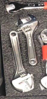

If you find your teams uses adjustable nut rounders with any frequency, pick up Knipex Plierswrenches instead. They are pricey, but it’s amazing how much time and effort they can save in a tight spot, especially with already partially-rounded heads.
(yes, I know there are some very specific things plierswrenches cannot do that the aforementioned crimes against hand tools can, but for anything involving nuts, and gripping material without marring it, plierswrench is the way to go)
+1 on never using these. We honestly just have them on hand for when all the popular sizes are in use. More alternatives in the pliers drawer but your REALLY don’t wanna see a photo of that right now.
