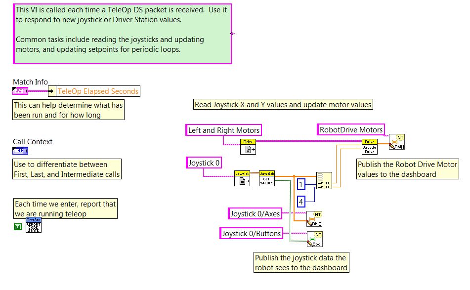

Thank you for your help! We switched the PWM plugs around so the black and red wires are lined up properly. We restarted everything, but it still isn’t responding to the joystick control. Here’s a screen shot of our labview.

In the Teleop code, there is an array. On the output of the array (right side) this goes to the Arcade Drive block (which is correct). On the input to the array (left side) you need to put in the axis number for the controller (ex. “4” and “5”). This tells the code what axis will control the Forward/Reverse, and what axis will control the Left/Right.
EDIT: Added picture as an example. See blue numbers.

We changed the axis numbers to 1 and 4 and fired it up and it works!
