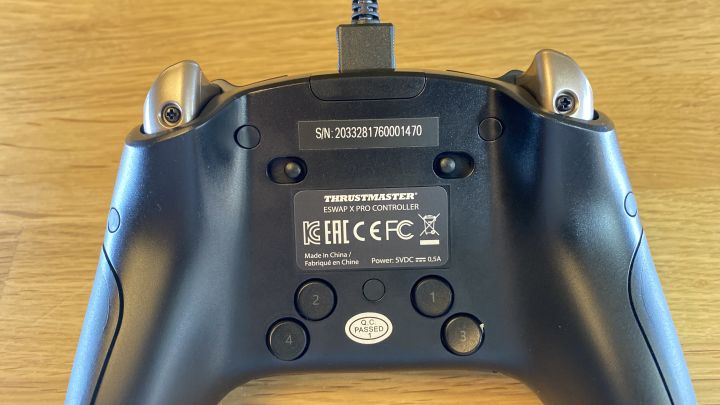

Hi. I’m with team 6453 and we need help with coding the triggers in Labview. We use thrust master controllers and we need to hit one to spin a motor clockwise and hit the other trigger to spin the same motor counterclockwise. we are using tank drive. A picture or screenshot would be awesome.
Triggers, as in the Left and Right Bottom Pulls used by index/Middle Fingers?
Like the two on the pic here?
Both triggers return values of 0.0 to 1.0
So invert one of the triggers to get 0.0 to -1.0 values
Trigger Motor Control
thanks to everyone who commented. We where able to figure out our problem.
