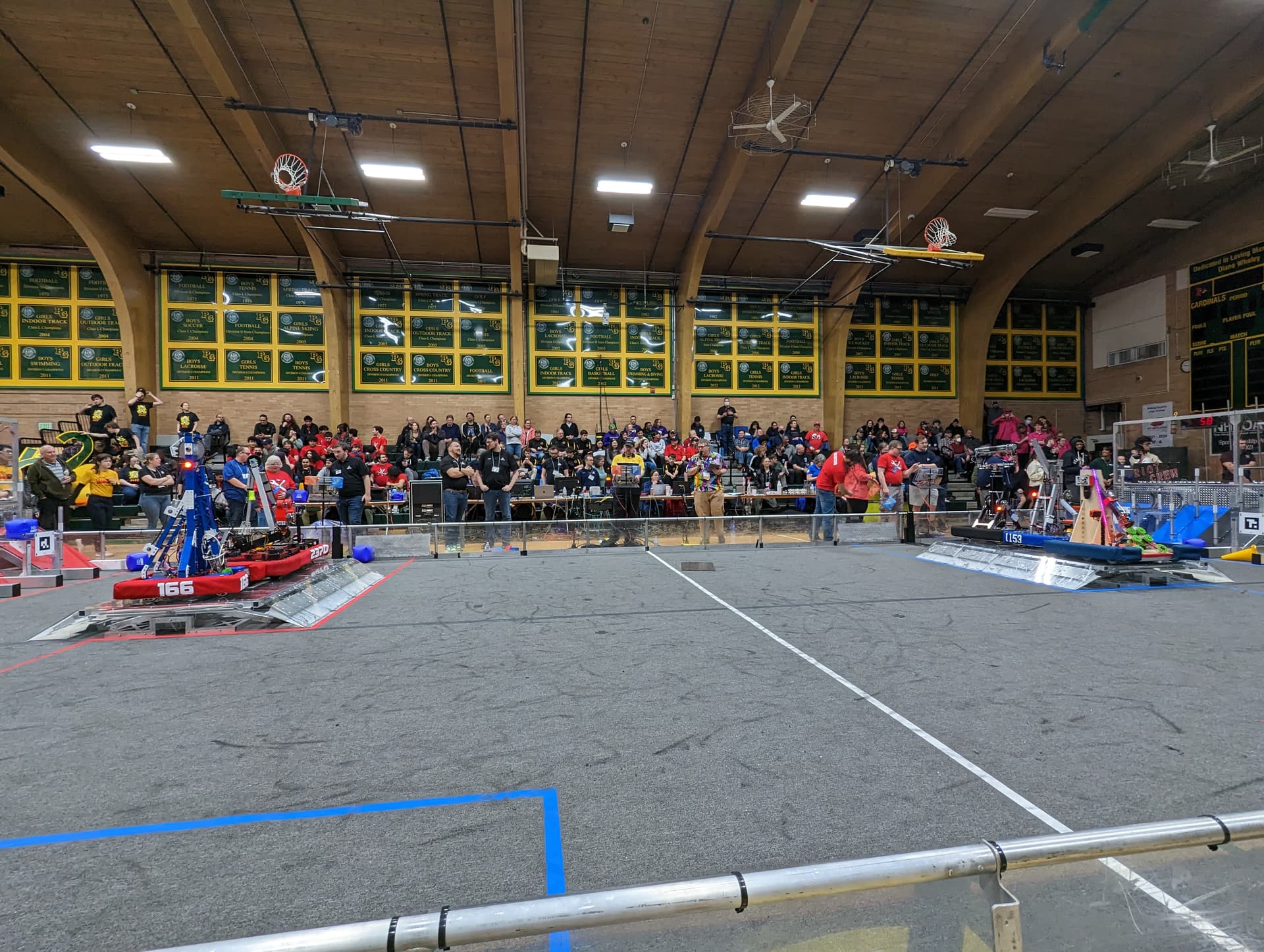

The charge station is going to tip over so many teams this season, in such a bad spot too. Teams need to be really careful driving around it.

Robots getting beached on the sides of the charging station are a feature, not a bug.

Coordinating balance prior to the match is of the utmost importance. I saw many teams approach the charging stations from both sides, one robot gets on, one robot is blocked off, time expires.
