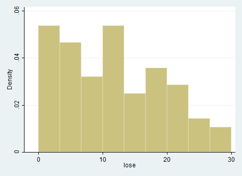

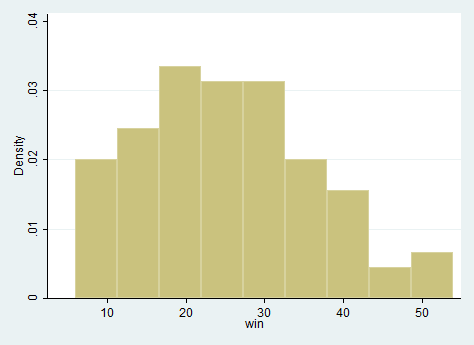

Attached are two histograms of winning (and tying) and losing (and tying) alliance scores in qualifying rounds at the Granite State Regional in 2012. Interesting distribution shapes… winning scores are essentially normal, but losing scores are very positive skewed. 84 matches were played, the mean winning score was 25.4 points, mean losing score was 11.8 points. Standard deviation of winning scores was 11.2, standard deviation of losing scores was 8. Max winning score was 52, max losing score was 30.
