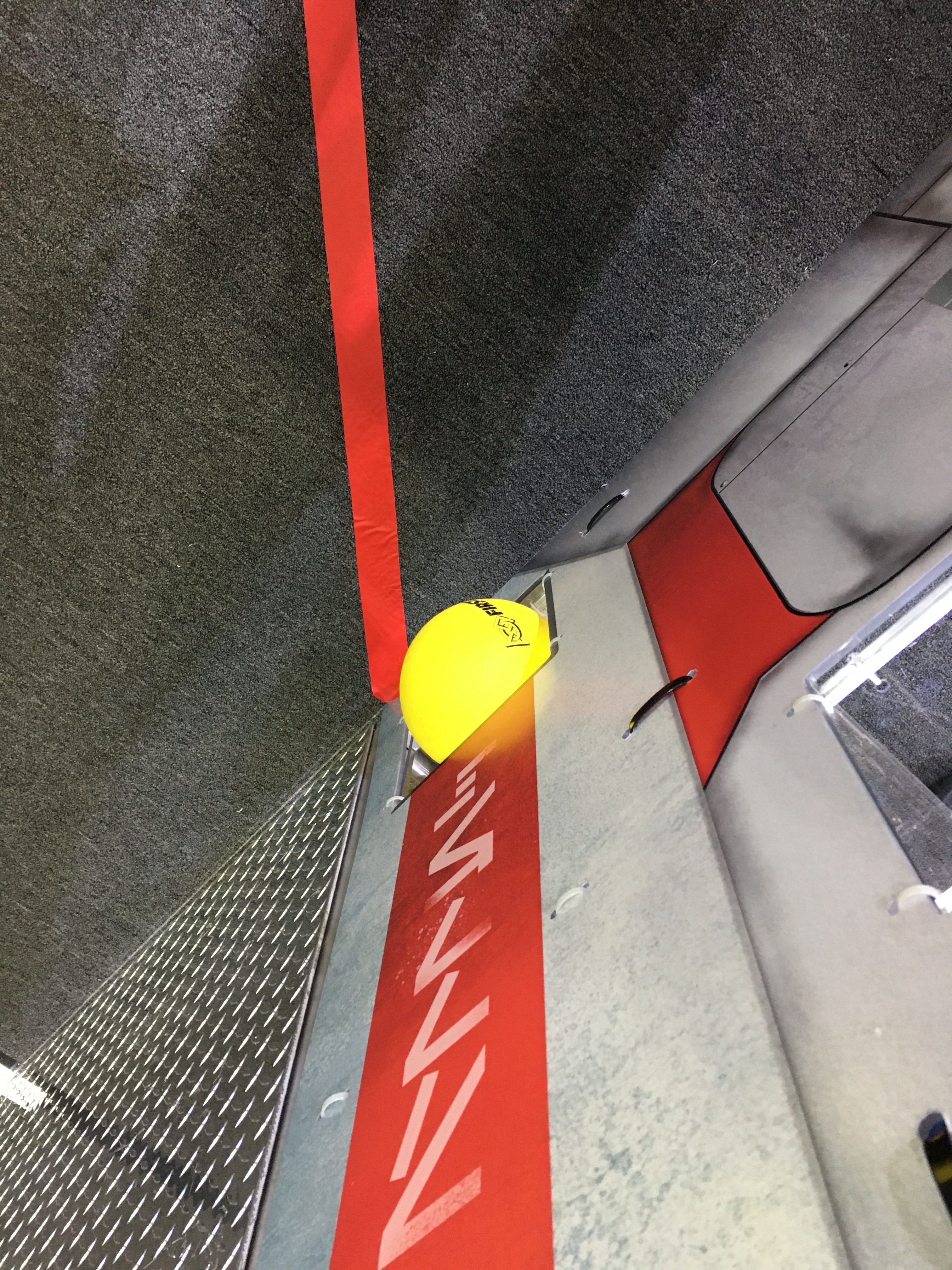

Failure state of Human Player Station
If the balls roll too slow down the lower ports, they may stop before exiting completely. There was no way to fix this from what I could see besides putting another ball in. StuyPulse’s human player had some way of shooting the balls out, but I’m not quite sure how.

Was this on the robot? Was it in a fixed position or was it articulated to “dig the ball out”? I doubt that the human player would be allowed to stick something in the chute.
I noticed a lot of the same thing. Throughout the event, I only saw one time where teams were actually able to utilize the control panel. Many of the robots were not able to get to that level of power cells to use their contraptions that made for that. I does kinda make sense though that because it was the 1st week, it makes sense that not many were able to do it, just because it was early or things weren’t completed, but still I expected a little more of that.
I noticed that we had a lot of issues at our first comp, but hopefully we will improve the only issue that I saw that was going to very important to later in the game, is the human load station failure modes.
Hopefully kinks are worked out for other comps
It was the human player. Again, I’m not sure how it happened or got approved, but I saw it while I sat in queue. Holds no weight though since I can’t really verify at this point.
Rule S6 states “DRIVE TEAMS may not extend any body part into the LOADING BAY Chute”. While there is nothing about objects other than body parts in the Chute, it is unlikely that putting something other than a body part would be allowed. It is most likely that the Referees did not notice this being done.
Makes sense. Hopefully they revise the loading station somehow.
Were they just touching the hanging robot or were they “supporting” the hanging robot? Q&A has ruled that supporting this year is actually bearing weight so if they were just “touching” this was an error of the referees part
Yeah - I noticed that happening a couple times yesterday in matches. Human player stuffed about three balls in and then gave them a shove to clear it
talk to the FTA, the lexan ramp should exit above the hole in the player station wall. Ours dropped behind it and was fixed as soon as it was brought up. It just took a few zip ties and some muscle to move the ramp back into the hole again.
