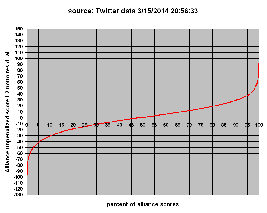

***Alliance Score Residuals
based on Twitter Qual match data as of Sat 15 Mar 2014 20:56:33 ET.**
*Example graph interpretation:
81 - 18 = 62% of Alliance Unpenalized Scores were within +/- 20 points of the “OPR” predicted value.
66 - 32 = 35% of Alliance Unpenalized Scores were within +/- 10 points of the “OPR” predicted value.*
The usual Twitter data caveats apply.
